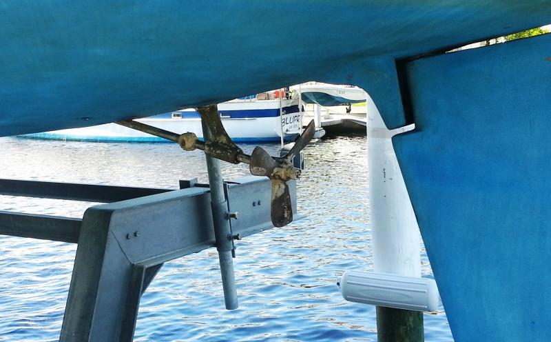

I'm still a newbie. Bought my first sailboat in April 2014. My new to me boat came with a Campbell Sailor Propeller. http://www.westbynorth.com/CampbellSailer.aspx
The previous owner talked like it was a really good prop. I know nothing about props. Since buying the boat and sailing it, I have wondered if it is a good prop or not? My 30' sailboat only has a Universal 14 HP (2 cylinder) diesel engine. She cruises under power at 3/4 throttle at about 4-5 knots depending on current.

Give a look to the zinc if that is a current photo. :)

That looks like a very inefficient prop, but also low drag, which is probably the idea. I'm not too sure why you are so concerned with keeping up with other boats when you are under power, but the prop is only one factor involved.

You have a very nice prop. Low drag and efficient motoring. If I could afford it, I would chose the same one.
