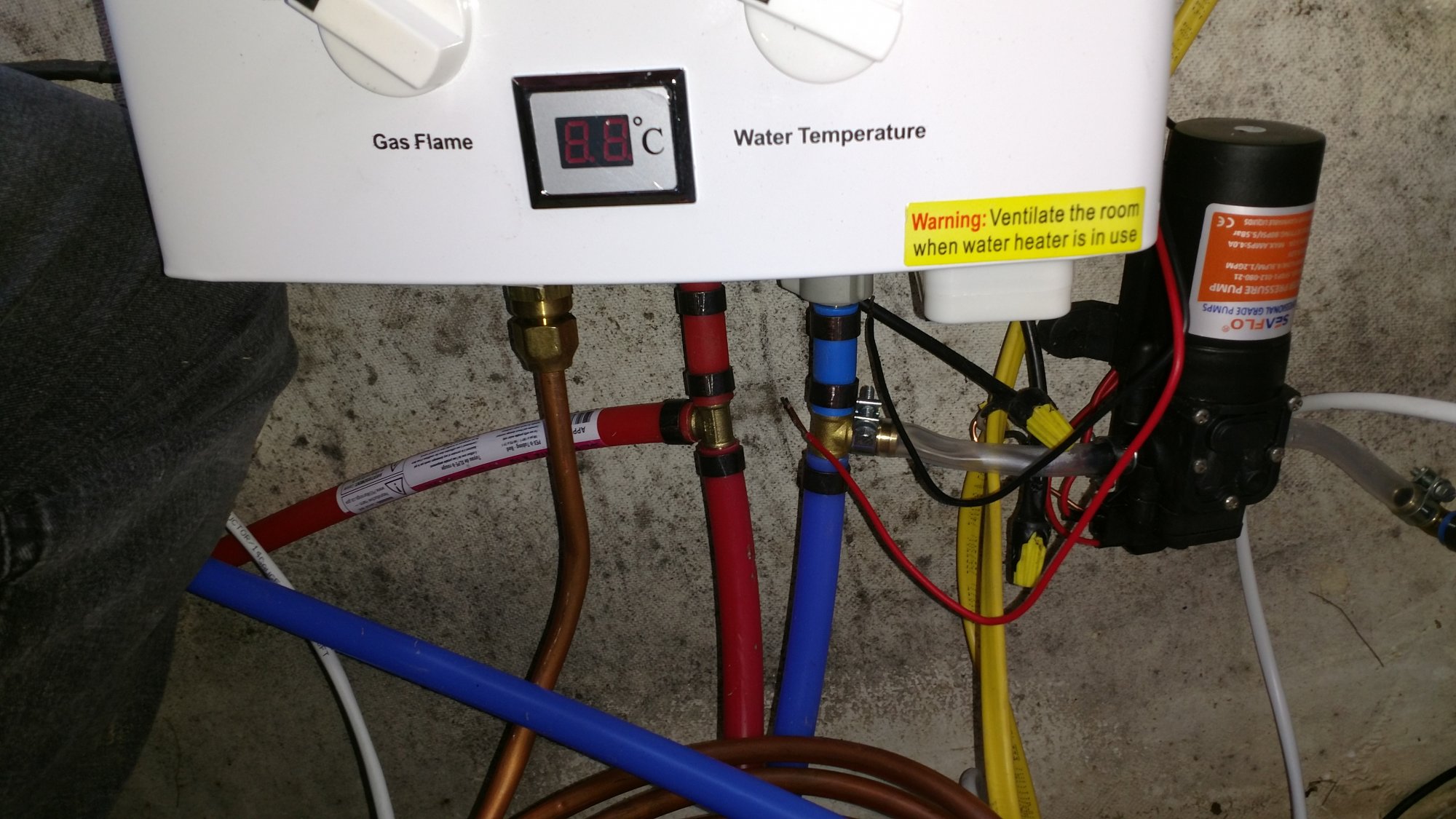

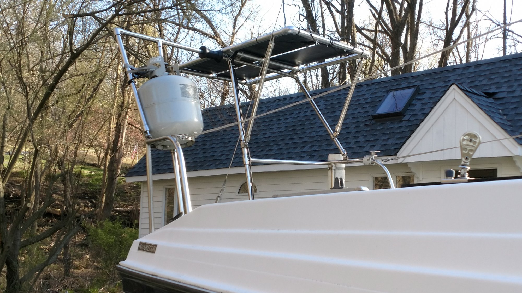

Hi gang,

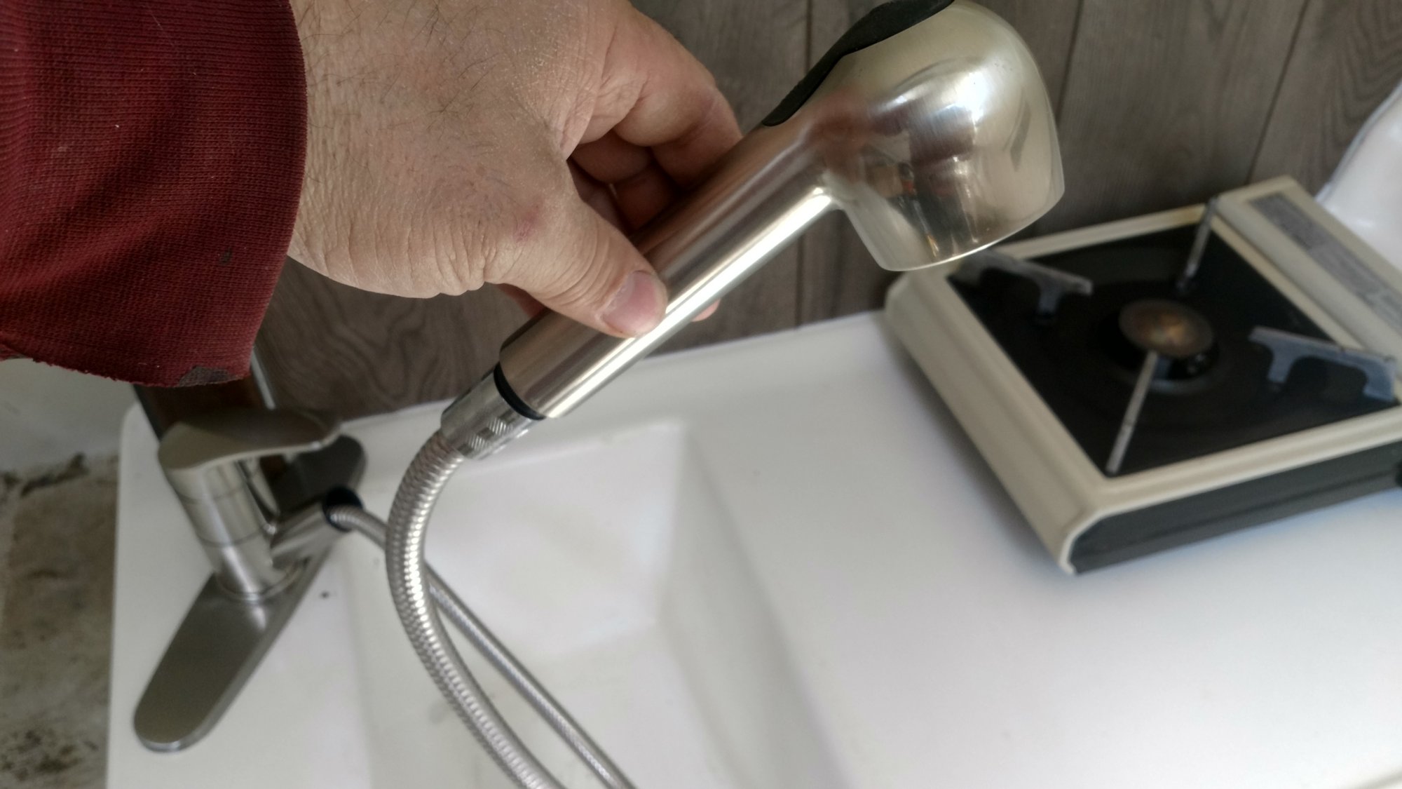

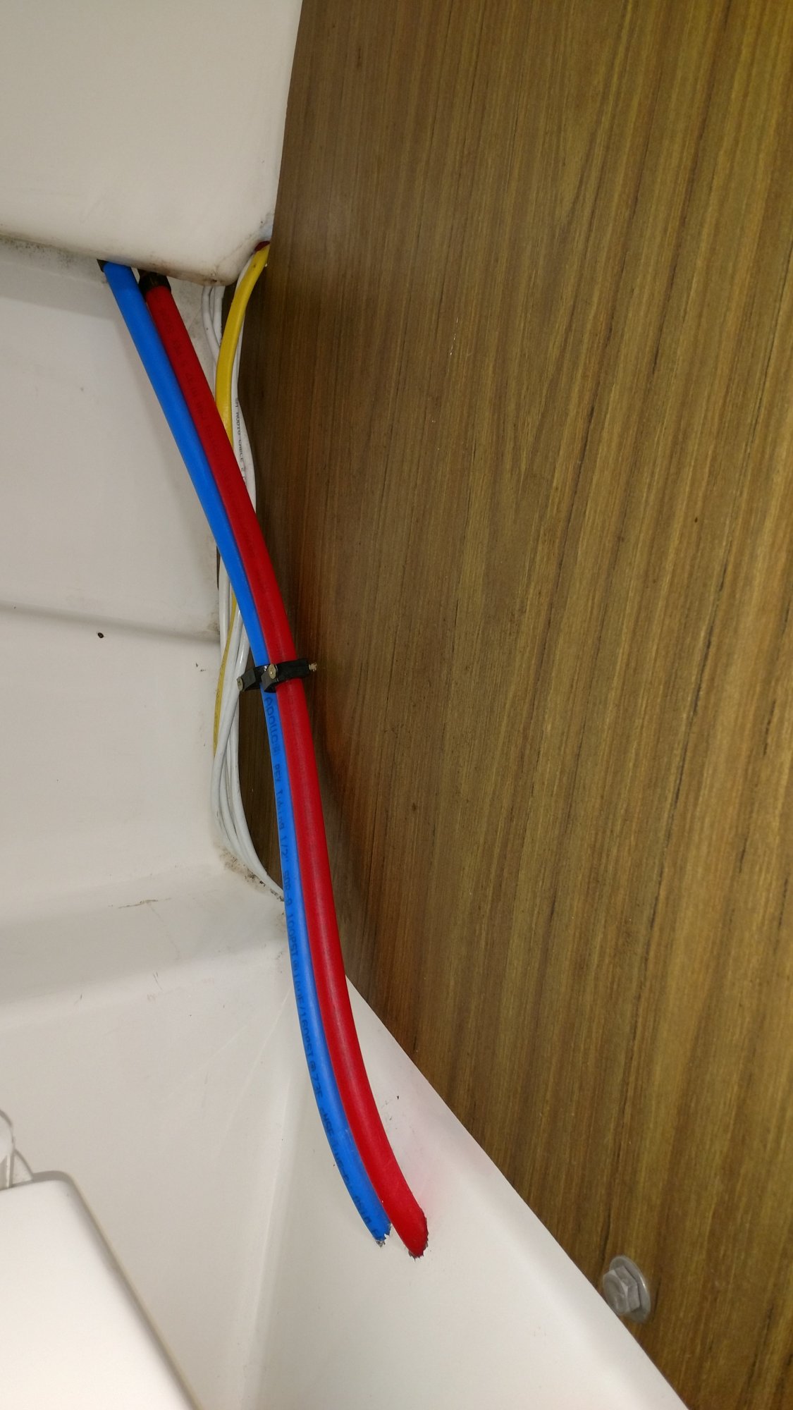

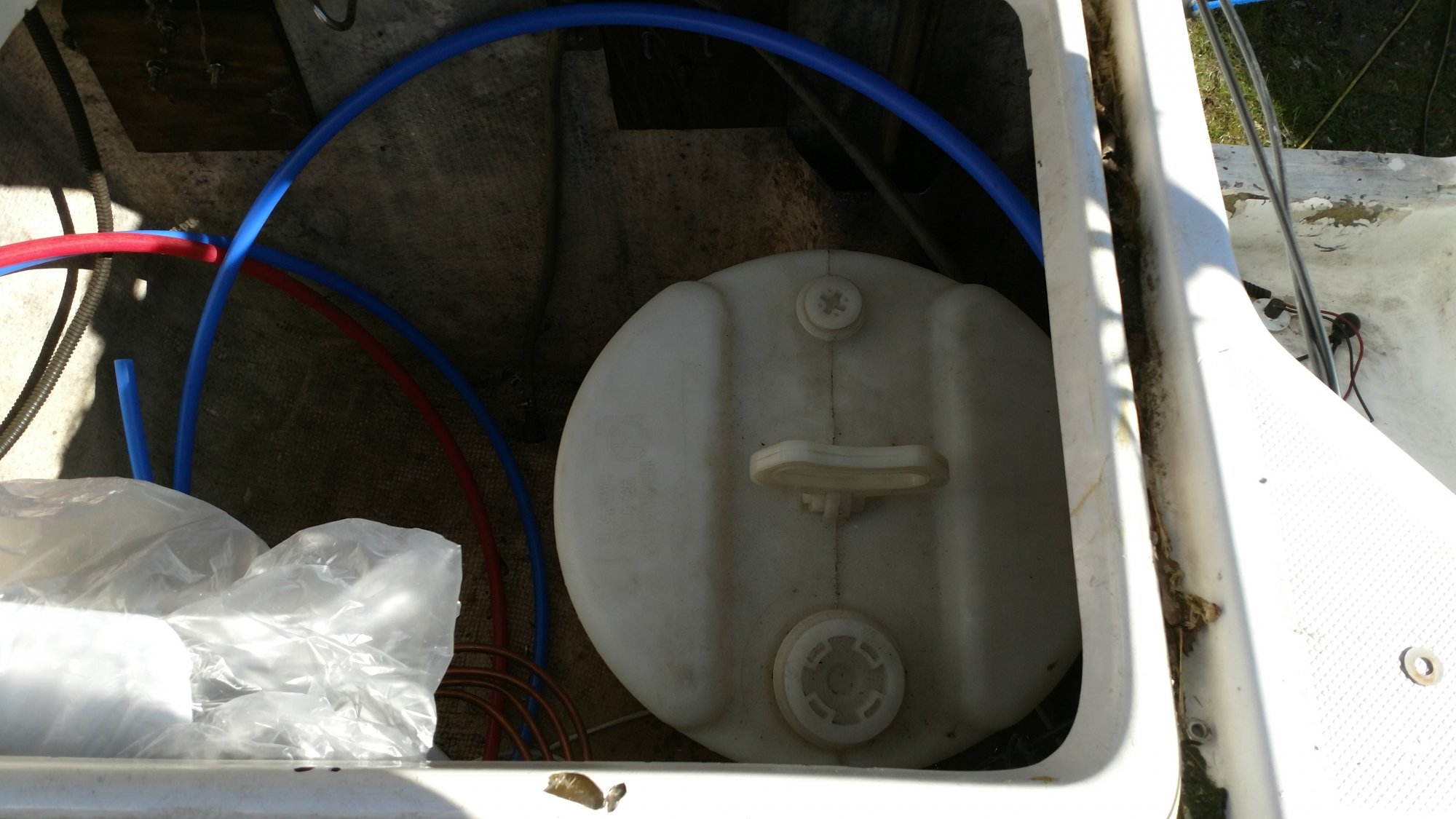

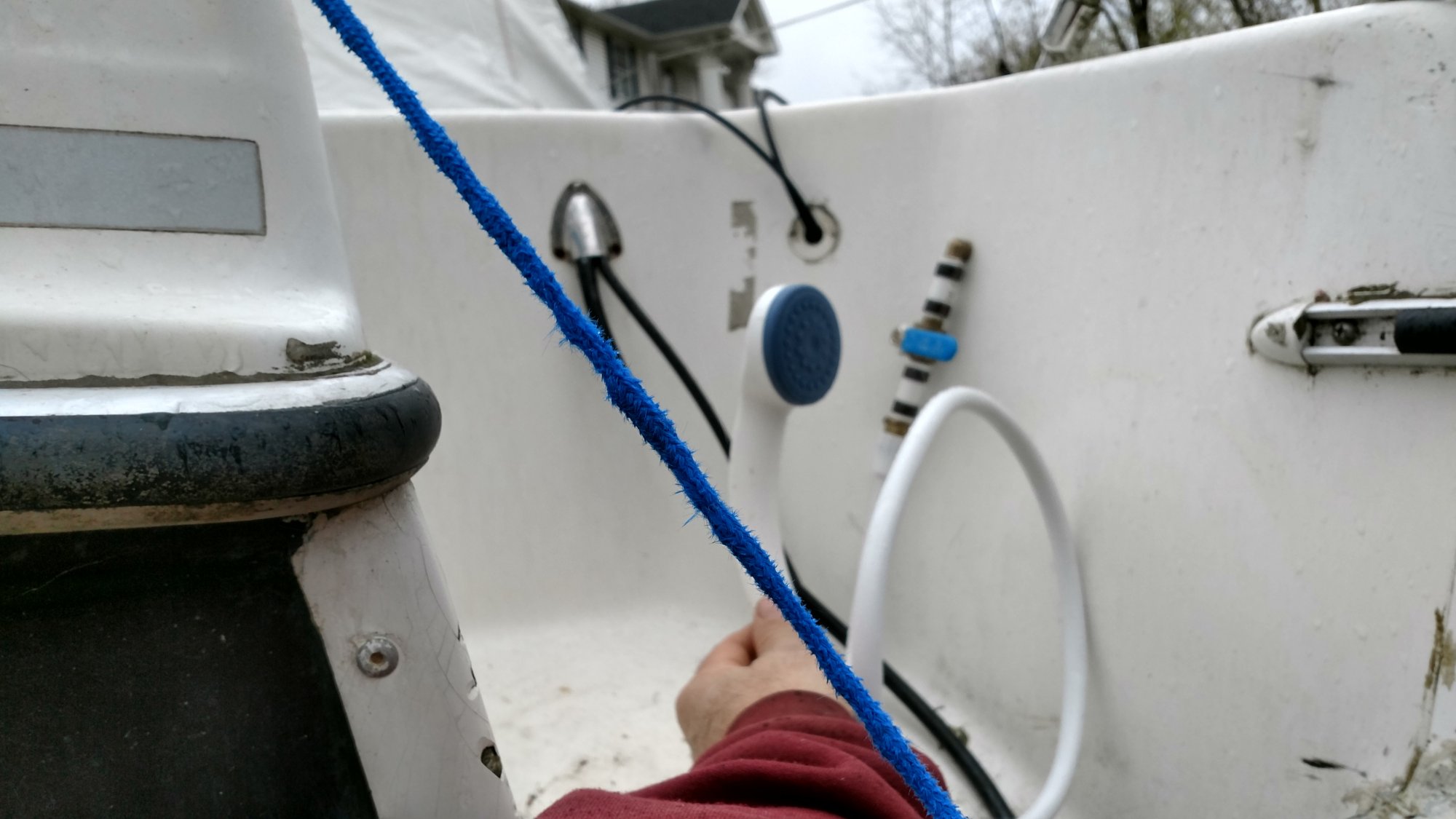

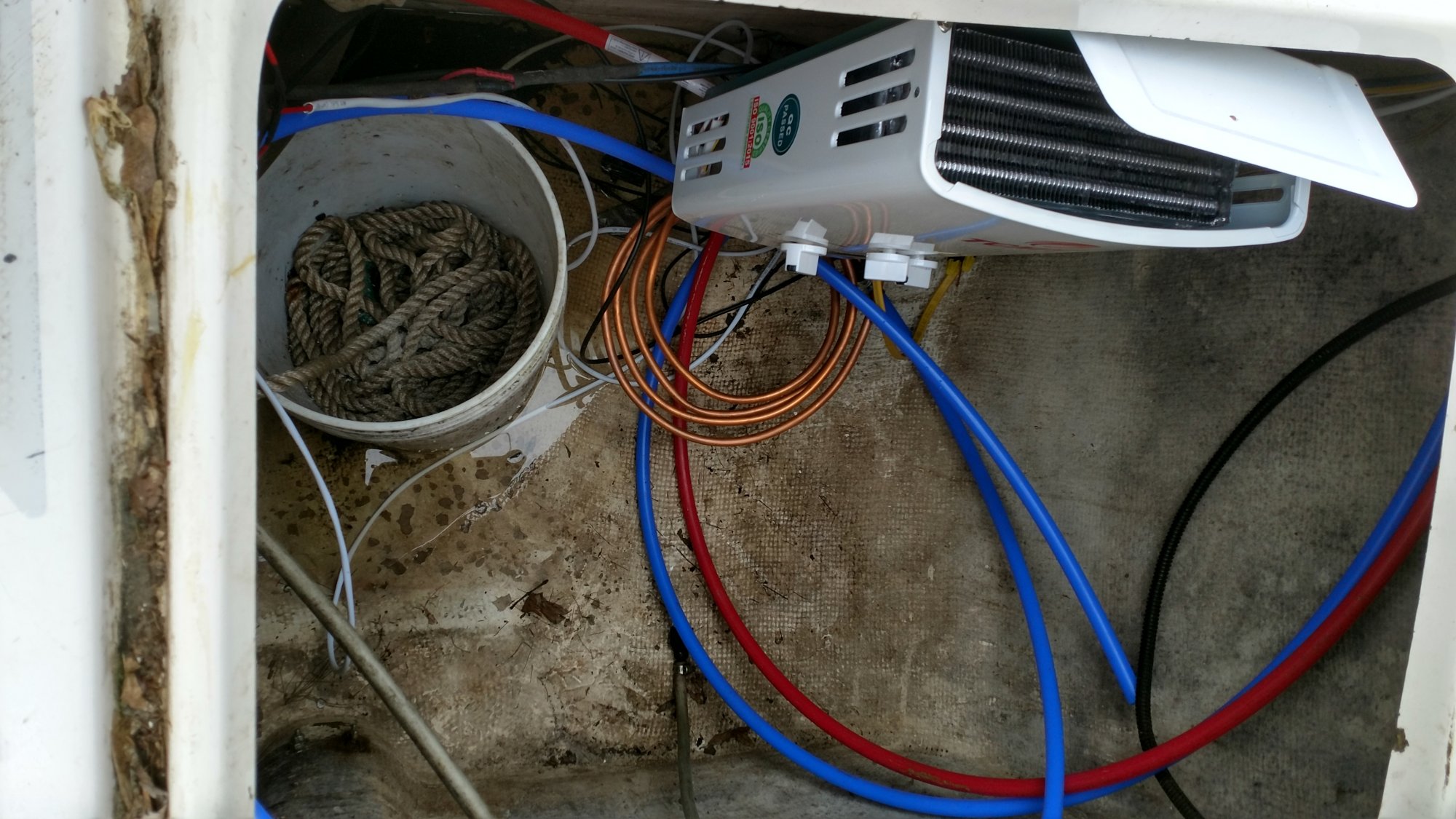

Wanting hot and cold running water on my 26S for our week-long excursions, I mounted a small tankless propane water heater from eBay (around $58) in the lazerette with a 15-gallon water tank, I might have room to add another 15 gallon tank for a total of thirty. I ran new hot and cold pex pipe to the kitchen sink and added a new faucet, I also added a hand held shower to the motor well. My main question is what do you think of mounting the propane tank on the stern rail so that it is out of the way? Would the added weight create any problems? not that I'm concerned with adding to the tenderness as I don't plan to be out sailing in heavy winds. Any idea if there would be any rule or law issues about a tank on it?
**As far as venting the WH, I just planed on opening the laz hatch when needing to use it. I don't see the need for putting a chimney through the laz hatch as of yet.

I'm no expert, but this doesn't seem like a good idea. Is the laz completely isolated from the cabin? @Maine Sail can probably weigh in far better than me, including discussion of ABYC standards. Good luck!

the weight should not be an issue for your trim. since you dont have a propane locker, the rail is really your only choice. you have some ABYC code issues. I dont think the tankless water heater is approved for marine use. make sure your connection to the rubber hose to the tank occurs outside the cabin close to the tank. are you coing to use a remote shutoff valve at the tank? Remember there is a saying that 'codes are written in blood'
Not yet, but I plan on foaming closed the openings at the top where I fished my wires and pipes.
Yes, the tank valve would be the remote/emergency shut off. I planned on using copper right to the tank regulator but put it through a rubber hose to isolate it from the rail. I'm sure the WH isn't CG approved.

the exhaust is directly under fiberglass which is flammable. looks dangerous to me.

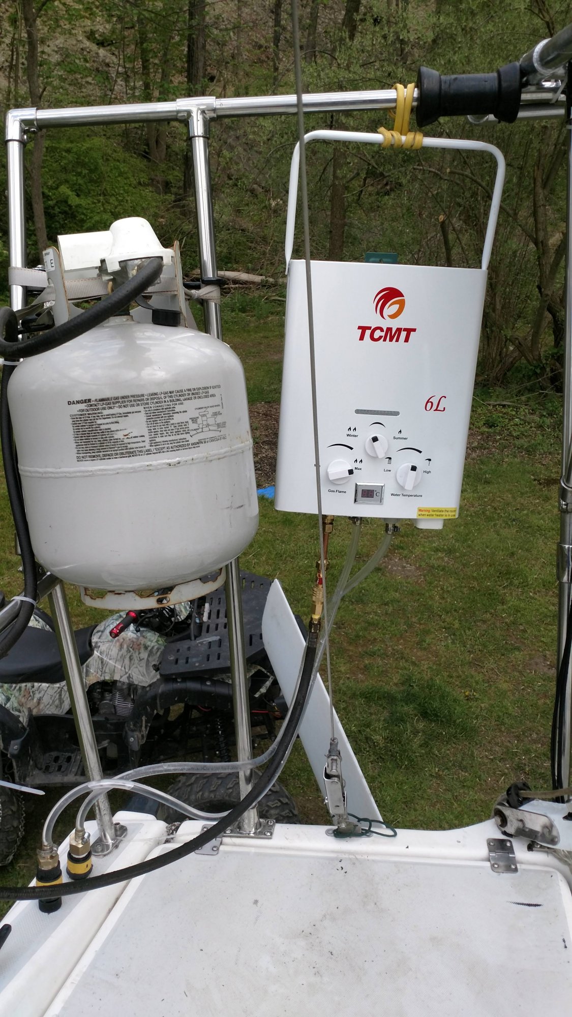

Propane is heavier than air meaning any leaks will put propane in the lowest part of your boat, so the bottom of your lazarette and maybe the bilge. One spark and... Then there's the carbon monoxide issue, the heater is not vented properly - sitting in a hole with the top open is not a venting solution. If you insist on using this setup, I would make it portable so you can hang the tank and the heater outside on the stern rail while in use and then disconnect the propane tank and leave it outside when not in use.

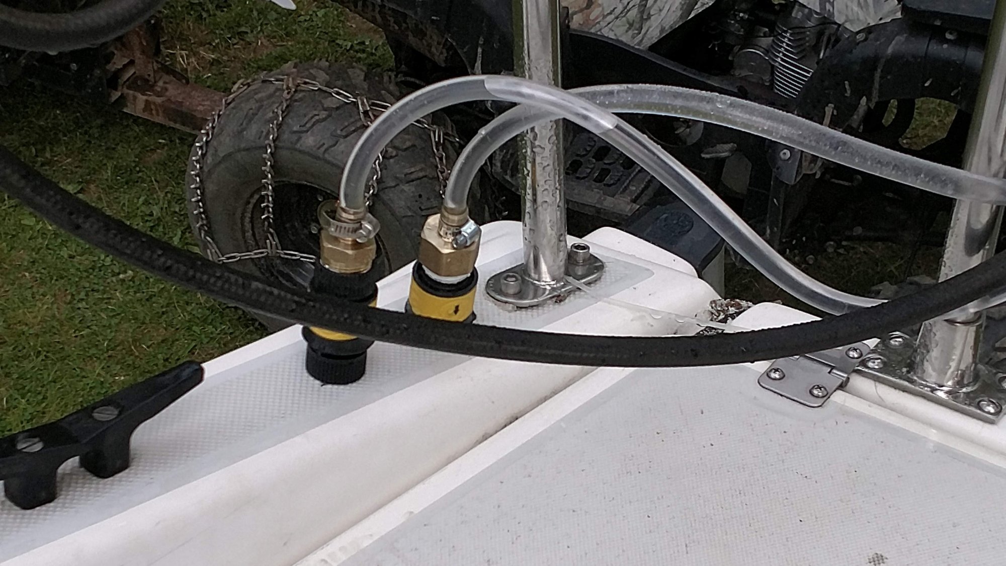

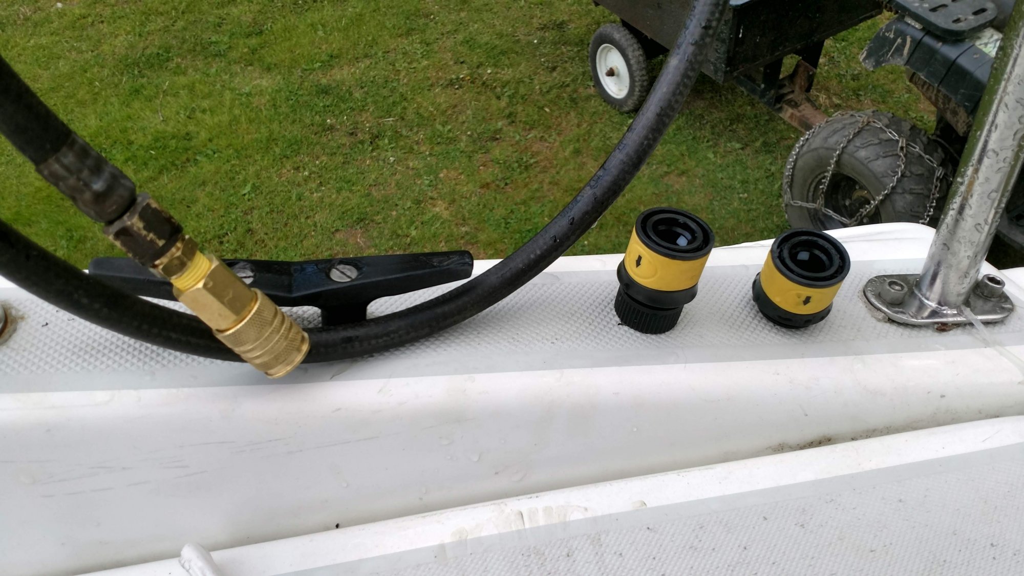

Dmax, I didn't think of temporary set up like with quick disconnects and using it outside like hung on the rail but that would be easy enough to change out to and would do away with any fume or gas concerns inside. Thanks, I think I'll do that instead and it would make the laz more storage-friendly if a heat source wasn't down there.
Done, it was simple enough to add quick connectors into the mix. This was the better idea for sure because I didn't like the plan of leaving it installed permanently all winter. You can set it up and take down in thirty seconds so it couldn't be any easier and now with zero worries of leaking gas getting down into the boat or any CO issues. I'll use carabiners to attach it to the rail, the romex was handy to try it out :) Thanks again for the idea!

Looking good - hot water is the difference between camping and glamping.
