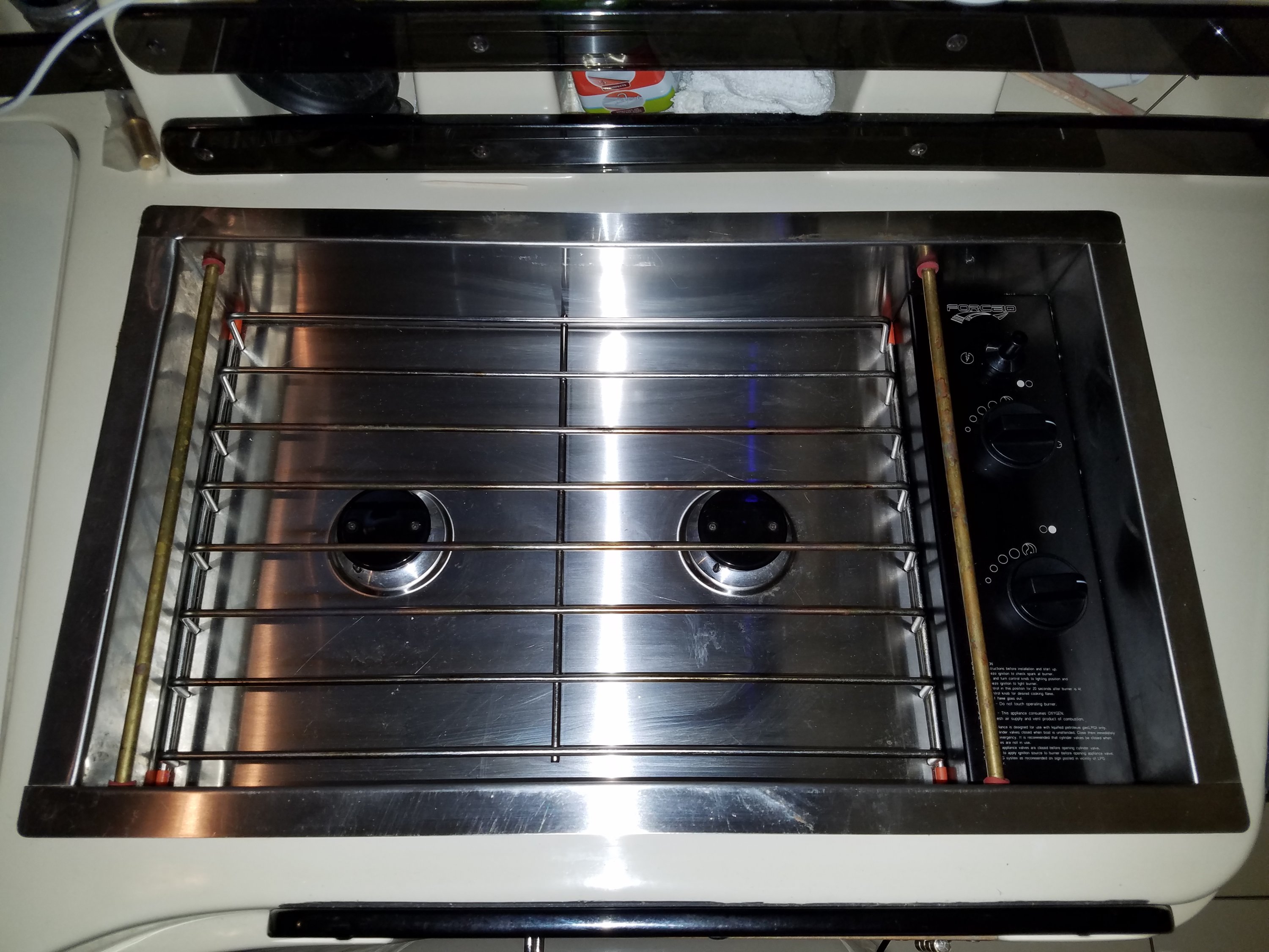

The PO upgraded the stove to a Force propane unit, which is nice. It came with a 10ft gas hose, regulator, gauge and connectors, which is also nice. What I didn't like was that the hose was just coiled up inside the cabinet under the stove, with one pound propane canisters connected. Looked like a project unfinished and a safety hazard. The propane tanks should be outside.

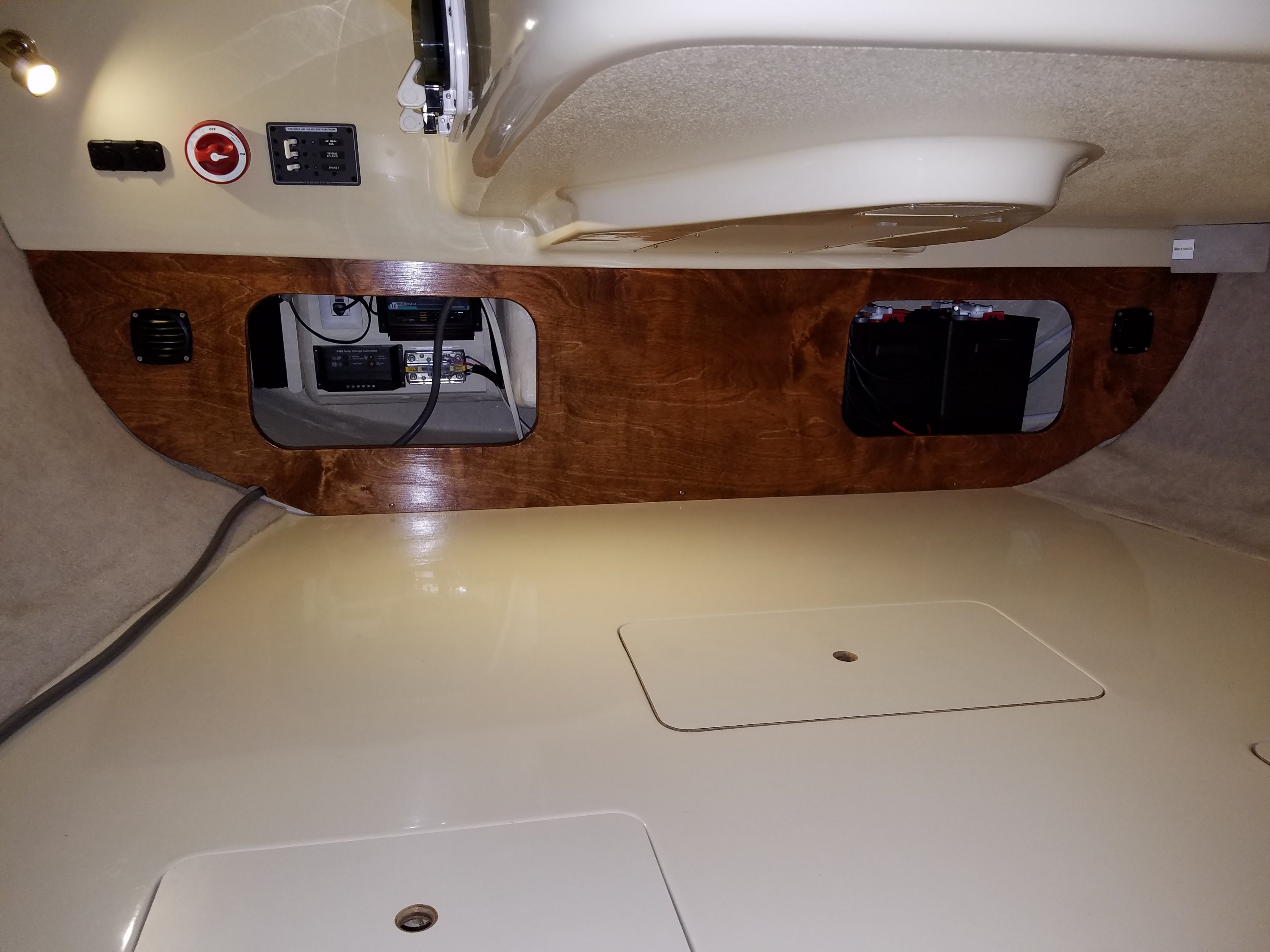

I had to run the hose on top of the aft berth floor, it would be too difficult, if not impossible to run it under the floor. It was a challenge just to get wiring under there.

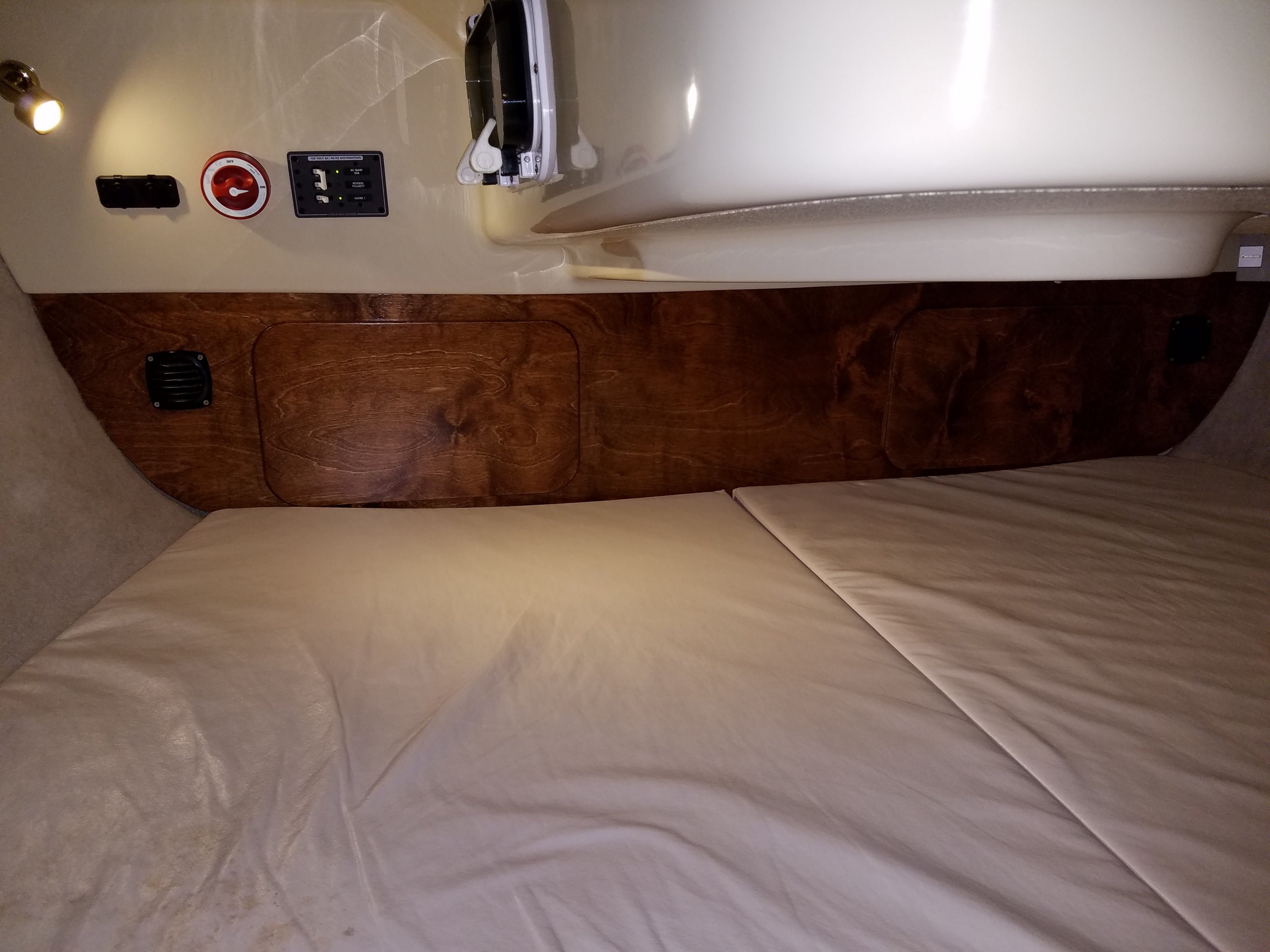

The aft berth cushion covers it nicely though.

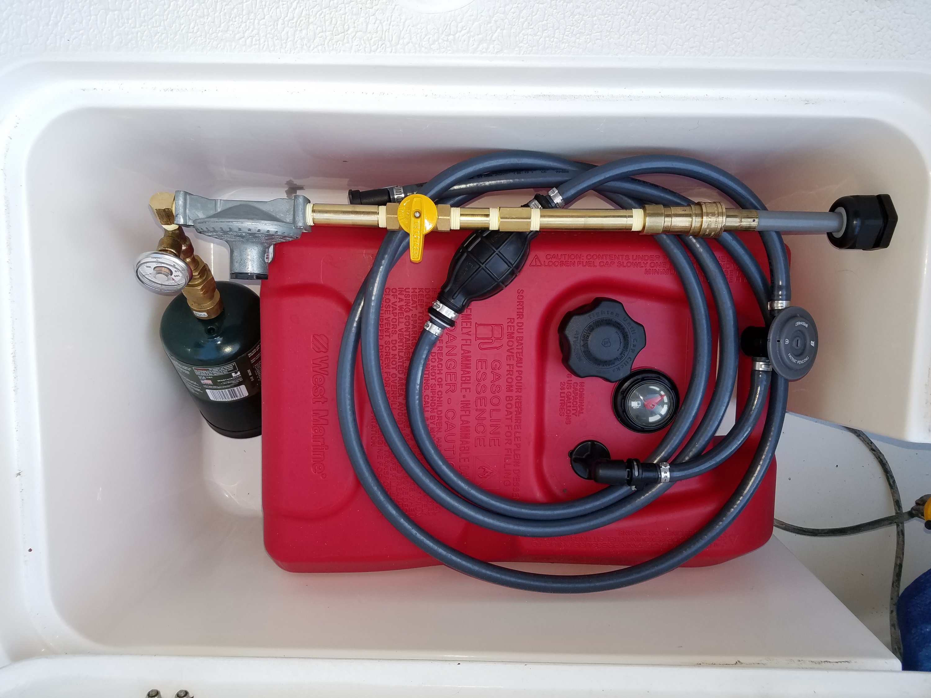

The gas hose is run into the gas compartment. I used a Vapor-Tight Straight-Thru fitting.
There is a quick disconnect fitting allowing the disconnection from the hose for stowage if desired. I added a gas shutoff valve for addition safety. If there is a leak, the gas will spill out the stern motor well. There's enough room to store a couple extra canisters too.

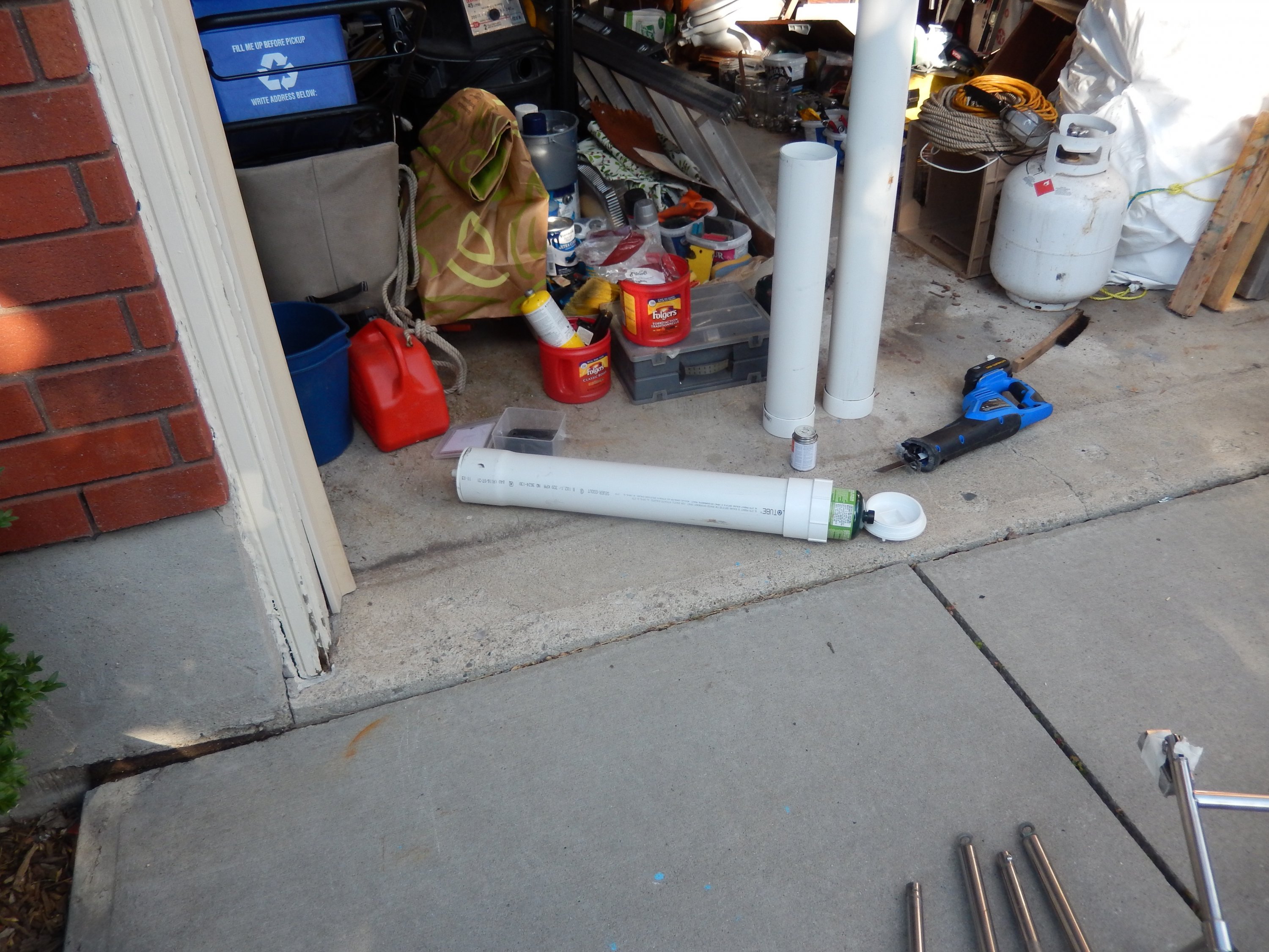

If you use the small propane cylinders such as those made by Coleman then here is a simple propane locker you can make for less than $20.00. This locker will store 3 partially full, full or empty propane cylinders. You need 1 30" to 32" length of 4" white PVC tubing (4" id), 1-4" x 1 1/2" fitting with 3/4" hose connection, 18" of 3/4" id tubing, 1- SS screw clamp for tubing, 1 - 4" socket x 4" threaded fitting, 1 - 4" threaded plug, 1 - PVC solvent cement, long nylon quick ties or long SS screw clamps. For this application primer for the PVC should not be required. To mount the completed storage container fasten to a stanchion in the rear cockpit by large nylon ties or multiple screw clamps and hang the tubing over the stern below the gunwale. Having trouble uploading image.

Just a few thoughts. First on the electrical line and I hope everyone uses the correct marine grade, you could pull the carpet away slowly hiding the wire behind and re-gluing the carpet in place preferably on top . In a way the wire would be kept in place and not subject to being pulled even if protected by black plum line just laying under the cushions.

Crazy Dave, I don't know what electrical line you are referring to??? I think keeping the propane tank in the gas locker is ideal. Propane gas settles on the floor, down low and will actually flow out the transom. I have always been told propane should not be stored inside the boat. Reason being if there is a leak it will settle on the floor or in the bilge.

DougJ; I saw in the first photo a black corrugated tube which is probably the split kind which many use to shield wires with running in the rear berth which cushion is on top. That is not a good idea paticuraly if it was shore power or even DC because if it is pulled out or the cover or shielding broken, I have seen boats brought into my dealership for repairs or partially burned. YOu understand I look for safety in installation. There are two ways. Run that line along the hull secured with silicon once the surface has been cleaned thru the small hole for water to drain into the bilge area under the rear berth in the area of the bilge pump and then underneath the rear berth. Behind the galley wall where the carpet meets the bottom next to the galley wall corner, I use to drill a hole there running the line up behind the carpet. I use to pull the carpet out gently and reglued it into place running it up and behind to the electrical pane. As for the hole being drilled, I was very careful going thru so not to hit the hull and there is some clearance. As for the hole itself I used the smallest of the black corrugated plastic pipe (split) which we in the marine industry referred to a split plumb or plume what ever. I hope this helps. It was clean out of sight and secured
