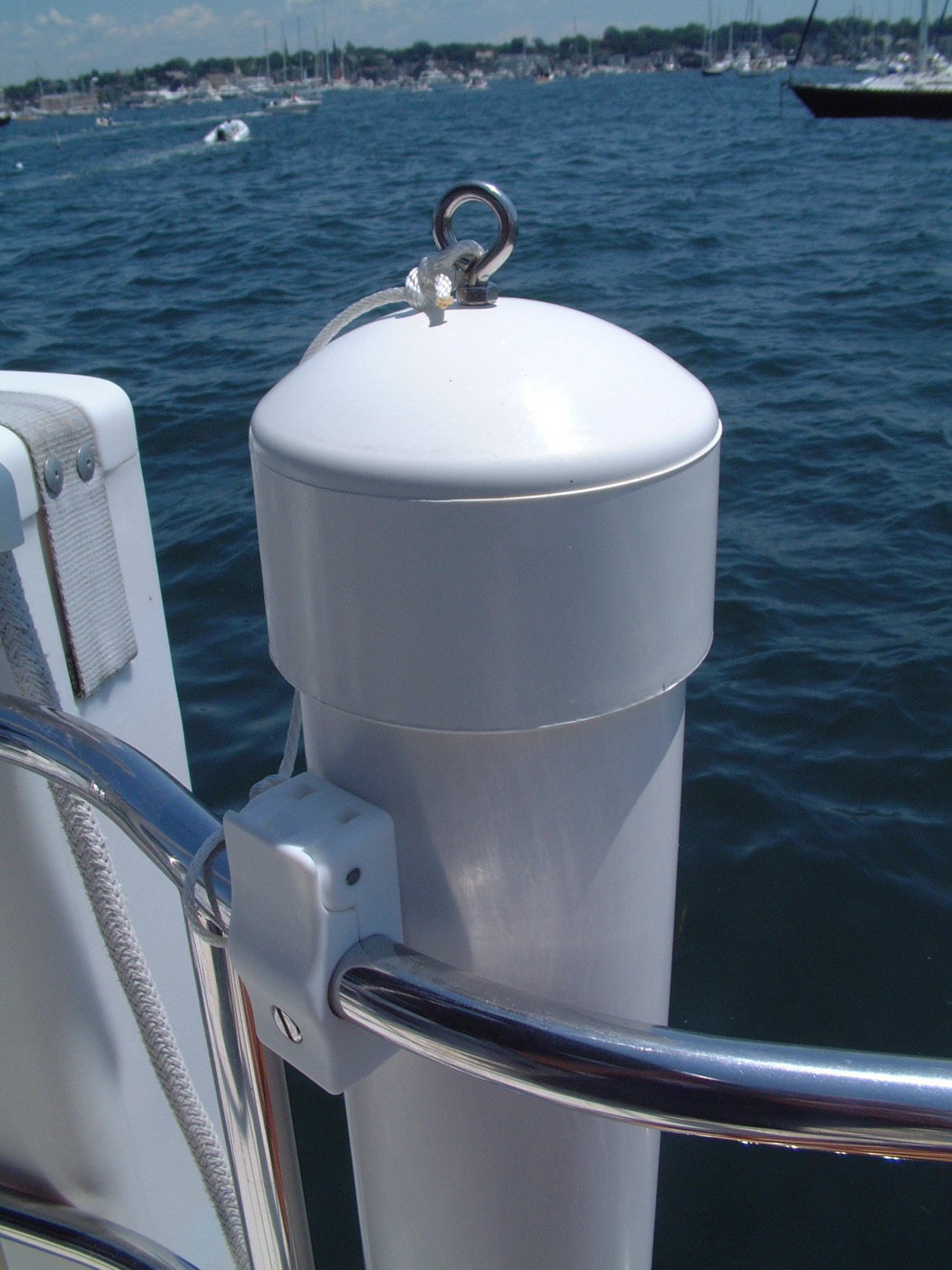

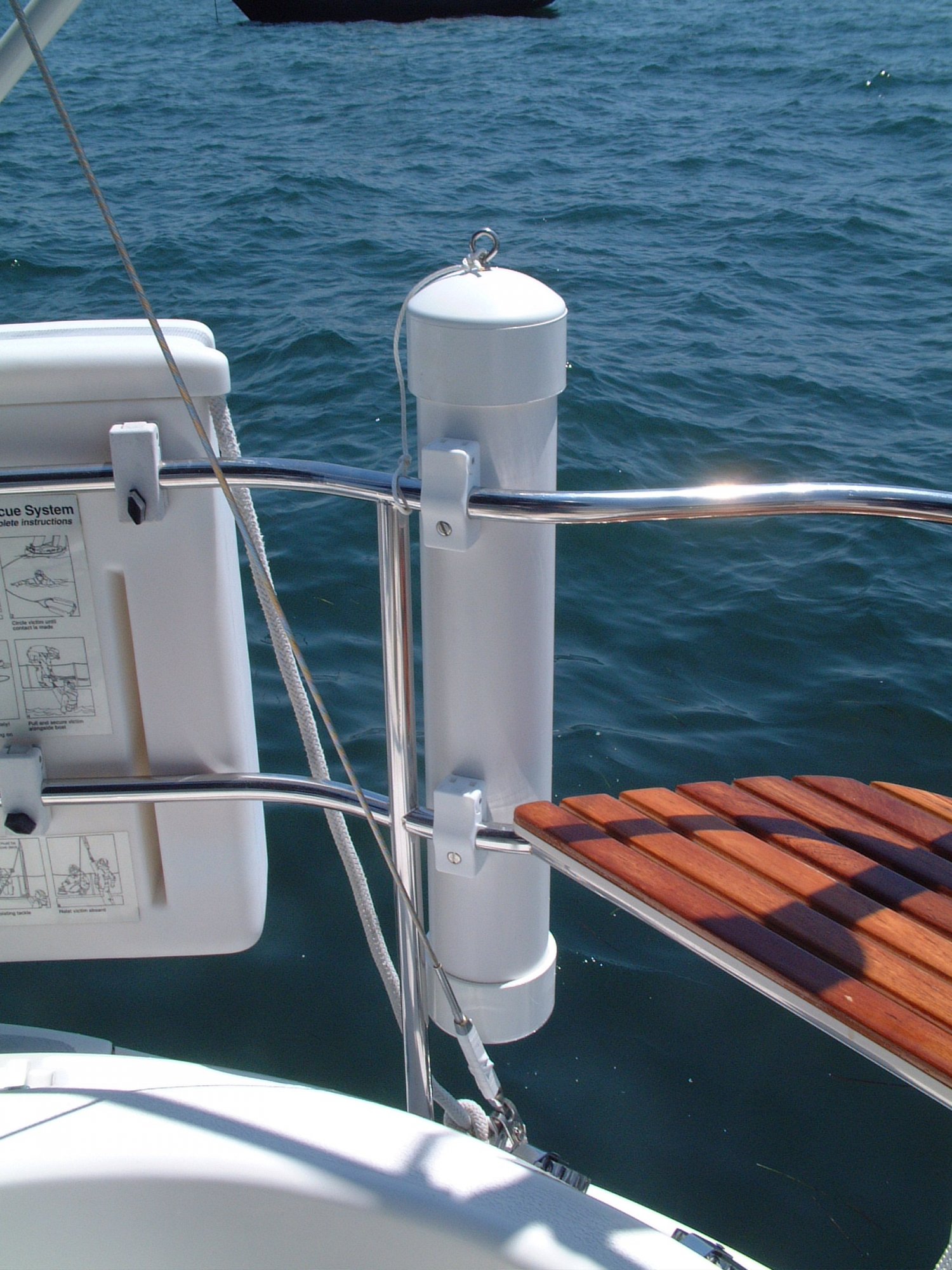

If you are referring to the small (generally green) screw on tanks like for a camp stove here is what I do. I constructed two "propane containers" from Schedule 40 PVC pipe with a glued on cap at the bottom with holes drilled in them for venting. The top has a screw on plug. I can then drop three of the green canisters into the tube and strap to a convenient place topside. Kind of like strapping extra fuel topside in fuel cans that extended cruisers use. I"ll try and get a picture if anyone is interested.
Dan & I use the same system except I use a push-on cap instead of screw-on.

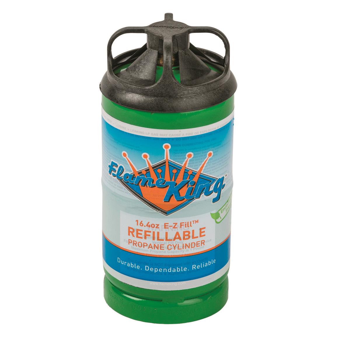

The Flame King tanks are refillable by design. With less than $20 of hardware you can refill safely from a 20# tank for 50 cents.
