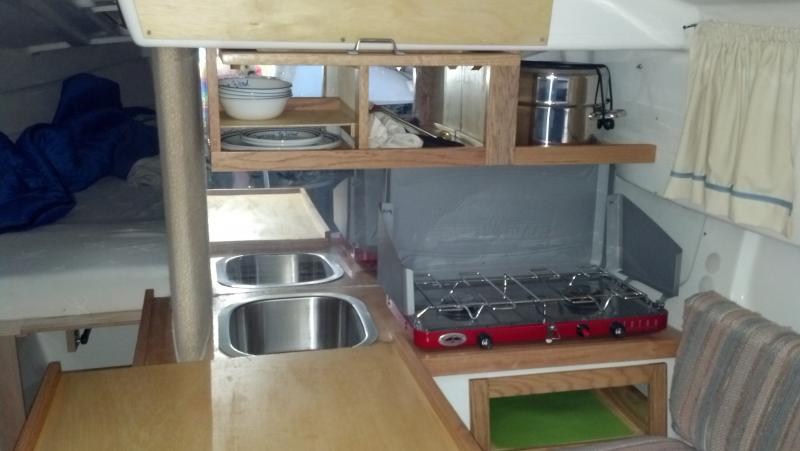

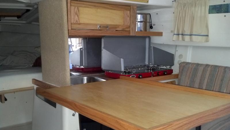

thanks for the input / reassurance, fellas. i ask because of this: in the pics below you can see how tightly my stove fits on my galley counter. (when i designed the galley, i took measurements of the stove... not the stove with a bottle attached). So now, when i connect a 1lb bottle, it sticks out so far from the stove that i have to position the stove over the sink and it basically takes up the whole galley. i want to run a hose through the fiberglass "wall" next to the stove and down to a bottle below the galley counter top. i would like to have a bulk tank, simply for the safety of a shut off valve, under the galley or settee. the hose could be long enough that it is always hooked up and shut off, or shut off before extinguishing the burner so the last little bit is burned off before being disconnected.
any thoughts / opinions are greatly appreciated

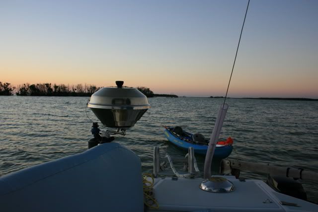

Here are a few pics that hopefully show my bbq mount described above.
The first pic is of it swivelled back under the solar panel. It's completely out of the way there.
And here is it swivelled forward and easily accessible from the cockpit (and far enough away from the Bimini edge).
Another of it parked...
