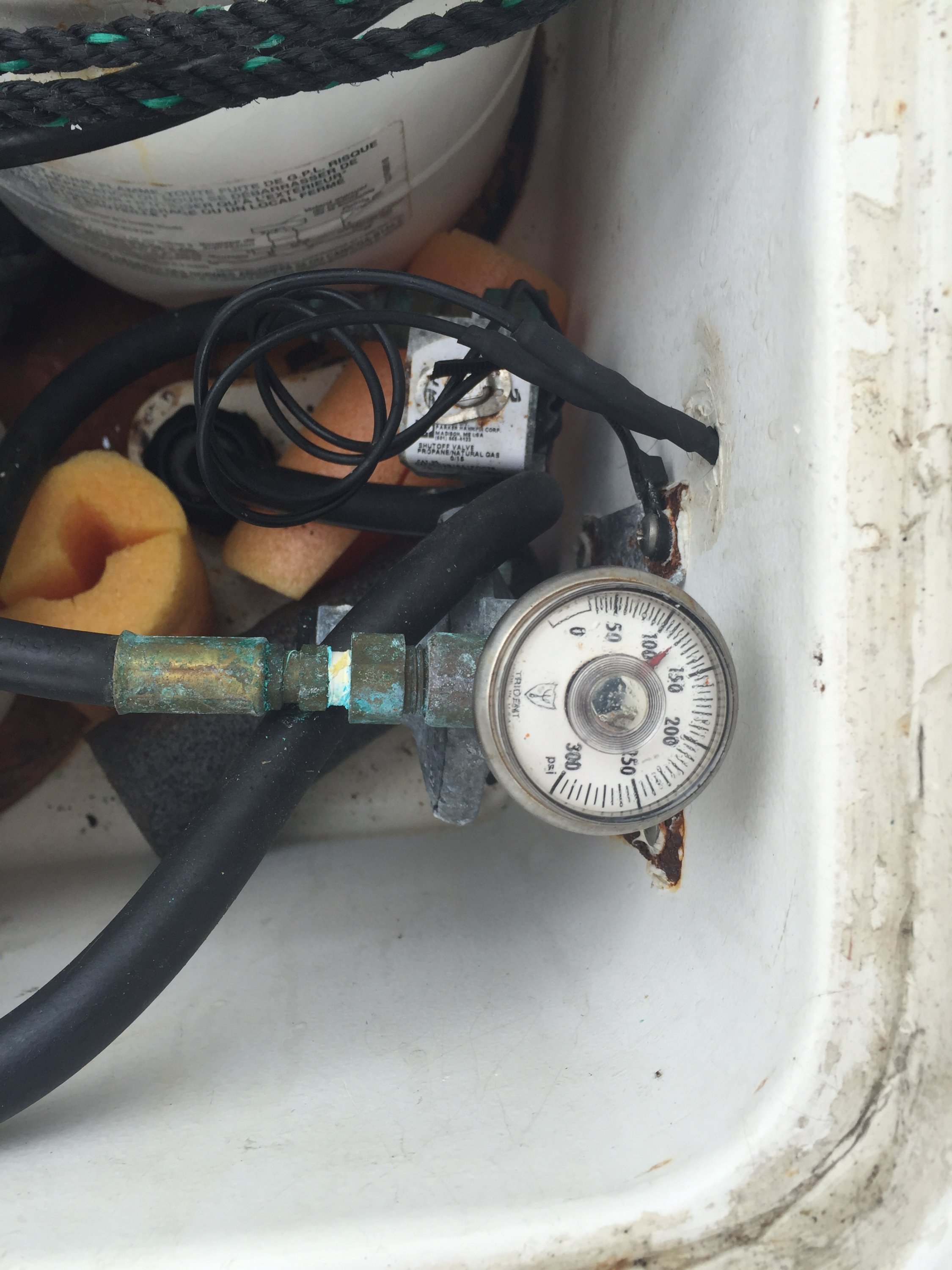

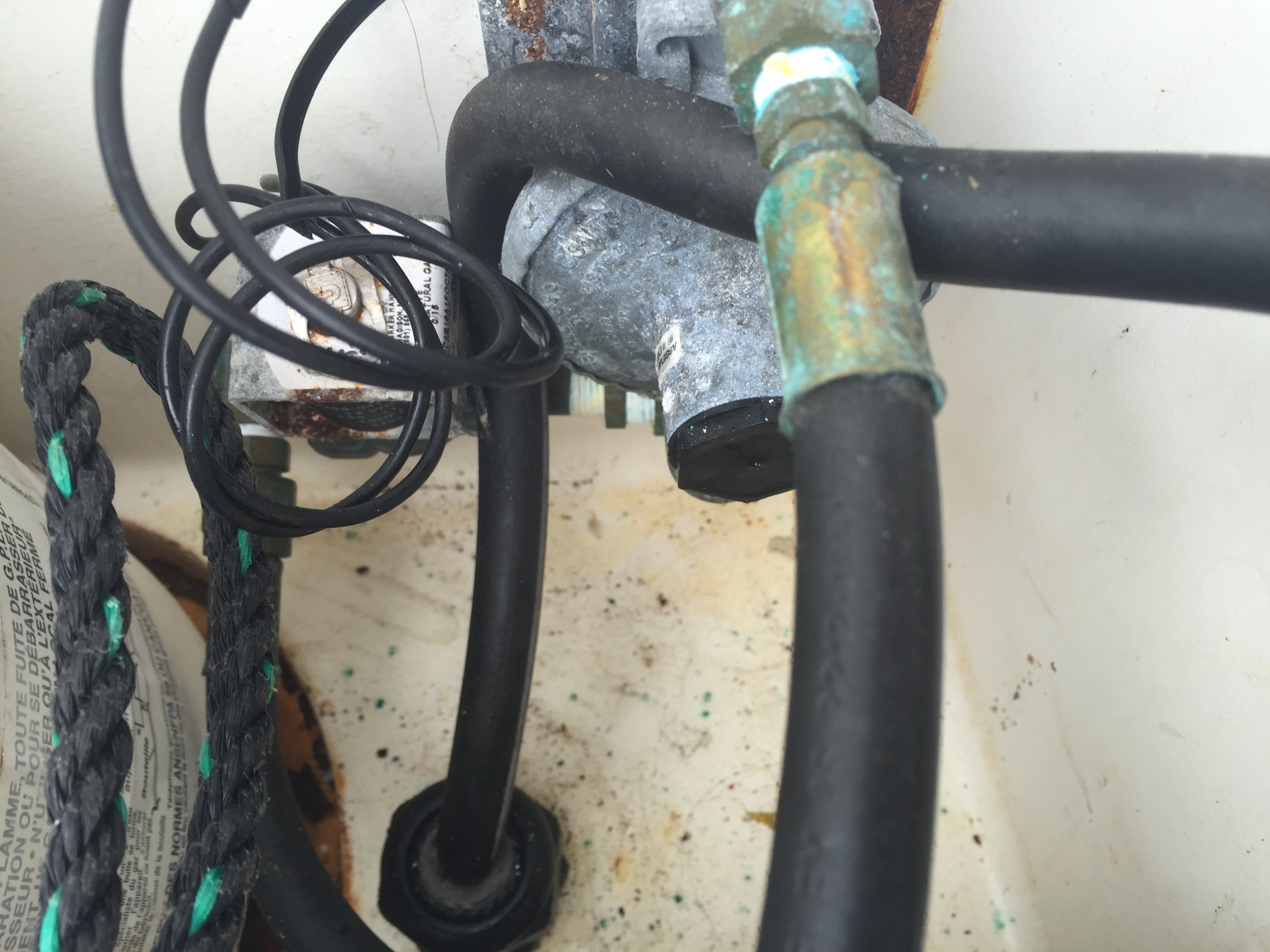

I know this is an,older post but hoping I can get some advice. The propane tank onboard my H340 is full. Propane will run for a bit then shut off. Only thing that works is trying it again the next day and it will light. When on at the stove you hear the propane. When it has these stop working issues, there is no propane running thru, you hear nothing . As some have suggested get a new regulator. Is the regulator come as a kit in the attached pictures. Sorry for the questions but I know nothing about a regulator but when it is working I can whip,up some mighty fine food

If you know nothing about regulators but are completely comfortable with hoses and pipe fittings, I suggest the following in order to replace your reg.:
1. Tightly shut off the valve on the top of your propane tank.
2. Remove your propane regulator from the connecting hoses.
3. Take the regulator to a propane supplier who handles parts and they will provide a replacement. Also get a roll of gas tape at the supplier. Do not use ordinary white teflon tape.
If you are not completely comfortable with hoses and pipe fittings, DO NOT GO ANY FURTHER. You will be risking a fire at best or a gas explosion at worst. Call a gas fitter, hand over the regulator, and let him install it. Having the reg in hand, you'll have saved him some running around = money.
4. Install all fittings on the regulator.
5. Open the gas valve on the tank.
5. Test all of your fittings with a weak solution of dish washing soap to ensure you're leak free.

Bumpers Mom, it could be an issue with the solenoid valve shutting off when it gets warm. (electrically that is) Turn the gas on at the switch in the boat and check that the stove works. Turn off the stove and leave the electrical switch in the boat on for about the same amount of time that the gas would normally flow or maybe a little longer. Then try and relight the stove. If there is no flow of gas to the stove then it is possible that the solenoid valve is shutting off.
Good luck.
