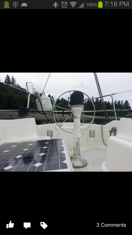

I have a propane tank on the stern rail, a cook stove/oven roughly amid ship, and a older Force 10 heat stove just aft of the V-berth. It seems the Force 10 only runs well when the propane tank is full. When it gets half empty the Force 10 won't light. At least so it seems that is what's going on. Meanwhile the cook stove still lights and runs fine. Plenty of propane left.So the Force 10 which is about twice as far from the tank won't run when the closer stove will. If I fill the tank, the Force 10 runs again. Does this make sense? Is there anything I can do about it without re-plumbing?

How big is your propane tank? How often do you use the Force 10 heater? Go ahead and conduct a system pressure check to test the lines and appliances for any leaks. The system should hold pressure for at least two hours to be deemed a passing grade. A good working regulator will accomodate pressure differences within the tank and after pressure testing the system if the problem persists then it can be a good indication that the regulator may need replacement. A really small tank like 5 lbs or less may cause problems and an appliance that is not frequently used may have air that needs to be purged from the line.

How is your tank mounted & is it in the proper position for the type of tank it is?
