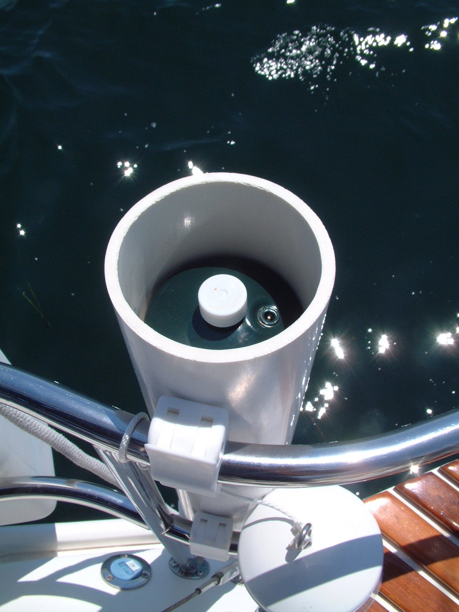

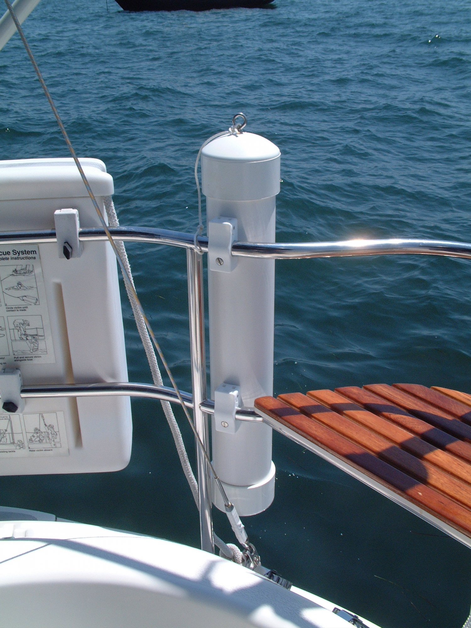

I use REFILLABLE 1# bottles for my BBQ. These bottles are designed to be re-filled; they are NOT the normal green throw-aways.
I made a bottle storage container that holds 3 bottles. There is a hole in the bottom of the vertical storage tube for any leaking gas to flow overboard.
flame-king-propane-tanks-ysn164-64_145.jpgflame-king-propane-tanks-ysn164-c3_145.jpg2012_0708_121427.JPG2012_0708_121514.JPG
