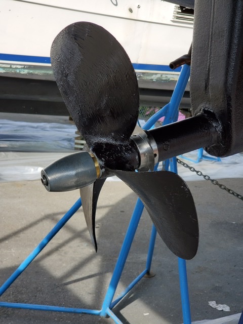

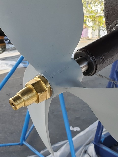

Beneteau prop zinc for 25mm shaft is small and it is not lasting one season is sea water. They recommend adding collar zinc in front of the prop.
I solved the problem by machining a new prop nut (for M16x1.5 thread on 25mm shaft) accepting standard prop zinc for 1” shaft. The zinc is heavier and last longer and also freed space allowing me to install rope cutter before the prop (we have lots of crab traps here).
Another advantage for me is that I can change zinc in the water holding my breath not dragging bottles (collar zinc takes longer to change and I’m over 80).

Ron, in Beneteau Oceanis, cutlass bearing is set in the stern tube and water lubricating rubber in the bearing is flowing from inside out. That’s why B Oceanis design needs water supplied to the stern tube via hose fitting (And also to insure hydrostatic pressure inside the tube is pressurising lips of the Volvo dripless shaft seal. Hydrostatic pressure is also necessary in the PSS Dripless seal or in a common packing gland stuffing box).
Minimum gap required for exit of water from the cutlass bearing is less than 1/4” (and this is taking account for marine growth).
Commonly, propeller is set not more than 1 1/2 x Shaft Dia from the support/cutlass bearing, so there is no room for standard 25mm shaft zinc.
One advantage of sailboats with cuttlass bearing installed in a strut is that cutlass bearing is self-lubricating in the water (no need for hose/barbed fitting inside the boat) and there is plenty of room on the shaft for two or more shaft zincs.
