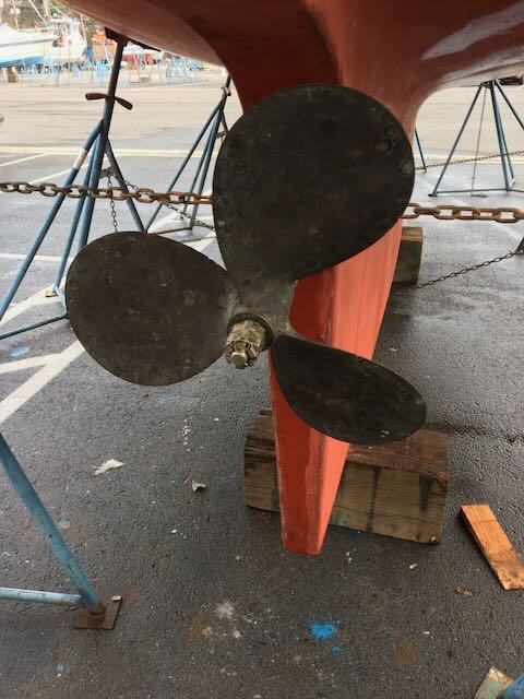

Not a Beneteau, but I switched from a 3-blade fixed prop to a 3-blade MaxProp several years ago. The prop walk is still there, but more manageable. Prop walk can be your friend if you learn how to manage it. Welcome to the forum! :beer:

I am of two experiences.
I had a big "Michigan Wheel" prop on my boat in 2015. It produced significant prop walk.
I switched to a new prop, a three blade "Campbell Sailor".
Very Little Prop Walk. Improved thrust. Improved reduction in drag while sailing.
These are the good things.
The lack of prop walk has meant a lot more work in small boat handling. Once you learn to use prop walk to your advantage, it is almost like having a thruster on the boat without the expense and maintenance.

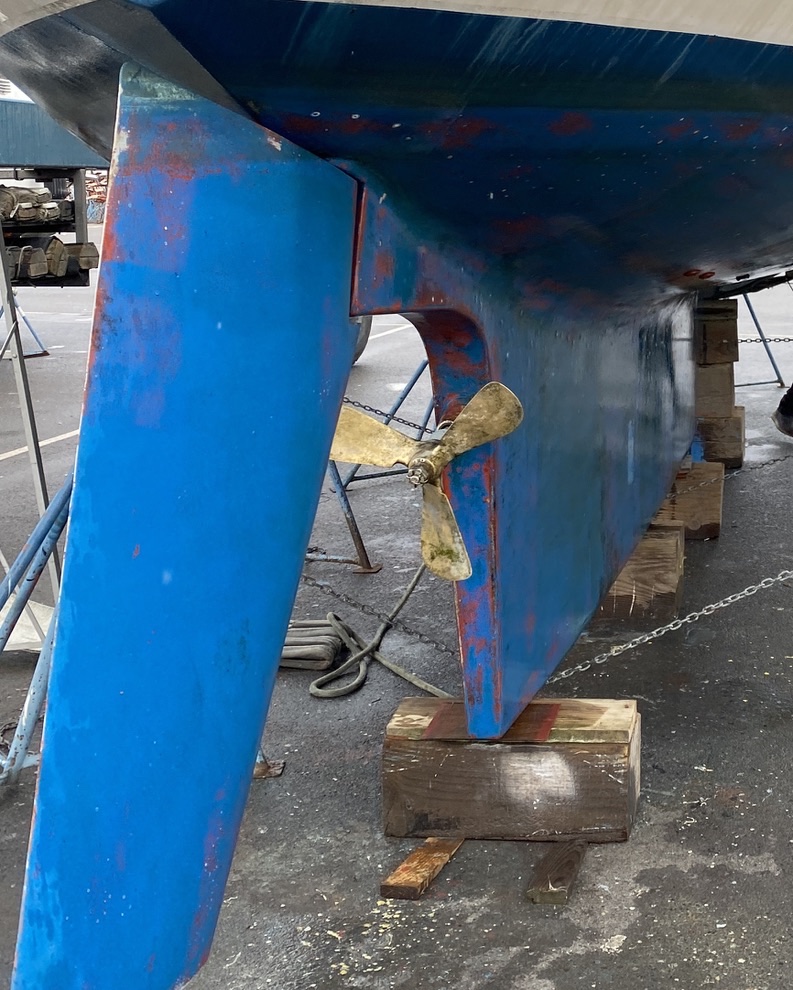

We have a Flexofold which produces about half the walk of fixed prop. I like having that much to help turn the boat. There are times when you have no choice but to work against it, but if you can anticipate how to use it to your advantage it can be a plus.
