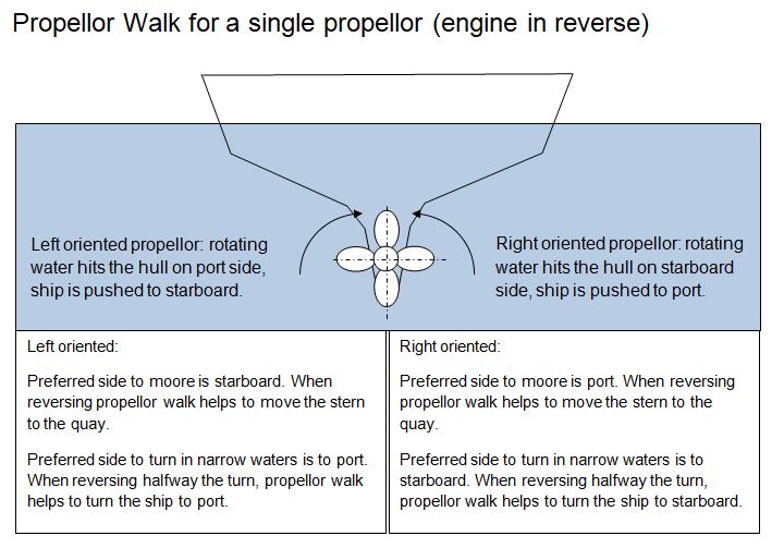

While prop walk is a factor is close handling, its effect is minor compared to that of forward prop wash with appropriate rudder hardover.
Understand that a sail boat does not move sideways,,,it rotates on the keel,,, prop wash contributes to a minor clockwise rotation of the boat. Propwash in forward with appropriate rudder use allows you to force the boat to rotate in which ever direction you choose. Focus on learning to use prop wash and hardover rudder to rotate your boat as needed...in those circumstances where you find propwalk contributes to the rotation that you want, let it do so. On our P31-2 the boarding gate is on the starboard side, so we generally dock starboard to, we rarely get to use a propwalk assist in rotating parallel to the dock, but will forward propwash, it does not matter.

Yes, you can “use” prop walk to help you move your stern in a certain direction, but what if you want to go the other way?
Prop wash...to rotate the boat counterclockwise, hard left port rudder with a burst of foreward thrust. Mix in reverse and repeat as needed

When docking never forget that neutral is your friend. Get your boat moving fast enough for steering control and shift to neutral. If you start to lose control just put the boat in gear again long enough to gain control then back to neutral. With a little practice, you will be able to maneuver in tight spots with ease. Docking your boat so that prop walk will naturally walk your boat to the finger is helpful. For most of us that is probably to port. A consideration when picking a slip at your marina.

....Docking your boat so that prop walk will naturally walk your boat to the finger is helpful. For most of us that is probably to port. A consideration when picking a slip at your marina.
A problem here is many boats come equipped with boarding gates only on the starboard side, where a gate is necessary for the typical pickup by a launch. As a result, if the owner wants to have the dock on the same side as the boarding gate, then you need to dock starboard side. A boat with boarding gates on both sides is a side of a premium builder, or a PO willing to spend some money on his boat.
