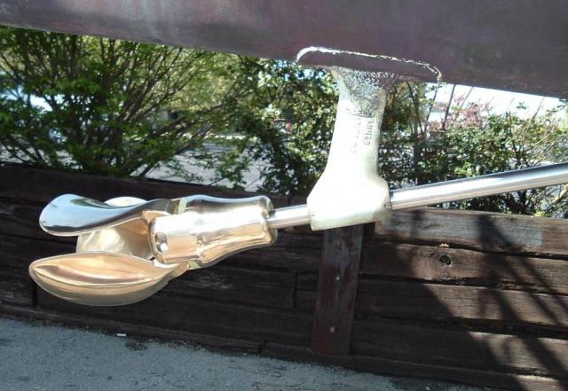

I have a 83 HC37 with a 3QM30 diesel and a 3 blade Flex-O-Fold prop. I don't say that is absolutely the best but:
1 Chuck Angle of Flex-O-Fold was very helpful during the purchase
2 It made a big difference to sailing performance
3 Reversing is O.K. but the same issues of prop walk etc. still pertain.
4 It pushes very well
5 Compared with the old prop it is very smooth when motoring
6 When sailing the whole issue of free wheeling vs locked in reverse goes away. You just put it in reverse briefly after the engine is stopped to fold it.
7 The zinc can be changed in the water. I have a diver clean 4 times a year and he after inspection he changes the zinc about every 4th to 6th time. I keep a stash of the special zincs.
Given that the price was right and I have been satisfied for 6 years I would probably go the same way again.
One thing is, it is much heavier than a non folding prop so I am careful about slowing the engine before shifting. Some people have lost these props and I suspect it could come from shearing the key. I replaced the bronze key with stainless.
