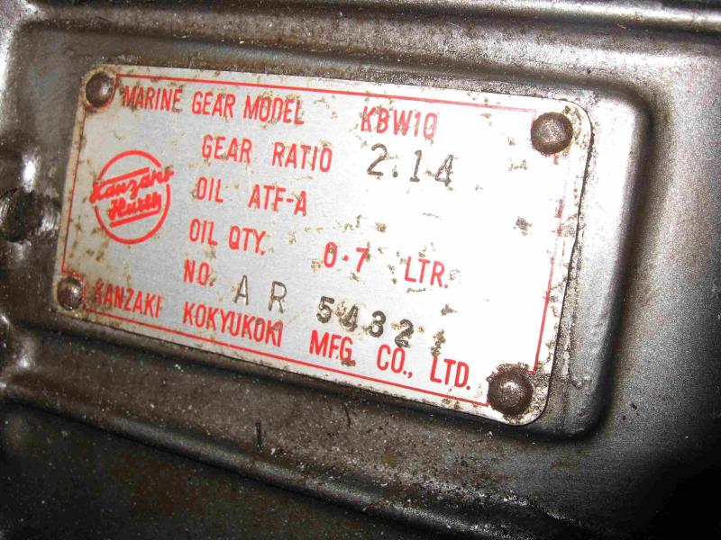

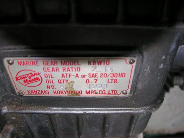

Wish it was that easy! But unfortunately Kansaki instructions on this topic for my very old uKBW10 I have not been able to find on line. And comments about doing reverse or not on the various forums has been conflicting. Much like the transmission oil type specified on the name plate ... conflicting as in the attached photos. ATF only is what is on my transmission's nameplate. Or should I disregard and instead accept that it's the owner's choice of either ATF or 20 or 30 weight engine oil as was imprinted on the same model's nameplate but manufactured only a bit older?

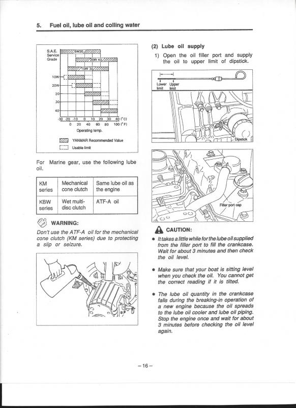

ok here is a scanned copy of the yanmar manual on the oil for the transmission as it is in the manual...print ,save it ,and glue it to your machine room bulk head
Woodster: Yes, I believe you! And as I noted in my last post, I did in fact change to ATF (albeit a more modern incarnation of) five/six years ago on my first or second transmission lube change after I bought the boat and when I noted the discrepancy between the PO's engine log history and the info on nameplate.
I subsequently bought a Yanmar 2QM20 shop manual for detailed information about my engine. It also calls for ATF types for the "clutch case" as follows:
Shell = Dexron
Caltex = Texamatic Fluid
Mobil = ATF 220
Esso = ATF
B.P. = Autron DX
(Wonder how many of these brand names can still be found! Let alone the company name!)
But my original point was to comment on the conflicting information that floats around. I again include the nameplates from two KBW10's. Identical except the serial numbers. The serial# 1223 nameplate gives the owner the option of ATF-A or SAE 20/30HD -- which I believe falls into the category of motor oil. The nameplate for serial #5432 (from my boat) shows ATF-A only. I wonder if Kanzaki/Hurth changed something in the design between the dates that the 4000 or so units where manufactured, or it was later determined that only ATF was best. Did the owner of #1223 ever get the word?
Or maybe it was noted that if motor oil and ATF were intermixed (say for top-off or if the pump out evacuation wasn't complete) that having two lubes mixed in the same clutch case might not be compatible. And of the two choices, ATF-A was preferred. That thought occurred to me when I changed from motor oil to ATF. I pumped out the motor oil and refilled with ATF. Ran the engine in gear for just a few minutes. Pumped out again. Then refilled with ATF. I am beginning to note maybe some leakage at transmission seal near the coupling. I can't shake the feeling that the change of lubricants might have had something to do with it. (But also the engine is 35 years on at this point!)

it not a problem for me i just though everyone could benefit for the information on that page ...it is a bit confusing to some but with it in Yanmars own publication it should help clear things up some ...i was not directing it to you personally just though it would be helpful to be able to see it in writing now it will bring the question do i have a KM or a KBW it seems there will never be and end to this because we are always getting new members or late comers....isn't nutrition a wonderful thing
