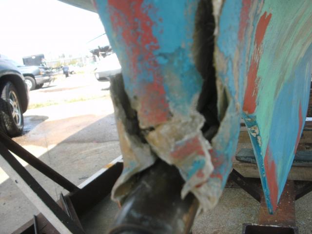

I have NOT looked at this myself yet. Recently I hit a submerged piling with the prop on a 20,000 lb Irwin 37' sailboat. The prop bent, the prop shaft pushed out the side of the hull where the cutlass bearing is, and I have insurance! So, the mechanic says "the shaft moves in and out and it's not supposed to." "Hmm" says I. "How much does it move?" ""A few inches" says he. "Hmmm" says I. Now I cannot imagine the shaft having any play in it at all, or else when you go from forward to reverse, it would tear something up over time. So weigh in! Should I have the tranny repaired too (if possible) as the bearings and who knows what might also have been damaged.

With damage like that every thing is suspect including any mounting points.

You need a new mechanic
That one does not have a clue. Run, don't walk away from him.

the back lash in a tranny is measuerd in thousands not inches Im thinking you should get another mech.

you may also want to check and see if you sheared off the shaft but like has alredy been stated get a good surveyor to inspect the damage ......

believe it or not I actually only thought I bent the prop, not damaged the whole area, and so we did motor for days with it in this condition, with no apparent problem except reverse. As for getting a survey, I would assume the mechanic who told me about the problem SHOULD know tranny's, but I will ask the insurance adjuster to send one. The shaft didn't break, but someone suggested that it may have slipped on the coupling. I'll find out more today.

I believe the thrust bearing should not have any play in it.
It is taking the full load of the shaft as it is pushing or pulling the vessel. I would have the tranny checked as will as the strut alignment.
