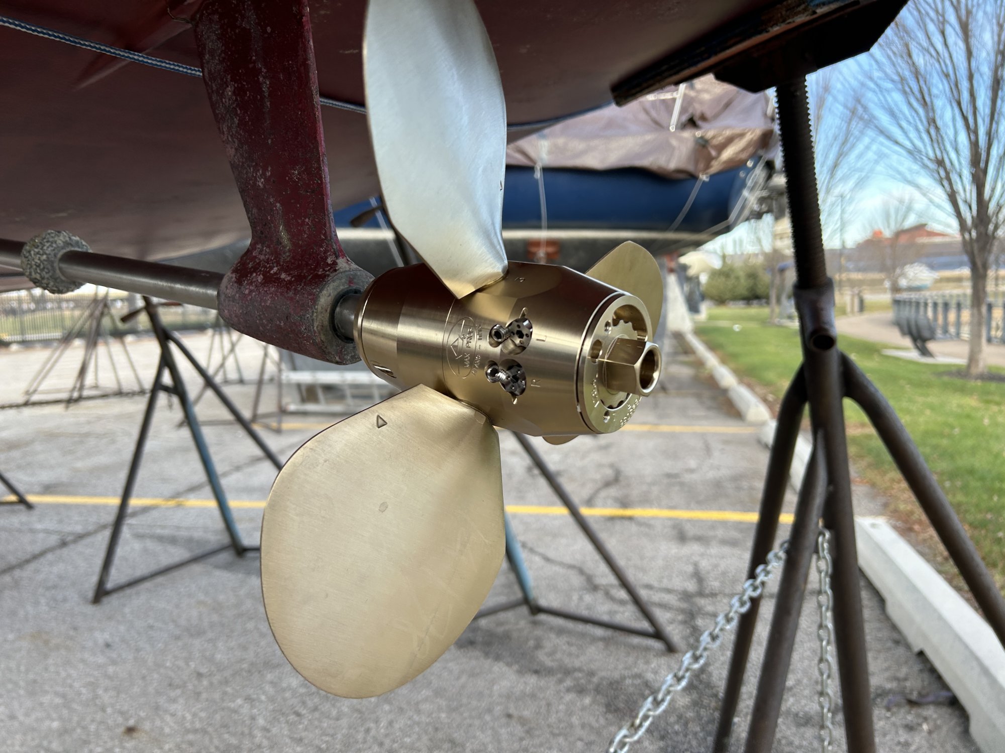

:facepalm: Yep! I don't know what I was thinking! I even had the Autostream installation manual in my files. Well, I won't be sending it to Max Prop to be reconditioned, but since I have it at home now, I will do some servicing by myself. But I think I'll call Martec for some guidance. I'm pretty sure the previous owner bought this prop from Martec as I seem to recall I've got some papers from Martec concerning the prop.
I had already sent the servicing form to Max Prop and got an e-mail reply today. I e-mailed back that I made a mistake because I have an Autostream and he laughed and told me I could have a new Max Prop sent to me before Christmas!
While I was thinking that I had a Max Prop, I was always confused by the grease fitting, which was described in a different manner. As you can see, the zerk is right behind the zinc!
Come on….go for it! Give yourself a Christmas present! Mine is a retirement gift to myself ! :beer:
This was a test fit (and I don’t have the cone zinc on yet). But dang, what a work of art !

Yeah, I thought that was an autostream, I did mine last year. It's fairly easy to overhaul. Usually all you need are the new O-rings. Martec has the O-rings and the manual is downloadable from their website. Read the manual carefully when reinstalling, the blades need to be feathered. I did not read the manual and learned what RTFM means. Luckily, I noticed it and corrected it before it went in the water.

If you tell Martec the year and sailboat model and engine/transmission combo that you have, I can bet that they will recondition the prop and pitch it correctly for your boat and set the forward and reverse pitches correctly. You will still need to remove the hub from the blade assembly for installation, but once you align the blades on the hub, the forward and reverse pitches will be correct.
