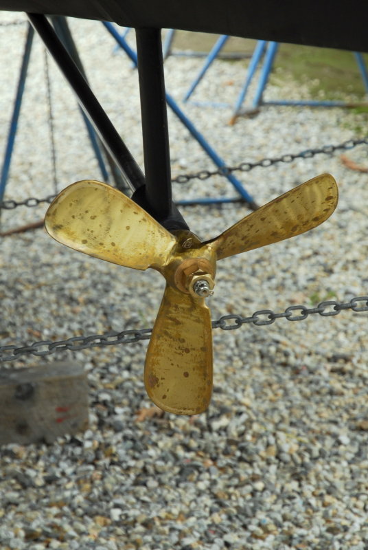

The photo below shows the WRONG way to pull a prop. You should always leave one nut on the shaft bit with about a 1/4" between the prop and the nut. If you don't leave the nut on you may get hit in the face with the face with the prop.
