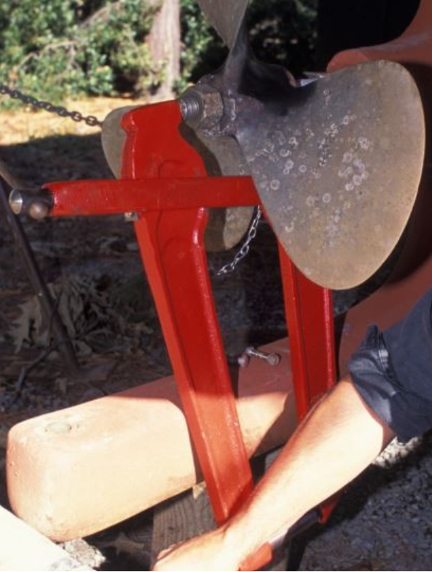

I tried everything that I could think of to remove the prop, all kinds of pullers, and finally had to hire someone to come and remove the prop. He had a removal tool something like this, and it finally popped off (with a BANG!)... The nut was still in place to keep the prop from dropping.

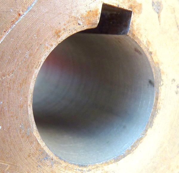

Michael. You want the prop to be fitted to the shaft. The prop should be gripping the shaft tightly so that the shaft and prop are one. The conjecture that the prop walked up the shaft is unlikely (unless you did not have the prop firmly on the shaft. If that is the case you are fortunate that the prop was still attached. It could have just as easily fallen off the shaft or worse wobbled and damaged the shaft and hull. :yikes:
Here is a recommended method of fitting the shaft and prop. Honing the fit so that it is tight and solid. It may pop/bang again next year. It will be unlikely to slip off leaving you propless.

The prop and nuts may not have been installed properly or there is something wrong with one or the other…(the nuts should have been in contact with the prop and the prop should not be able to “walk” up on the shaft), but they will come off with a BANG ! That is just the nature of the tapered shaft and prop.
Fo not put anything (lubrication, grease, etc) on the shaft. It is intended that they “stick“ together.
Here is when I took mine off to replace it with a 3-blade feathering prop (Maxprop).
I used a home-made prop puller….works pretty well…

You could have saved yourself a lot of hassle by just heating the prop's hub with a torch. Bronze heats up much faster than the SS shaft, so the prop will always come off easily, with a simple puller.
Jun 1, 2016
162
Hunter 28.5 Lake City, MN
I tried heating (map gas) the prop, for a LONG time too! I bent a couple of pullers in the process. Like I said, it took a very big puller (with a lot of leverage) to get it off.

Well, it cost me about $15 for the blueing agent & grind compound, but I got it done. The valve grinding compound that I found (wasn’t a lot of choice yesterday) wasn’t what I would’ve liked, as it grooved the shaft more than it should have. The blueing agent showed that most of the pressure was at the smaller end of the taper, and it was some pressure at the very top, the middle was almost untouched.
I did check for being key bound, and mark the shaft. But when I put on the nut too fasten the prop, it pushed the prop up past where the line was. I’m sure I’ll have a very difficult time getting it off next time as well. at least I know who to call to get it off.
