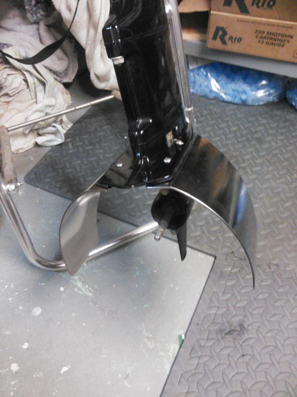

prop guard installed on a 6H.P. Tohatsu.
Hints. : This guard purchased here, (as was the one I put on my previous motor). On this motor, it has to be installed UNDER the horizontal plate because the motor body above the plate is to wide for correct fit. You will also find that you can`t use the forward predrilled holes as the screwheads would be hard up against the housing. Just drill your own holes.
