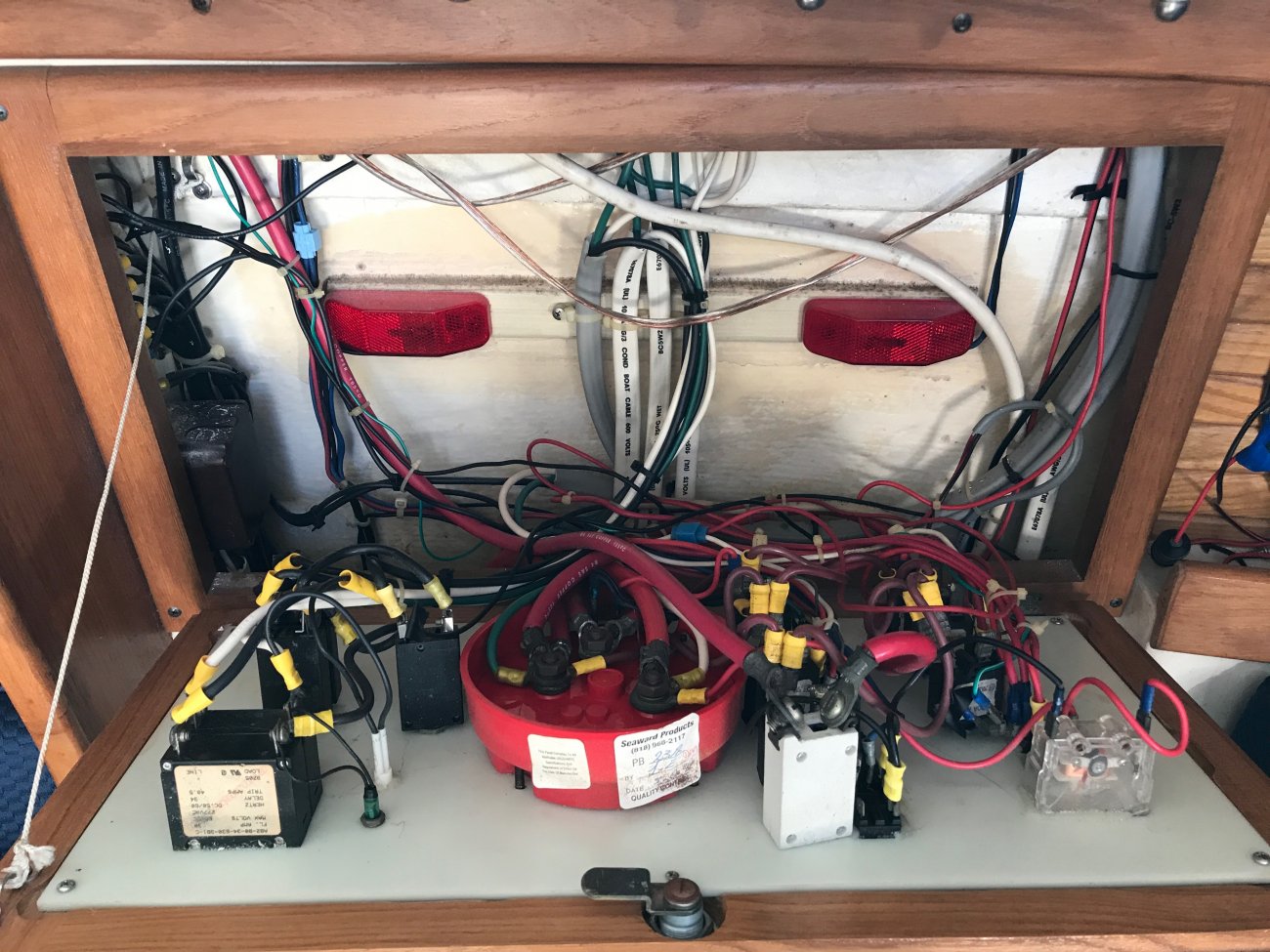

The original DC distribution panel left a lot to be desired. Push button circuit breakers for groups of circuits, toggle switches that were hard to see if they were on or off, all connected by 10 awg wire and quick connect spade type connectors. There were a few times this past season I'd have to open the dc panel and put back on a quick connect that had come loose and fallen off.

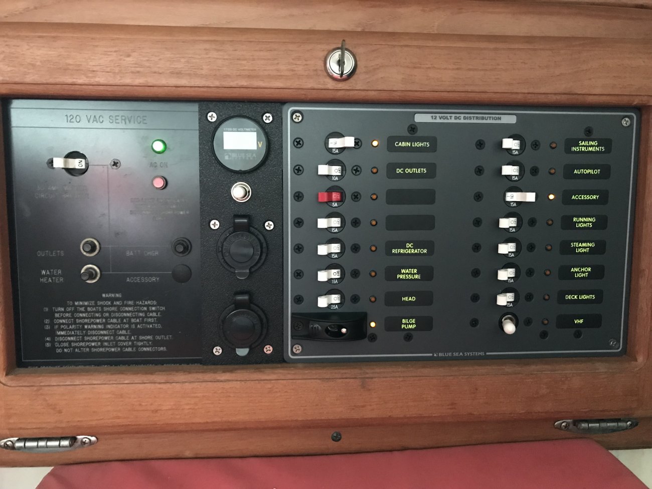

I decided I would make my own switch panel. I'd use toggle switches with screw connections instead of quick connects, add circuit on indicators and use fuse blocks for OCP. I studied how Tom Y, Sumner and others built their switch panels to get ideas.
I also looked at the Blue Sea DC panels to see what they had to offer. I kept going back to their 16 breaker toggle style panel. It would fit within the teak frame of the existing panel and look much neater than anything I could build.
Enter more PROJECT CREEP!
After thinking about it over a couple of bourbons, I ordered the Blue Sea panel.
I mounted the new panel right over the old panel. I made a narrow panel out of ABS sheet plastic for two DC Outlets and a Blue Sea Digital volt meter and battery selector switch and mounted it alongside the new switch panel.

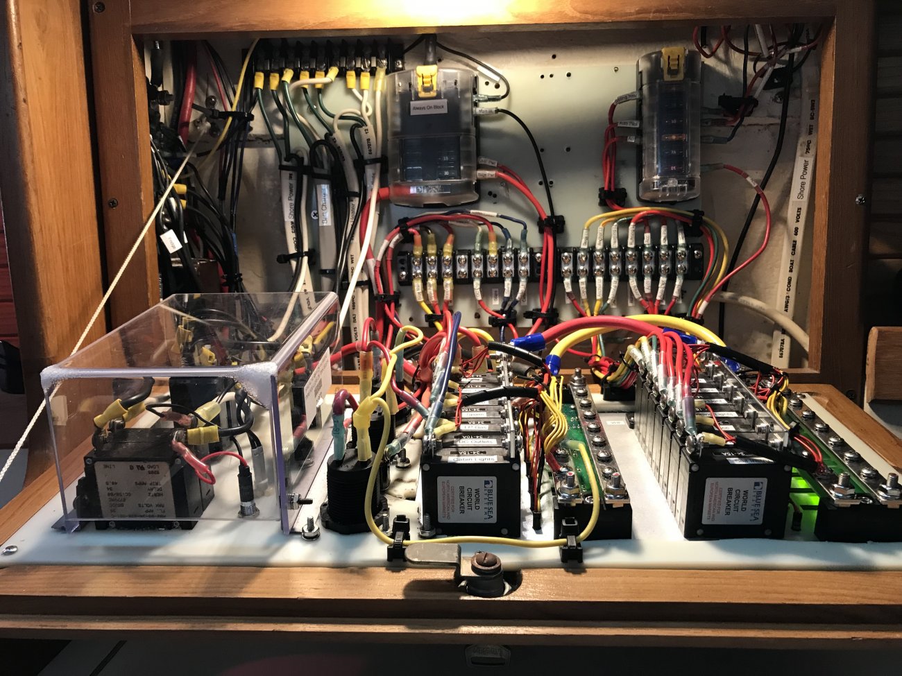

To avoid having to have too many various size breakers I installed a 6 individual circuit fuse panel on the back plane. This way I could use almost all standard 15A breakers and run the loads that needed lower amp fuses through the individual fuse panel.
I then installed the new DCP battery switch below the panel. After thinking about how to fuse the new DC panel, I decided on installing a C Series 3 breaker panel I had for another project that never materialized. I put it next to the battery switch. One breaker for the DC panel, one for a future inverter install and one spare.
I left the original AC breakers in place for now. When I'm ready a Blue Sea AC Breaker panel will just fit in the remaining space next to the DC outlet panel and the Blue Sea DC panel.

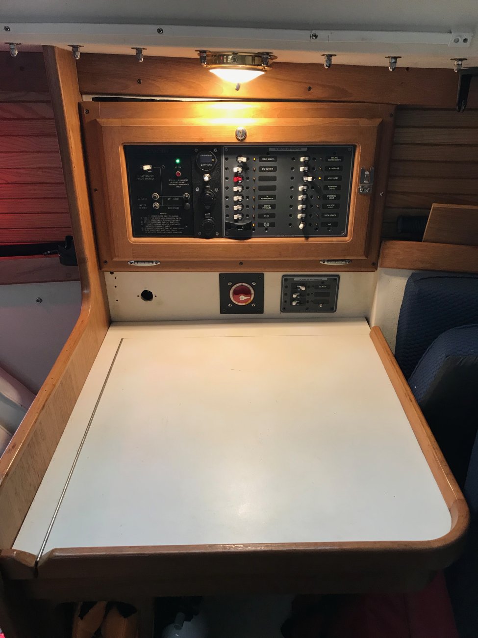

I have a related situation, and I'd love advice from you all:
Who knows the trick for accessing the rear of a Catalina 30, Mark I electric panel?
I just bought 1982 Catalina 30 Mark I, hull #2462. A photo of the panel is attached.
I love how Ward's panel pivots on a hinge for EASY access--even the original panel apparently did this.
Mine does not. When I remove the four screws in the corners of the wood panel, then I can pull the entire panel outward a couple of inches. I am able to see the wiring behind the panel, but I cannot find any way to move the panel enough to get in there and work. There does not seem to be enough slack in the wires. Maybe it's just one or two wires (i.e. battery wires) causing the trouble. I don't want to pull too hard.
Lastly, what's with the plunger breakers between the AC and DC sides??!! They are DC, at least one of them. It operates the depth sounder. The other ones are currently inactive. I wish I knew why they are there, and why they are a different style.
I am spending a fair amount of free time sketching what I want the new panel to look like. The surveyor said I should have voltmeters for both DC and AC sides. My plan is to add a couple of separate AC circuits (hot water tank does have its own AC breaker in galley). I'll add a few DC circuits along with a 12 V outlet or two.

That's not an OEM panel. The PO made his own. You'll have to go find the "tight" wire(s) behind and underneath. Good luck.

@jnorten
Welcome to the SBO forum!
My first guess is the slack for the battery cables, if any, dropped down and need to be pulled up to give you enough slack to open the panel more. I know on mine I had to pull them up every time I opened my panel until I moved the switch.
It looks like your panel is actually several panels. If so you might be able to take off just the battery switch panel to see if those cables have enough slack.
Unhook the cables at the batteries first.
Not sure why the surveyor said to install voltmeters for AC and DC. Thought they were optional, not required.
Only the PO knows why he chose to use those type breakers but probably the same reason Catalina used what they used. Cost and availability.
