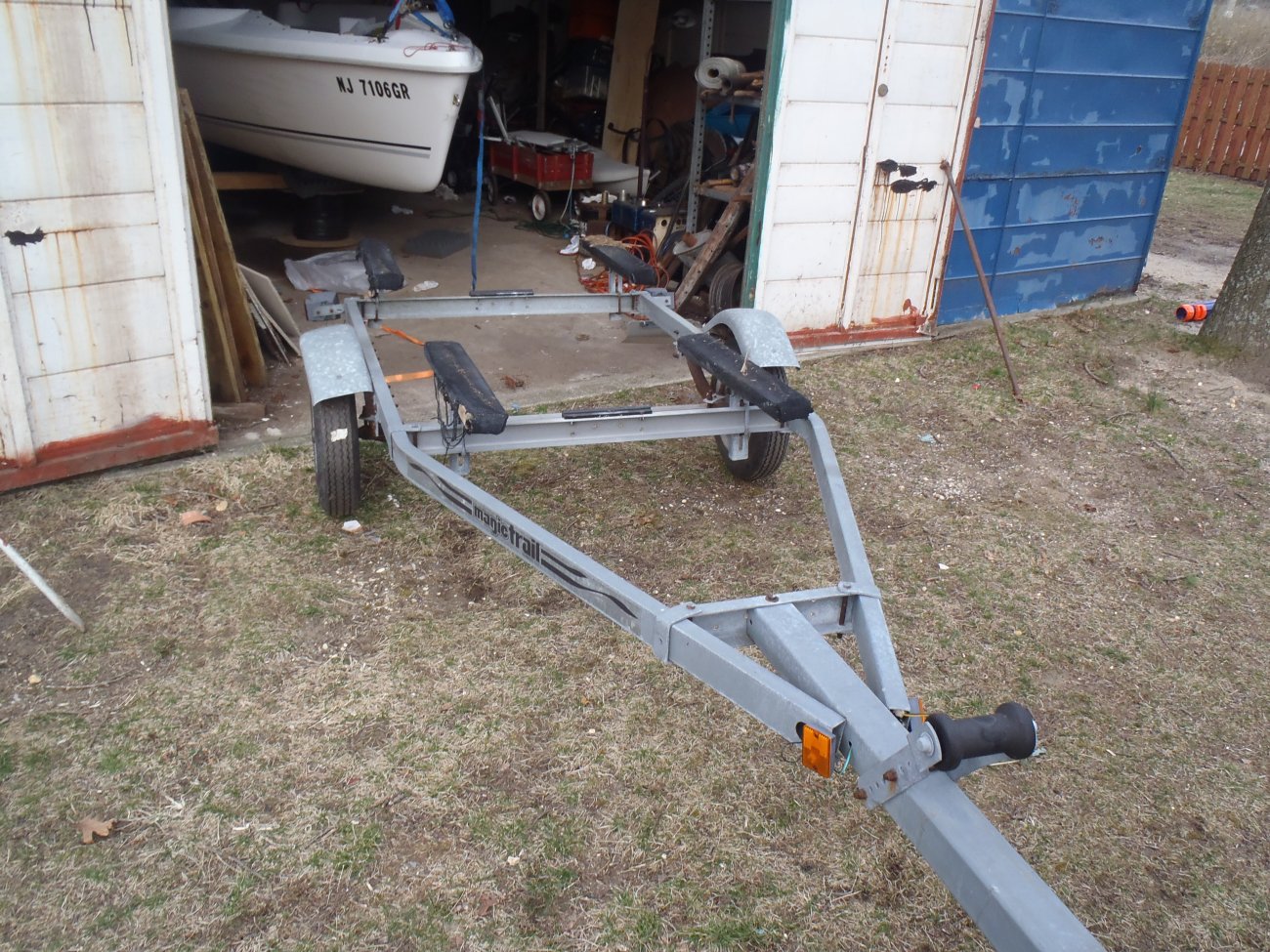

Progress? Trailer out from under the boat.

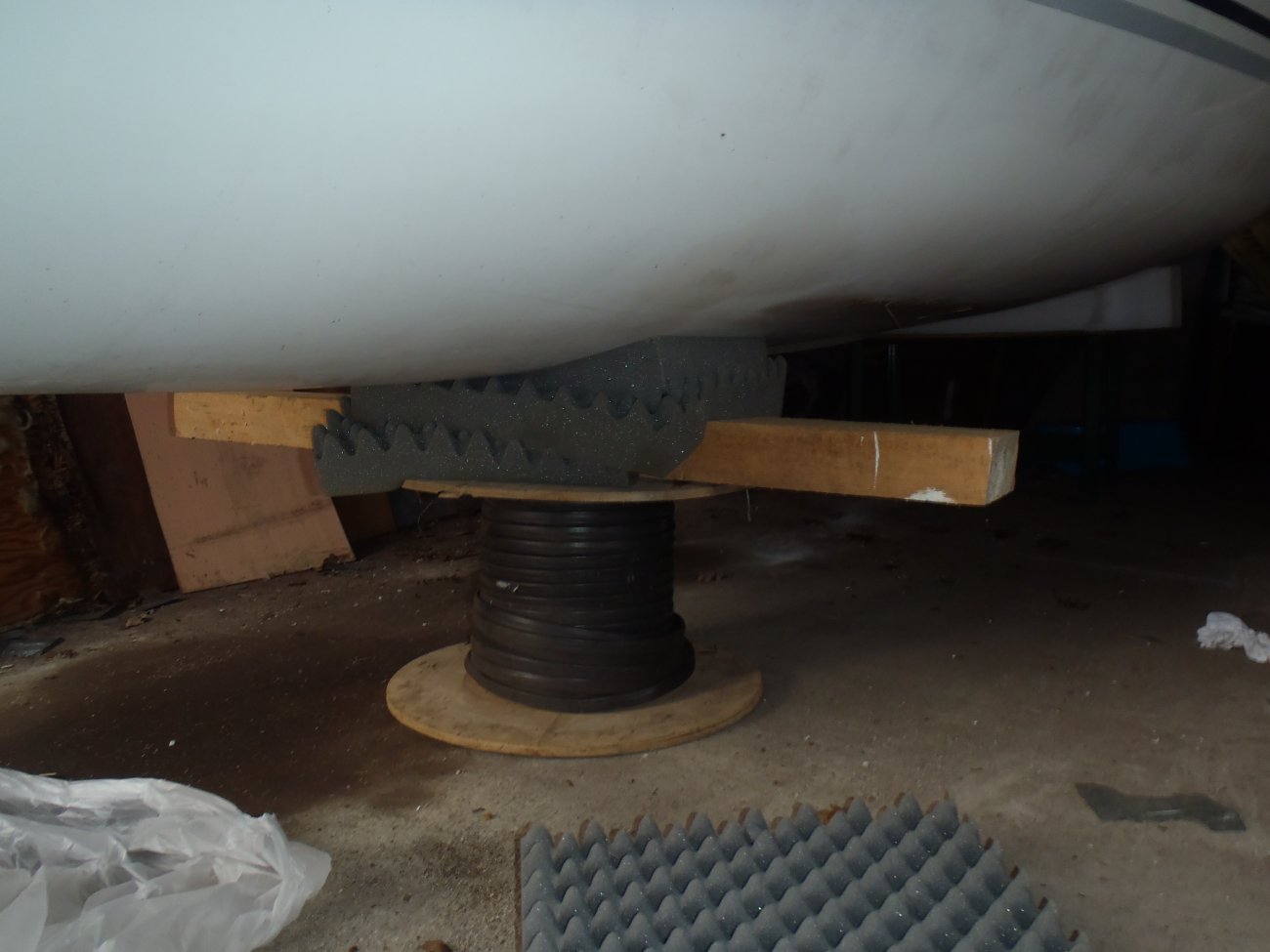

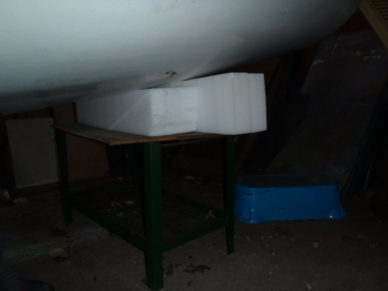

So I got the boat off the trailer. I got some nice foam blocks from the trash the other day. So I used a heavy metal medical O2 tank holder and the foam for the rear. I cranked the front way down, jammed in the foam and cranked it up.
I used the come along to lift the front and out the trailer came. I rested the front down on a wire spool with some foam on top and have the weight split between the come along and the block like 100lbs or so each.

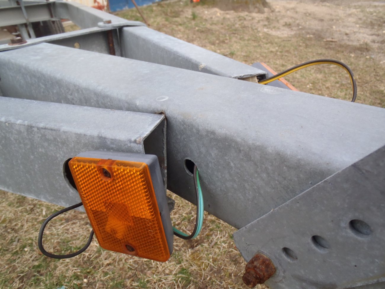

The trailer has a wobble where the straight front piece is held by the 2 side pieces. I hope to fix that some.

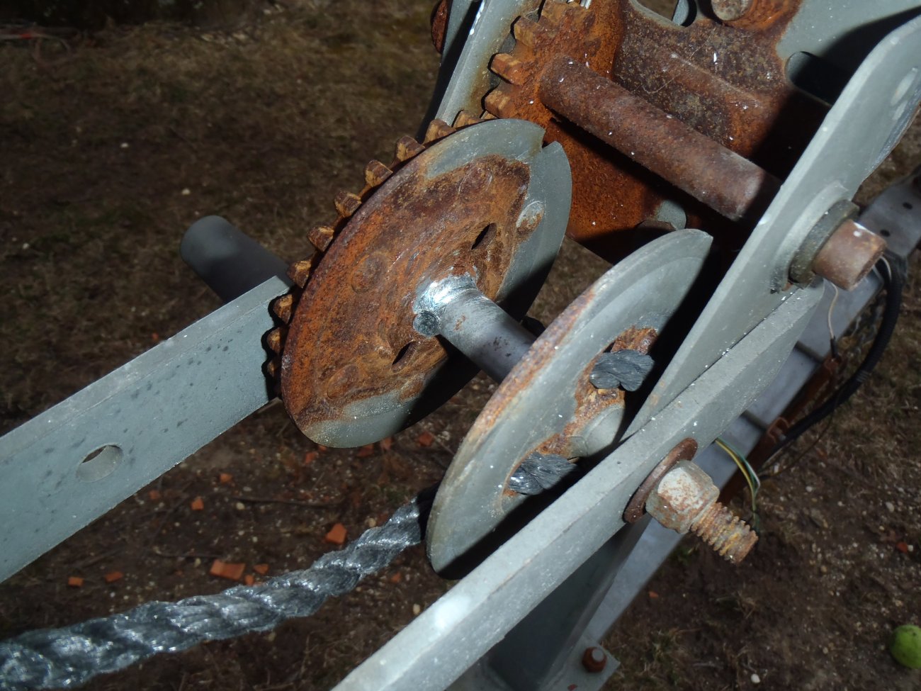

I am debating if I should go through the trouble of taking the winch apart and getting the rust off and then cold galvanize the bare metal. I have a glass bead booth so that is not much trouble for me.
I am going to take the axle off, looks like 2 front bolts at the springs and I can take the hole unit off. I want to get the rust off the springs, paint and grease them up or something. I also am going to pull, clean and inspect all the bearings.
Then the wiring needs a redux. They use unsealed splices and just twisted together wires.
Last is new bunk covers.

So I took the square section out of the area where the 2 side meet. I then used a big hammer and a pry bar. Not to pry mind you but to transfer the force of the blows. I moved the bent in section of the starboard side rail. Now the front box section does not rotate back and forth and the front ends of the 2 side rails have full contact.
Found the winch was not attached very good. So that is all apart, rust blasted off, and painted with cold galv. Also needed to get the spool off cause it was cheaper to buy a flat strap with the hook on the end then to buy the hook and the line.

  • Don't use wire spools to support weight. I've seen 6' wide spools wobble like crazy when turned on its side. We only had 100lbs on top of it

I have 2 wire spools. One wobbles a lot and the other was solid as a rock when I stood on it (I am 200 lbs). I do not trust it anyway so the boat is also suspended from joists on the ceiling with about 100lbs on each. It was easy to do and be extra safe.
