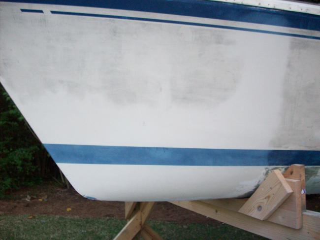

Finally found some time to strip the bottom paint off. I used Peel Away. There was about 5 layers of paint to strip off. There's a layer of what I'm guessing is an epoxy paint on top of the gelcoat that needs to be removed. On top of that in some areas is another hard paint that the Peel Away didn't touch. It's kind of a nasty yellow green. It's in really random spots on the hull. I started sanding some last night. I bought a cheap belt sander from Harbor Freight since I figured I could toss it at the end of the job if I needed to. I'm going to focus the belt sander on the hull where there's still a lot of thick paint left on the bottom. The RO sander seems to take care of the rest. I did some test spots with both sanders and with that bottom paint out of the way, it really comes along pretty quickly. The gelcoat is actually in pretty good shape in most places. A little thin in some areas. Several cracks that need to be repaired. But the boat actually looks salvageable now. The transom before http://img.photobucket.com/albums/v96/blustig/Sailboat/100_1217.jpg The transom after http://img.photobucket.com/albums/v96/blustig/Sailboat/100_1219.jpg The hard paint I was talking about. Mainly only on this side. http://img.photobucket.com/albums/v96/blustig/Sailboat/100_1215.jpg After a belt sander and RO sander. It cleans up nicely http://img.photobucket.com/albums/v96/blustig/Sailboat/100_1216.jpg My goal is to get the rest of the bottom sanded down this weekend so I can do the needed repairs. At least get the rest of the bottom paint off with 80grit. Then I can hit it with finer grits to get it ready for paint.

I think I need new shoulders after this weekend. OK, I didn't meet my goal of sanding all the bottom paint off, but I did get a lot more accomplished than I was planning. First off, I finished sanding the topsides on Saturday along with quite a bit of the bottom paint. http://smg.photobucket.com/albums/v96/blustig/Sailboat/?action=view&current=100_1232.jpg Here you can see a nice before and after on the worst side http://smg.photobucket.com/albums/v96/blustig/Sailboat/?action=view&current=100_1233.jpg On Sunday, I sanded more of the bottom paint off until my shoulders had enough http://smg.photobucket.com/albums/v96/blustig/Sailboat/?action=view&current=100_1251.jpg So, I moved on to removing deck hardware http://smg.photobucket.com/albums/v96/blustig/Sailboat/?action=view&current=100_1241.jpg The boat actually looks pretty darn good as is right now. 3 of my neighbors stopped by complimenting the work. I believe they meant "Thanks for cleaning up that eyesore that's been in your driveway for over a year!" After removing hardware, I sealed up the holes with some metal tape with polybutyl backing. http://smg.photobucket.com/albums/v96/blustig/Sailboat/?action=view&current=100_1243.jpg Now, once I finally finish stripping the bottom, I can start on repairs. I have to make a decision on what I'm going to buy for repairs. Either a gallon of epoxy plus fillers or some Marine tex plus a smaller amount of epoxy plus fillers. I'm leaning toward the latter because I've got less repairwork than I expected. I know I'll use the epoxy, but I've also heard good stuff about Marine Tex.
