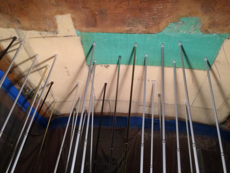

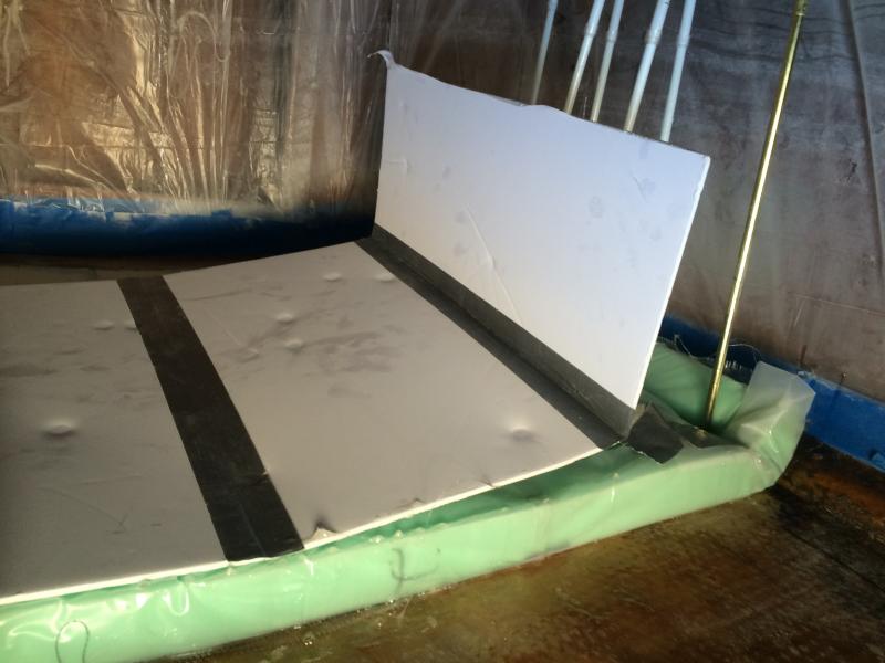

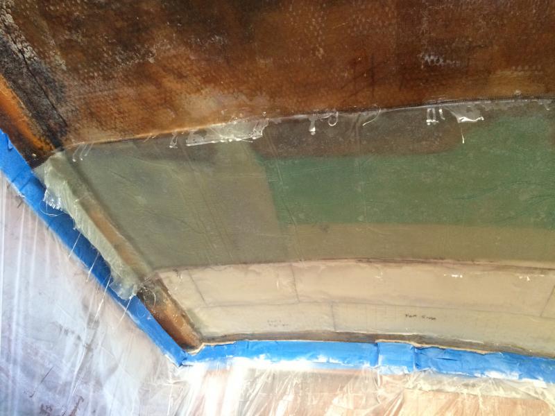

I spent the winter cutting off the bottom skin on the coach house and side decks, removing rotted core, and grinding. I was starting to wonder if maybe this prject was starting to get he best of me. I am happy to say that last weekend I I bonded the new core material ( 1/2 inch Core -cell) to the cabin roof. Finally, progress and not demolition!! Now I need to lay new glass upside down on the new core material. I am thinking 4 layers of 10 oz cloth and a layer or 2 of thickened epoxy. I used 2 layers of the 10oz glass cloth on the top f the core material and I don't think I have enough for 4 layers on the bottom. I am wondering if I should use a layer of woven Roving, 12.5 oz coth or more of the 10 oz? I read that when using Roving you should use a layer of chopped mat and that you shouldn't use chpped may with Eopxy. If I thicken the epozy with micro fibers would that take place of the chopped mat??
