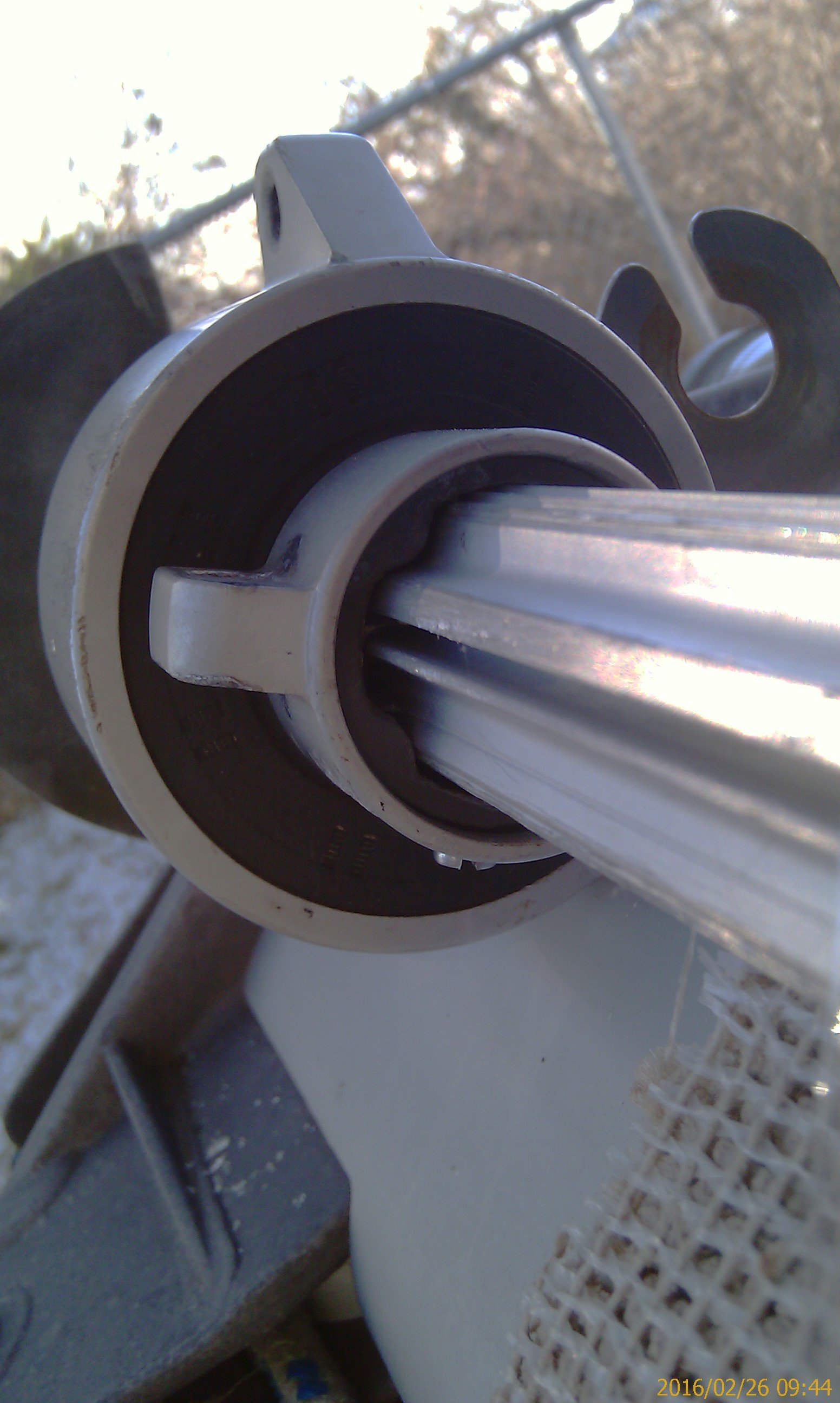

I have the same boat and had the same problem. There are 2 bushings in the swivel that wear over time. If they haven't been changed it's probably time to do so. The swivel has turned on the extrusion and got stuck. If the bushings have worn badly enough, there are 2 steel guide pins in the swivel that can dig into the extrusion and prevent the swivel from sliding down.
The bushing are available from ProFurl and fairly easy to remove and replace. Unfortunately my hard drive crashed and the pics I had are gone.
I dropped the mast at end of season to do the work.
Good Luck
PS Just found a pic that shows one of the bushings

Thanks Joker- that looks like it could definitely be the problem. Maybe I should buy the parts and they might be able to take it down, fix it and put it back up right away. I'm wet storing (Long Island) this season and have nowhere to store the rig if it has to be down for any length of time.
