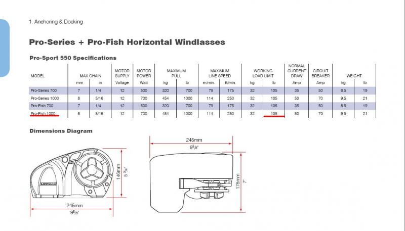

If you look at the Lewmar calculations shown below, your Profish 1000 is only good for a working load of 26 lbs. while your ground tackle with 100 ft. of G4 and a 30 lb. anchor weighs in at 139 lbs.
The way that Lewmar rates their windlasses is extremely misleading. You have to read their literature very carefully. Their listed maximum pull and working load limit are a crock and can give you a bum steer.

.......................... it's overloaded, way, way overloaded. If you look at the Lewmar calculations shown below, your Profish 1000 is only good for a working load of 26 lbs. while your ground tackle with 100 ft. of G4 and a 30 lb. anchor weighs in at 139 lbs....
Not sure where you got 26 pounds. You underlined 105. Keep in mind you're not lifting the entire chain rode, only that number of feet that the depth of the water is.

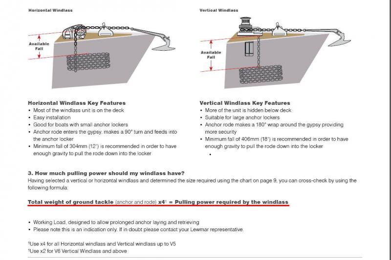

........................ and they call for a factor of safety of four. They state the working load limit of the Profish is 105 lbs. and that must be divided by a factor of four = 26 lbs. They also recommend using the total weight of the ground tackle because you never know when you'll be in deep enough water that you'll be lifting all of the tackle.
As I said, their figures are very misleading and you have to read closely to ensure your choice is correct.

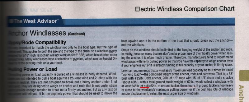

I just installed a 1000 last week, and the paperwork is on the boat, but a quick looking at the West book (page 219)explains in English that you MULTIPLY the working load in the shart TIMES 4 to get the pounds of PULL. That's why/how the ProFish 1000FF is rated, 1000 pounds of PULL. At 105 pounds of ground tackle (X 4 =420) even the 750 would be overkill, but all the same i used the 1000.
Please re-read and re-calculate your needs, and maybe you could have gotten by with something smaller than what you used.:doh:

....................... it's clearer to use the Lewmar literature rather than the WM Advisor. Forget the maximum pull. This is the pulling force due to the locked rotor torque just as the circuit breaker opens. You never want to go there. Work only with the "working load limit".
Where the WM Advisor is less than clear is their use of the word "pull" rather than "working load". Pull refers to the "maximum pull" in the Lewmar literature, WM should have used the Lewmar term "working load limit" which is about 1/4 of the maximum pull.

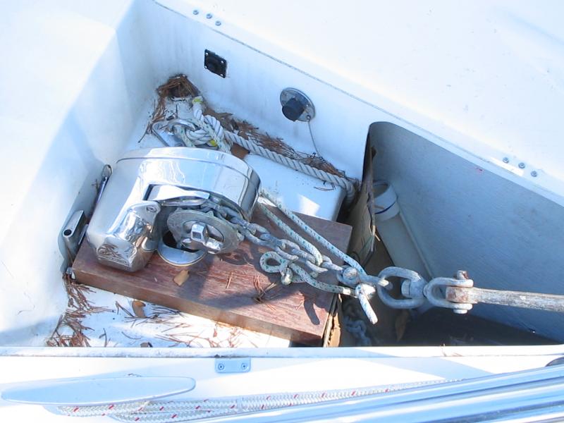

This was a replacement for an earier version of the 1000, which had a known design flaw. I don't know the layout of the 321, so can't really advise too much. Overall, it takes some advanced thinking about the task. The pic shows the original install, but the escond one i moved forward about 5 inches.
