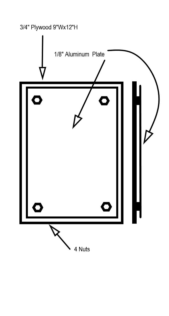

My 2001 had burn marks on the bulkhead and rear cushion when we bought in 2007 from the exhaust elbow. It is a Universal diesel. Catalina sent me a heat shield to install that required cutting a hole in the bulkhead and screwing the shield on the backside of bulkhead. It worked.
Previous owner had motored a lot on the east coast. Don't know why he didn’t have serious fire. Sorry I don’t have a picture handy.

My 2003 had same thing and same result from Catalina. Easy install on shield.

Clyde ...... I have a 310 2003 also. The pad your using, what is it made of.
Like top of shoe box lid lined with foil made out of wood. Call Catalina factory
and ask for Warren in customer relations. He is very helpful.

Does anyone has photo's of the modification / heat shield?
