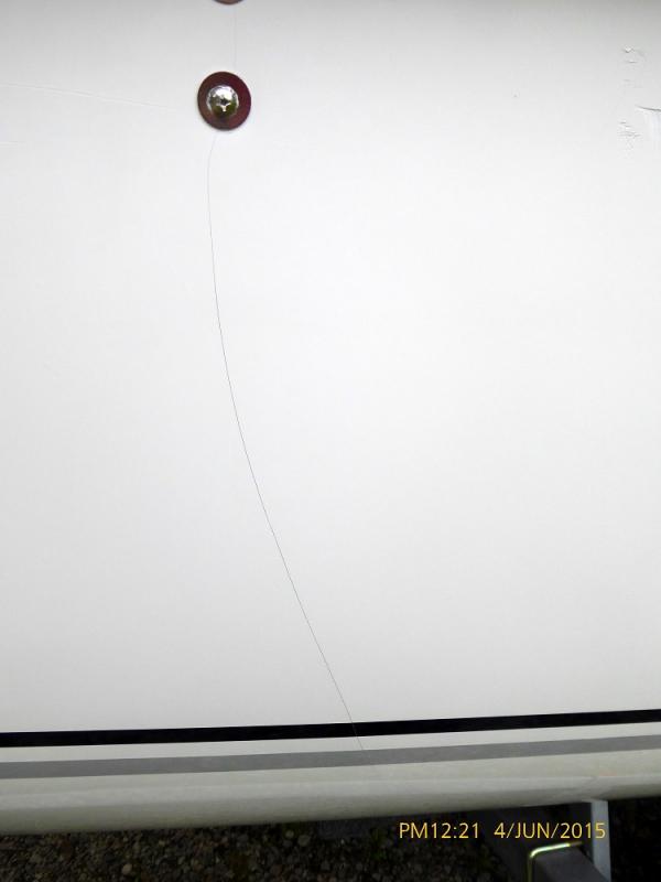

Hello,
Yesterday, as I was washing the Hunter 216 and getting ready to launch today, The last area I washed was the left side and to my dismay I discovered a crack that started at the chain plate bolts and continued down the side all the way to the trailer bunk board. (It was late and the ground was soaked so I didn't climb underneath to see if it came out the other side of the board) I have no idea if the crack goes through all the layers nor do I really understand the actual make up of the layers. I was and am really dismayed.

I hit the wrong key by mistake and did not finish my message.
Does anyone know if there is any way to get Hunter to take care of this or buy back the boat or will insurance take care of it or anything else?? It is obviously a design flaw or if as someone has suggested a material flaw, what is the liability of the ABS source? If there were a dangerous structural flaw in an automobile, eventually the car company would be held responsible. I realise that a boat company is not as big as a car company but with a crack this long, if I had not noticed it, seemingly the boat could crack in half under the stress of sailing in a good breeze.

call your insurance carrier and ask that question. The old Hunter is gone and no one will buy back the boat. Post some photos so we can take a look. With any crack, drill at the end of the crack a 1/8 inch hole to keep it from extending. Drill about a quarter inch in only. In layman's terms this is a sheet of molded plastic over construction foam. WE NEED PHOTOS

I am not very well versed in some things and I have really struggled with getting these pics of my boat. To summarize, it appears that the crack starts at the upper chain plate bolt and runs until it is about an inch from the keel well. There are some ink marks that I put on to make sure the cracks were visible and one to show the end of the crack at the bottom. I spoke to a service manager at a marina and he said he had repaired some much smaller cracks on FJ15's and he suggested using a product from West Systems that he believes is much superior to the plexus. His concern was using Krylon paint underwater. I really welcome all the input that i can get. this looks like a disaster to me and i cannot imagine why Hunter would not want to make it right. I have not contacted them yet to be fair. Thanks in advance.

Hunter Marine is gone. It was bought from bankruptcy and the new owner is not going to address that nor is there any warranty as the boats are way out of warranty. If you want some help here, I repaired enough of these boats and I will be glad to help but I will need a phone number which to call. If not, there is information already in the archives.

I have the crack repaired. Does anyone have any of the gray and blue striping tape that I could purchase a foot or so of?
