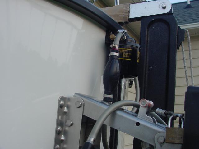

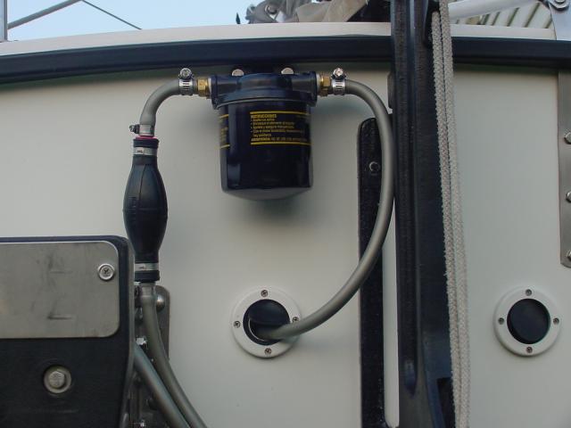

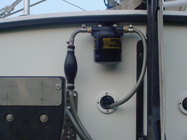

Check for water in the gas. Completely flush the fuel system, there is also a water/fuel seperator on the actual engine that can be replaced, you can bleed the lines by pushing on the small tire pressure looking fittings, and replace your gas with fresh gas if you can - otherwise put some dry gas into the system. Also, Mercury makes a product called 'Quickleen' that will help clear out a lot of the gunk in there - add an ounce to 6 gallons of gas. If you don't have one, add a fuel/water seperator next to the outboard mount - you'll be surprised how much water is in fuel when you can see it and that will allow you to drain it periodically.
