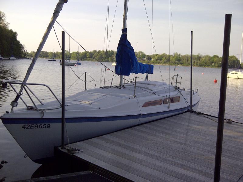

MacGregor 26D London Ontario Canada
I rise my DB when I'm tied up. It lets the boat rock a bit more and if there is a catastrophic water release from the reservoir I won't bust a DB. I've seen the water drop 1.5' in a few hours.
At my dock the water is about 1' deep at the bow and 8' at the stern. About the same slope as the hill I have to walk down to get to the boat.
