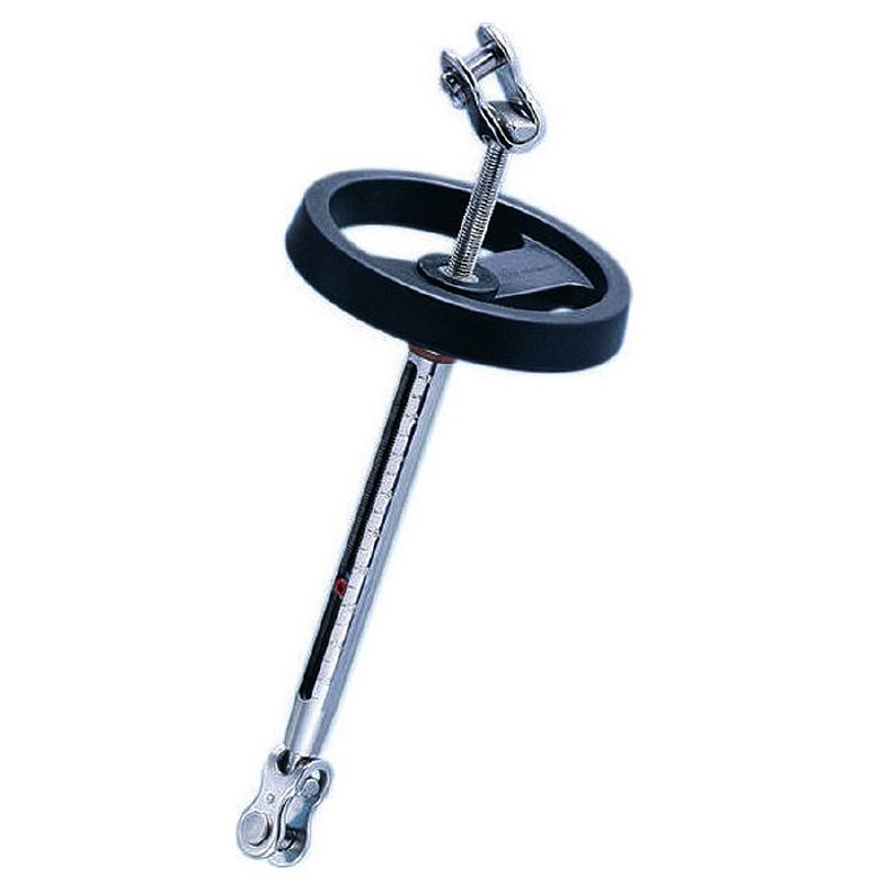

24,759
I have a stiff non bending mast. This does a good job drawing the mast back or easing it to adjust the forestay.
Plenty of adjustment in small increments. Not rapid. If racing a speedier design might be preferable.
