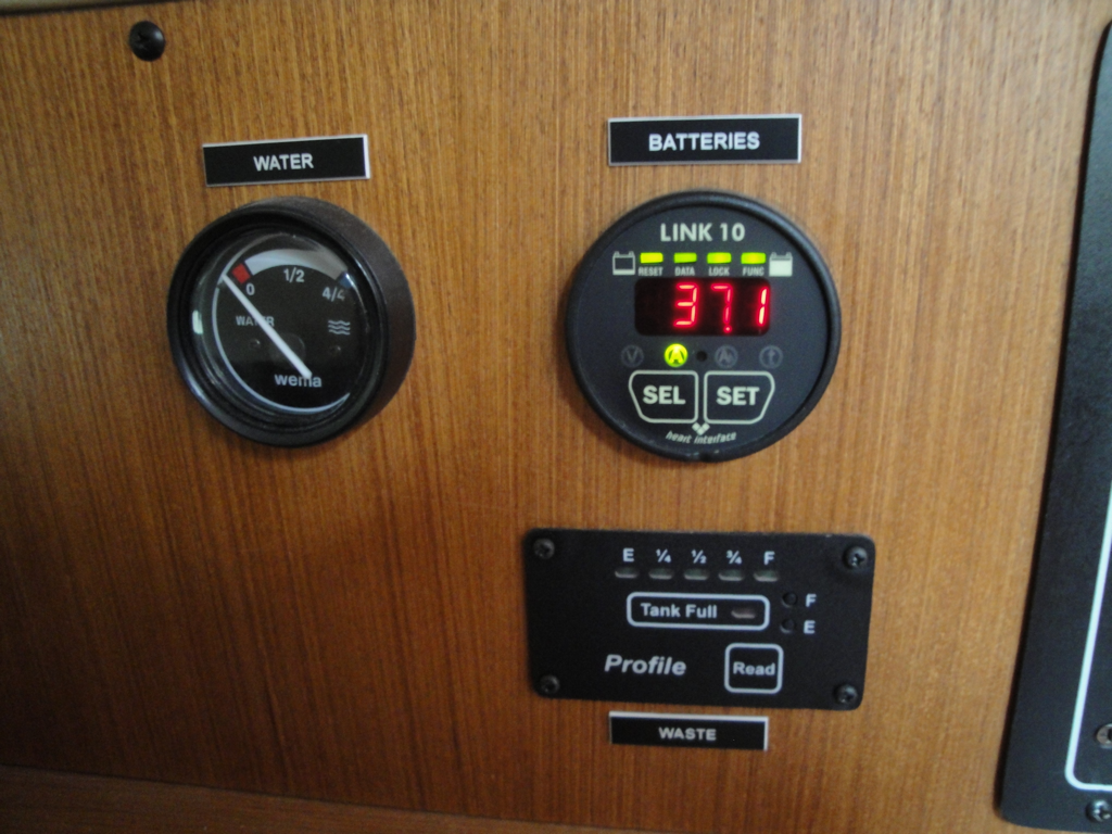

Before even brushing your teeth this morning, consider an external alternator regulator. I most likely have exactly the same alternator as you do, the Hitachi LR155-20B. It faithfully limped along and offered up 10A at 14.2V feeding a 50% SOC battery bank when under full load. Remember, it doesn't have a smart regulator so no bulk charge. I installed a Balmar ARS-5 three stage regulator about 10 years ago and went from 10A to :
at 14.7V feeding the same 50% SOC bank. This may be a bit over the recommended 0.2C charging rate for my battery bank but certainly no problems with the last batteries which lasted about eight years.
Don't remember the cost of the regulator but I'm guessing it is significantly cheaper than the Balmar 110A alternator. Also, I believe the new Balmar will require a dual belt pulley which makes for a fun swap out back to the old Yanmar (should the new Balmar fail) while away from home.
