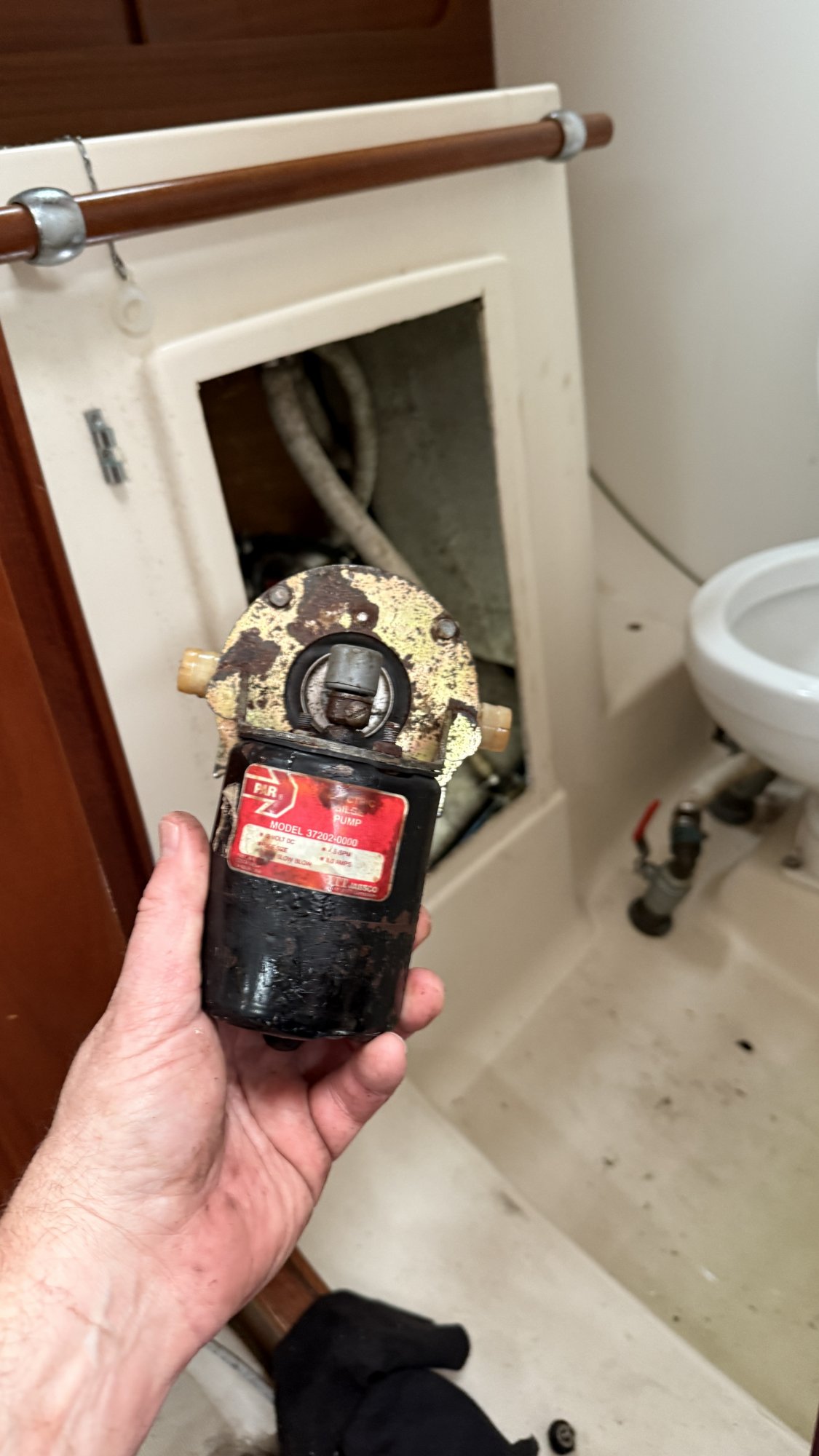

Hi all, does anyone know of an easier smaller replacement pump than this for a 98 Beneteau 281? At 6 foot 3 it is very difficult to get into the head and under the sink and hold this up and install. Thanks

Is that for the main bilge pump or the shower sump?
It may be possible to move the pump somewhere more convenient, at least to a different part of the cabinet or storage area it’s in. Diaphragm pumps are generally self-priming so they don’t need to be below the level of the water or anything like that.
