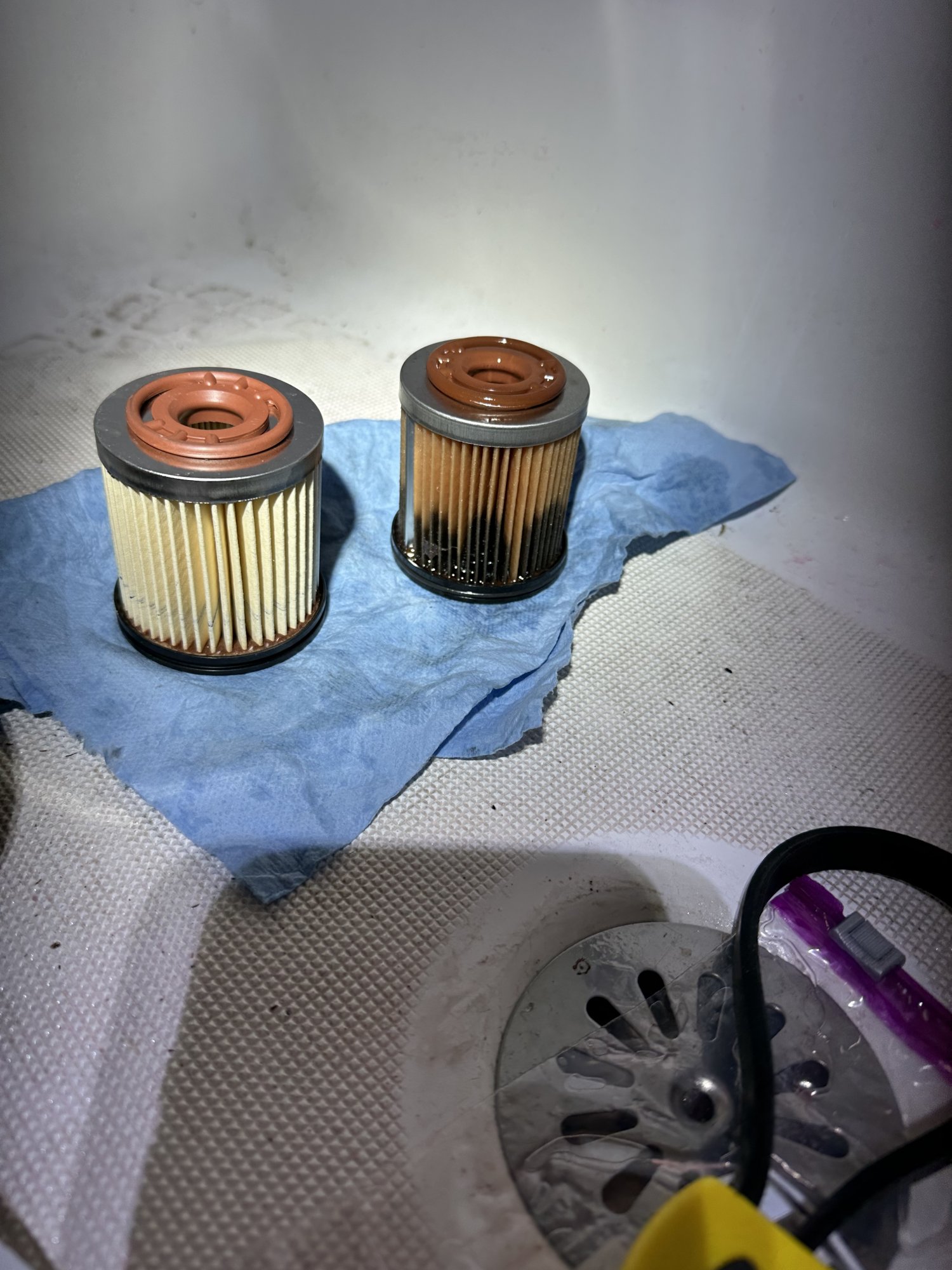

As a data point, here is my filter when I changed it a couple weeks a (new on the left, old on the right) -
The boat is a 2014 and the filter was last changed in 2015. I drain a little off the bottom of the bowl a couple times per year and have never seen any water in that, and I’ve never had any power loss. The way the filter is discolored at the bottom I suspect trace amounts of water sat in the bottom of the bowl and wicked onto the filter, providing a place for bacteria to grow in the housing itself.
Somewhat unusual to see bacteria growing up the filter like that but can't think of any other way it got like that. I think I've only changed primary elements two or three times in 24 years. The element always looked new. Maybe I'm just lucky. Maybe clean fuel. Maybe the biocide and checking the tank for water every few years. Or maybe all of the preceding but it seems to work.

What filter do you have? I found a spare filter element that looks just like, but I don’t think it fits in my old Groco fuel filter housing.
Curious why the PO had it on the boat,
Greg

My old Groco filter doesn’t have any drain or water separator. I replaced the filter around 2015 (I bought the boat in 2014). Old Filter looked new.
I pulled it again recently and it was a little brown, but not dark. I put it back in and made sure I have a new spare on hand in case it needs to be replaced.
My tank doesn’t have an inspection port…need to add one sometime just so I can see what is in the tank. For now, will pull the filter out annually and see how it looks.
