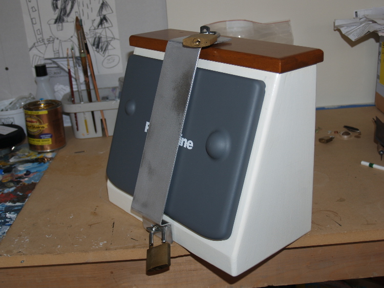

I built my own chart plotter housing when I added the plotter and radar to our boat. I bought the plotter on ebay and when it arrived, there were signs that led me to believe it had been stolen. This made me think I should build the plotter housing with a way to lock it in place. It's not Fort Knox, but it will make a thief look for an easier target. With the cover on and locked, there's no way to pull the unit off the boat and difficult to open the chip cover.
