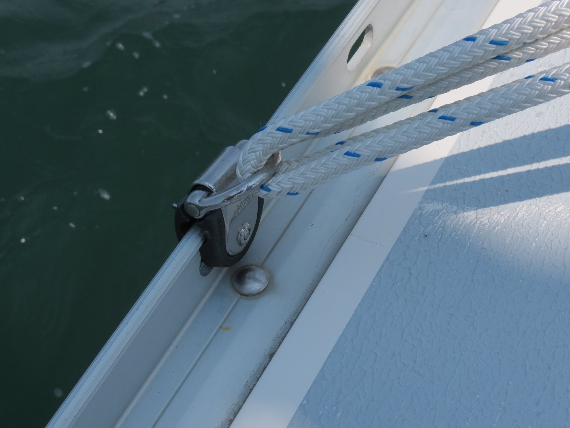

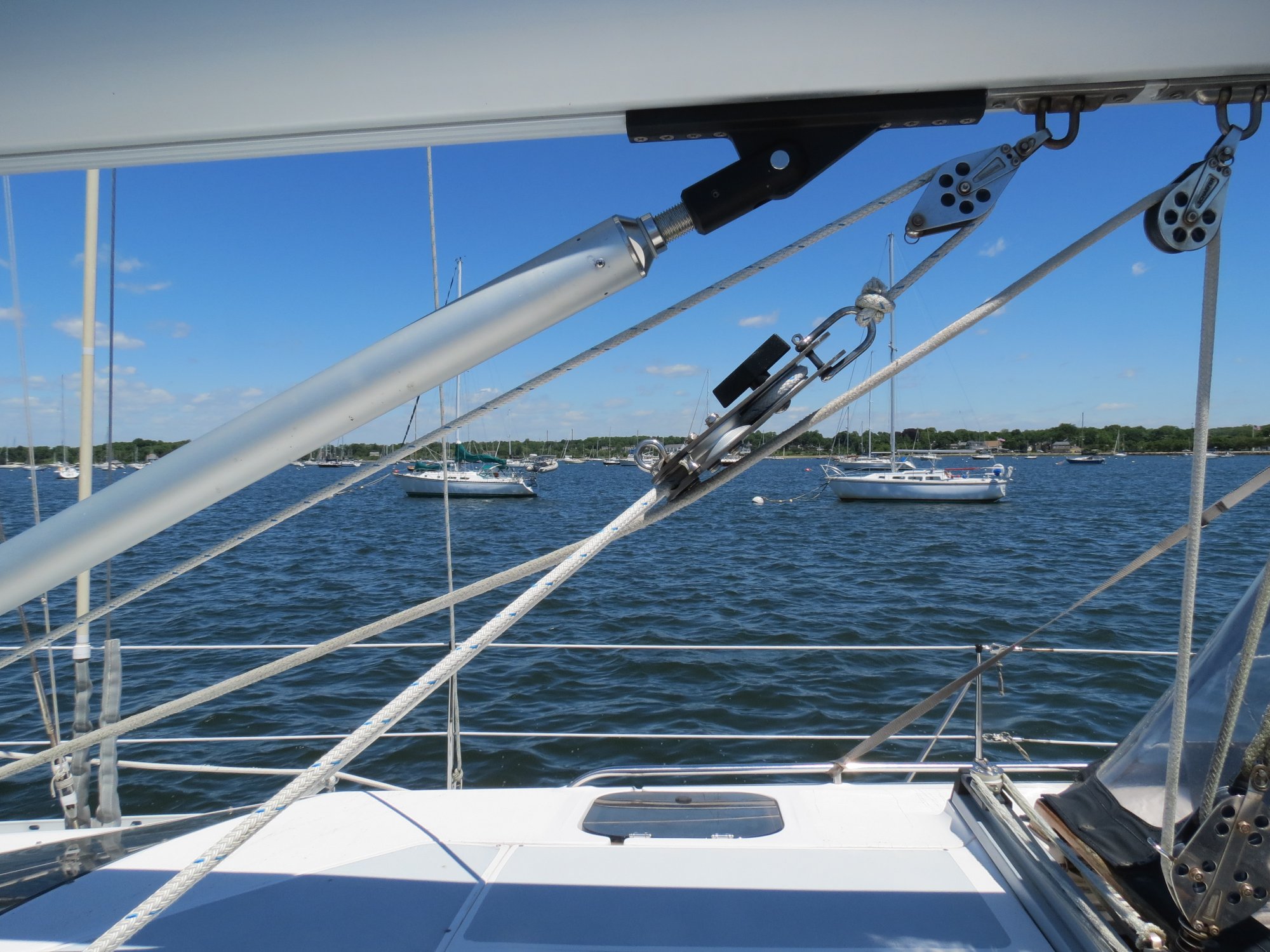

I use a Dutchman Boom Brake, model BB500 on my h40.5. This boom brake utilizes a line that is tied from toe-rail to toe-rail. This brake line is threaded through the brake mechanism and it provides the friction to control the boom movement athwart-ships. The location of the toe-rail attachments is determined so that the boom brake traverses a constant radius arc from side to side. This brake mechanism has an adjustable friction device that increases the friction on the brake line and controls how fast the boom is allowed to traverse from side to side.

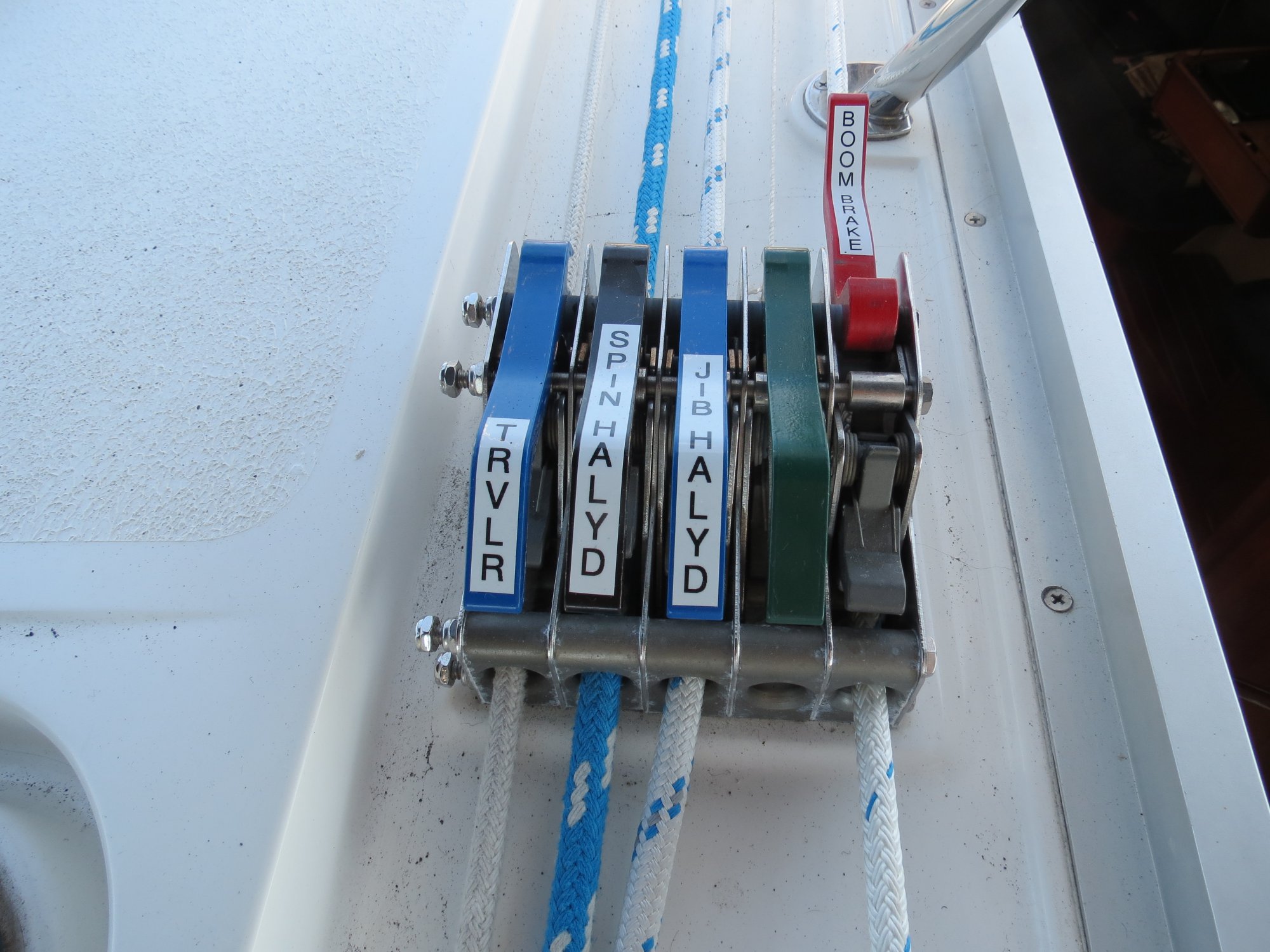

Additionally, there is a single control line that attaches to the boom brake and is run back to a cockpit winch. It's purpose is to pull on the brake mechanism and tension the brake line in the brake mechanism.
This system offers two functions. First and foremost it controls the boom in a gybe situation and slows the boom crossing to a very slow safe rate. And second, if the boom is out on one side , like in a downwind configuration, the brake can be tightened to the point that it will not allow the boom to move at all- essentially providing a preventer function.
All of this is controlled by a single line lead to the cockpit. The friction device on the brake is generally set once and does not need to be re-adjusted for different situations. See the attached pictures -

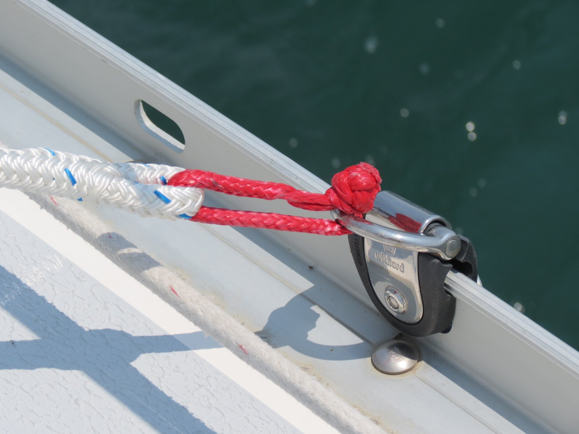

We have a Wichard Gyb'Easy. It is not a preventer, it simply slows down the boom as it crosses over. Works well, I can easily jibe the boat by myself with the autopilot.
It is attached to the boom with a ¼" dyneema strop with a continuous line running from port side of the cockpit to the starboard side. Two blocks attached to the chainplates guide the line back.
