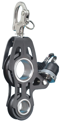

I have been thinking about this too, as well as a temporary downhaul for my spinnaker pole. Ideally, If I could make both sides the same, then no matter what side I have my boom and spinnaker on during a downwind leg I could rig them up. On my track for my genoa sheets, I have some movable cleats that I think I can use to attach some line and run that to a block similar to those on the mainsheet. I did read that the line should be the same size as your main sheet as the loads will be similar. I have an old fiddle block with a cam cleat that I may try and work out. Also I did read that the preventer should be attached to the end of the boom, although where the main sheet it attached should be fine.

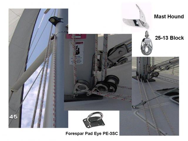

Poliva, I am curious about you pole setup. I went with a fixed ring because it looked like a track went straight up the front of my mast (I have a 2002). With a fixed ring I could get around where it looked like the track was. I went with a spinnaker pole because I got a great deal on some ends and decided to go for it. I am also interesting in using an asymmetrical spinnaker off of the pole.
I realize the best place for a downhaul would be somewhere at the base of the mast, and I am thinking on that as all of my blocks and pass backs are full. Last fall during a race on a downwind run, I noticed puffs were lifting my pole (I was just flying my genoa) a little, and so my plans to add a downhaul were accelerated a little.

It might take awhile before I rememeber to take a picture of my track and the system for raising and lowering the car. Mine's a 2002 as well. Hull 179. Yes, the track runs up the front of the mast. The pole is a Forespar such as http://www.westmarine.com/webapp/wc...L=true&storeNum=2&subdeptNum=341&classNum=342 and the female end of the pole snaps into a male car such as http://www.westmarine.com/webapp/wc...true&storeNum=2&subdeptNum=341&classNum=10899. It's a reasonably common arrangement, though more expensive than the fixed-ring option.
You could use an asymmetric with the tack at the pole, but the hassle of the pole defeats the ease of use (and lack of pole issues) by using an asymmetric. An asymmetric doesn't require the more complex rigging of a pole-controlled symmetical spin (no spin topping lift, no foreguy, no afterguy).
