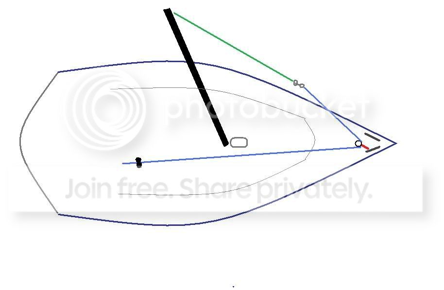

I've searched the archives for 'preventer' and it appears that only older Hunters with attachment points on an aluminum toe rail are mentioned. Does anyone have a solution as to where to attach a preventer on their boats that have a non-utilitarian fiberglass toe rail with no attachment points. I'm not sure I trust a stanchion for any emergency load, nor the little 'eyes' that the jib furler line runs through. Anyone have a solution? There IS an attachment point available on the boom where the rigid vang attaches on the underside at least. Ideas?

Wow, I was wondering the same thing after slugging across the Chesapeake a few weeks ago. Will have to rig up the Alexventer.... very simple idea
