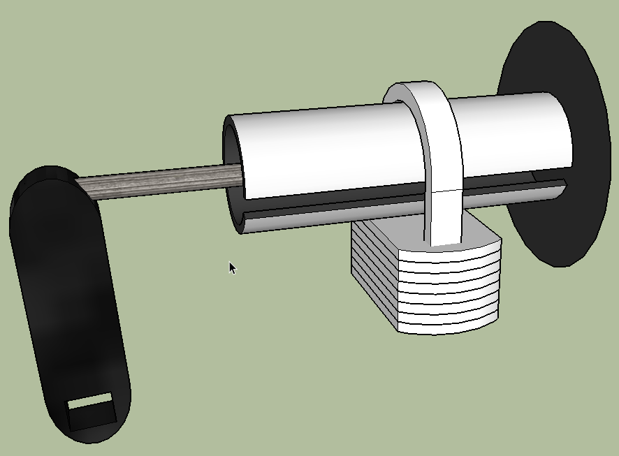

A piece of pipe and padlock might prevent a thief from cutting through the threaded part of the clamp. If you were to weld the lock hasp all the way around it'd difficult to get some bolt cutters in there. You will never be able to stop a determined thief. Your goal is to make it difficult enough so they wont want to take it

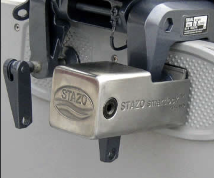

We do as Rick486 does. But we use the the "bar" style motor lock. It's sort of a square "C" shaped metal channel that slides over the motor clamp handles (they need to be turned until they align horizontally), and incorporates a keylock that is sort of hidden inside the "C" channel. It's simple and a big step up from a basic cable lock on the motor. The lock and the relatively weak clamp handles are enclosed in a much stronger steel protection sleeve.
Yes, exactly our rig also. Makes our dinghy look tougher than most, as is yours, so the bad guys look elsewhere.

I have one of the Stazo locks. I carefully lubricated it every year but one year I forgot and it corroded locked. After lots of treatment with PB Blaster, I broke the key off deep in the "pick proof" lock. I'm going to try to ease the broken key out but if that fails I'll have to go at it with heavy artillery. So great lock but don't forget to grease it.
