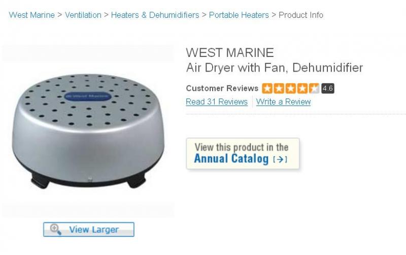

I find that the heat from two 80 watt "dehumidifiers" (now there's a scam) AND the heat coming from the water under the hull are sufficient to keep the interior temperature to 0 deg. C. or slightly better. During our last cold spell of -11 deg. C (a relative heat wave on the east coast) I found the interior of the boat was 0 deg. C with an outside temperature of -9 deg. C at that time. Given the surface area of the wetted hull, I wouldn't be surprised to find the hull is the major source of heat within the cabin. I find this is more than enough to get us through our short cold spells.
