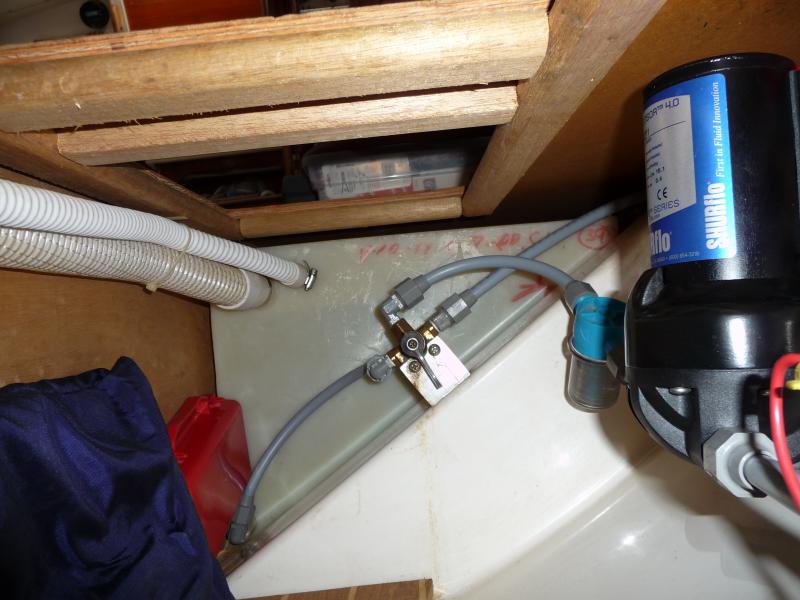

I have never drained the tanks.. but they don't freeze here. Peggy's commissioning process is excellent.. There is no accumulator in the system unless a previous owner has added it. The pump turns on and off by a pressure switch. There is always pressure on the system, like at home, when the power switch at the panel is on. again NEVER turn the 110V water heater switch on unless there is water in the tank and pressure on as well. The pump and tank selector valve is in the port side locker under the settee.
EDIT:
The picture is looking aft in the port settee locker. The pump is the black thing on the right in the picture, The forward water tank is the thing in the background with the white hoses attached in the top left..one is vent, one is fill hose. The tank selector is in the center of the picture with the gray pipes hooked to it. On my 34, the valve pointer points to the top fitting for the forward tank as it is in this picture. The aft tank is selected by turning a quarter turn clockwise so the pointer points to the right fitting in this picture..outboard on the boat..

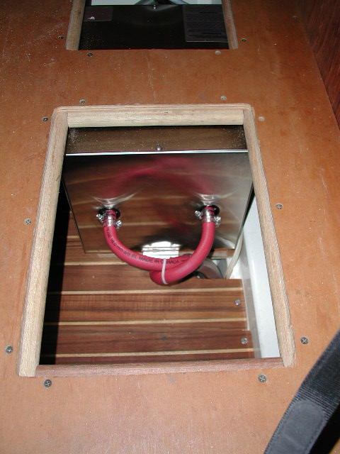

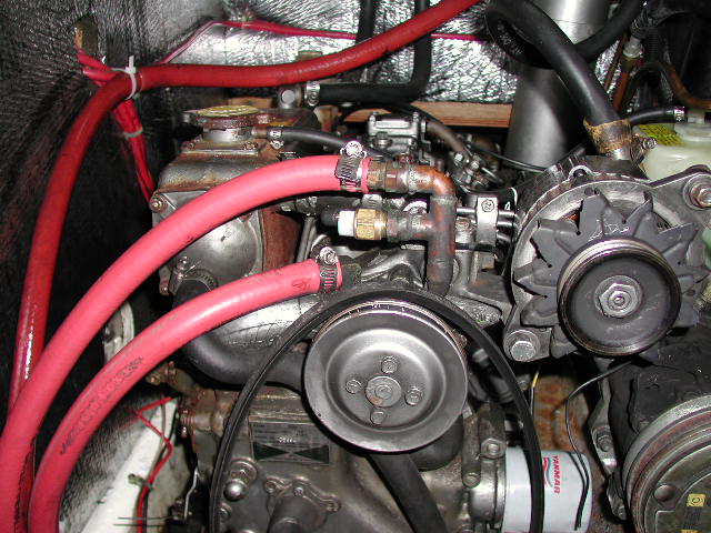

Attached is a crude dwg of the hot water heat exchanger from the engine. Picked up on Google and no author to credit. Also 2 pictures of the loop hoses as set up on my boat. Lastly, the 110V element (not seen on dwg) is just a regular element as seen on many household water heaters and can often be replaced. Depending on design and brand it might be found in the plumbing department of hardware stores. The heater shouldn't be run on 110V when no water in the tank.

Claude A...
Is that a custom copper "T" set-up coming off the top of the engine's internal system water pump?
