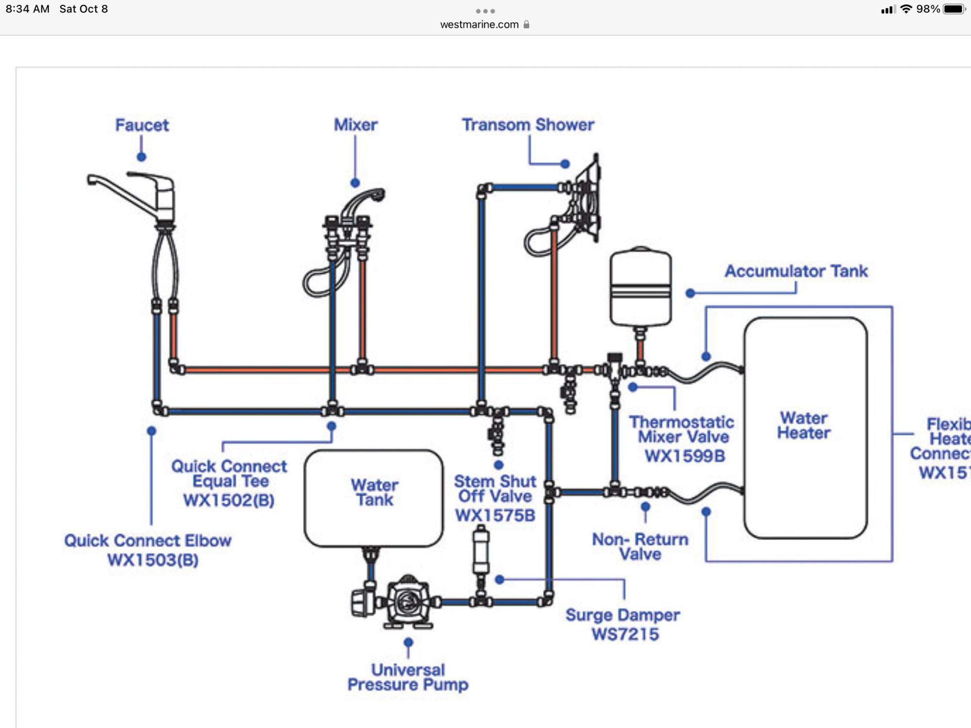

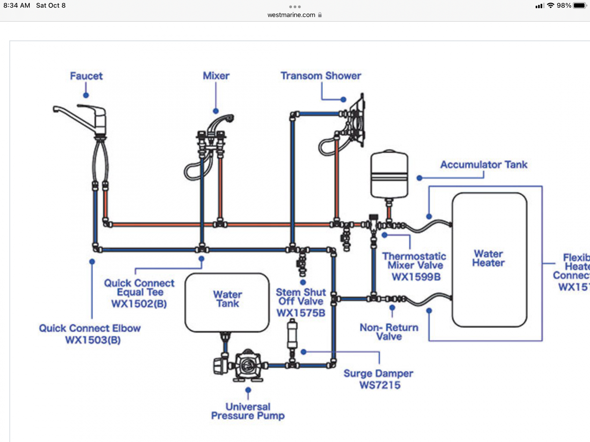

You might have an accumulator tank…maybe not working well. Mine delays the water pump for a short period if I open the faucet all the way…if the pump is off, I get a fair amount of water from the faucet before it finally drips out.
Also, if you were blowing into the “distribution system”, you were pressurizing the water heater…and if you opened the hot water tap on the faucet, you would be emptying your 6-gallon water heater before running dry. This assumes you didn’t by-pass the WH. Depending on your plumbing, you may not even need to open the hot water tap…

Be careful with compressed air in this situation. You could rupture a tank.
