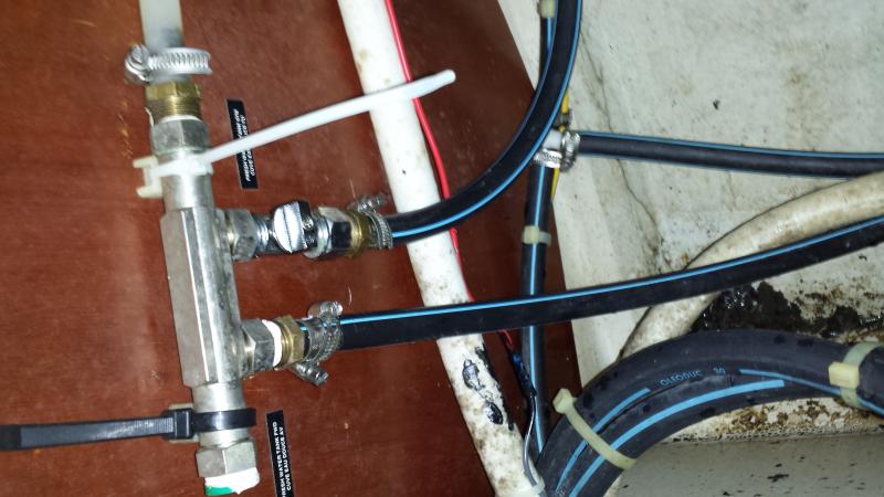

The mystery continues.... after spending the last week on the boat and occasionally tinkering with the pulsing pump I've determine it's on the suction side and only when the front tank is selected. Each tank has a ball valve and when the starboard tank is in the off position and the front tank is on does the problem exist. To make for more mystery I've removed the valve... it continues to pulse. I've disconnected the line to the front tank at the tank... it continues to pulse. I've traced the water line all the way to the tank and it looks great. I've attached a pic that shows the manifold where the two lines meet, after each valve. Note the pic is with the forward tank valve removed. I'm about ready to replace all but thought I'd throw the mystery out for those brighter than I.

Take the line loose at either the tank or the pump and block it off. On the other end put a threaded shraeder valve And pressurize it with a small hand type bicycle pump. Then if there is a leak, it will be evident.
I don't think that is your problem though, but it will settle the question of intake side leaks..
10,066
A piece of debris in the pump discharge check valve.. Disassemble the cap of the pump and clean it out.. You may have some other problem on the suction side, but for the pressure valve to repeatedly call for pressure, the pressure in discharge has to be going somewhere.. if not a leak, then the check valve is letting pressure back to suction side.
