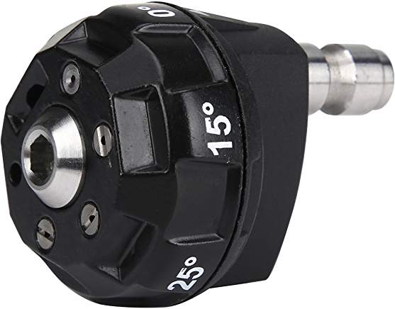

You don’t mention what else you want the PW for... I have a gas engine driven PW, 3,000 PSI. I mostly use it for chores around the house.
I have a multi-head nozzle...I can switch quickly and without tools.
For me, the higher the PSI, the better. And I can use the adjustable tip to make the pressure less damaging.
I have almost written my name in my deck boards trying to clean them...so you do have to be careful.
I have used mine on my boat before, but I am careful to stay away from teak, caulking, etc.
If I ONLY was going to use it on the boat an electric one may be OK. But for me, higher PSI gas driven pump works better.
