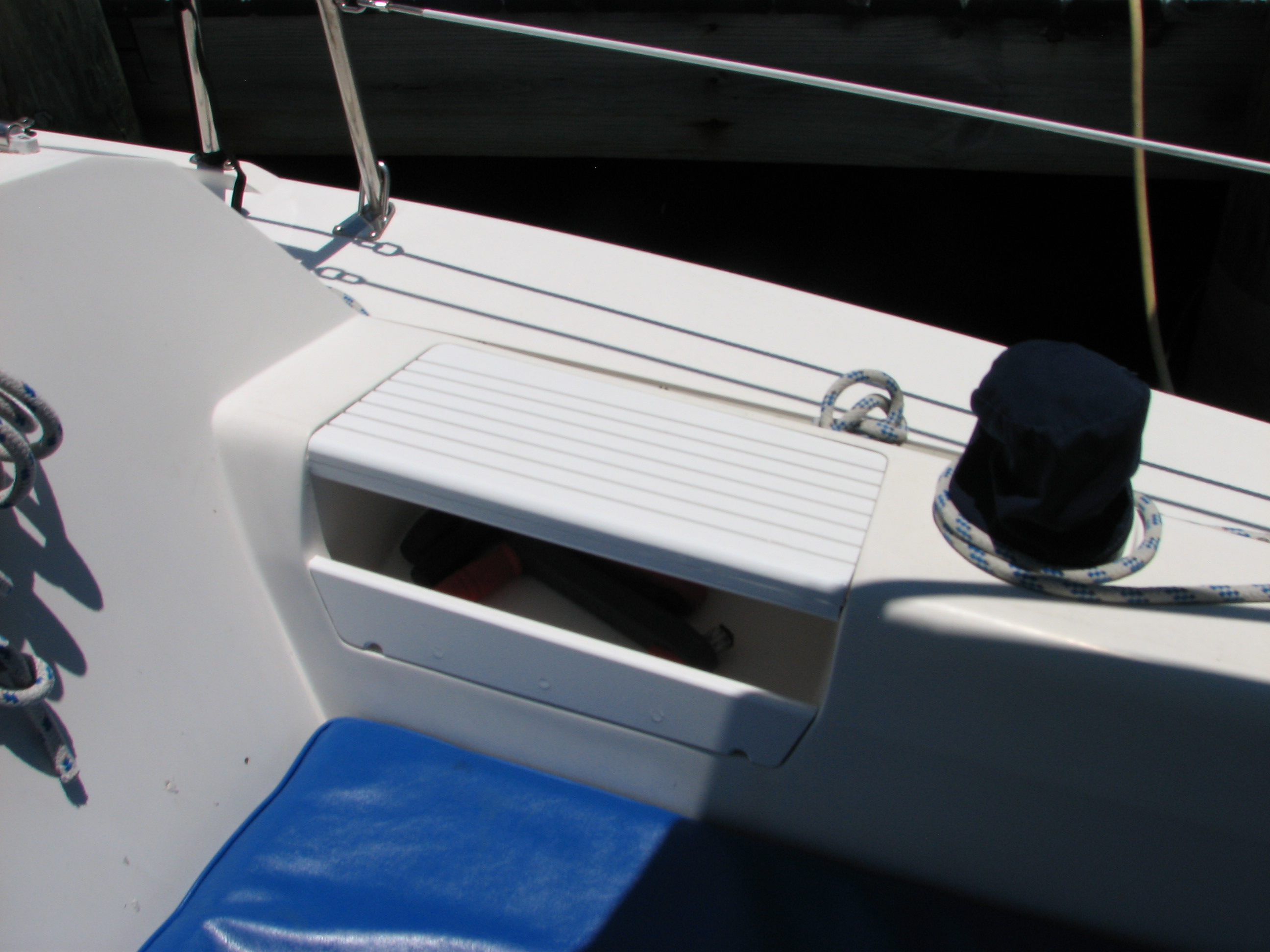

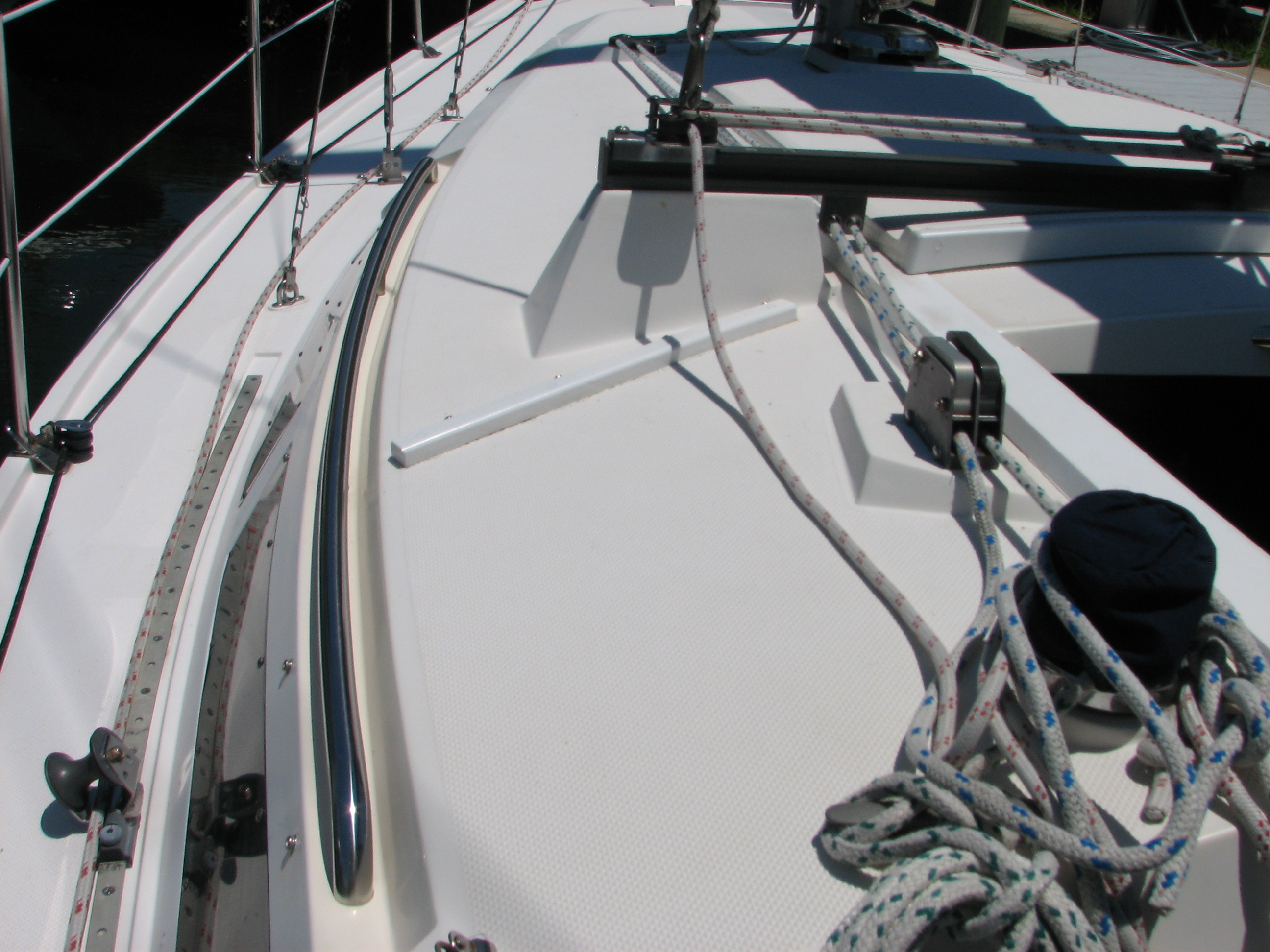

I was thinking from the beginning these would have to be replaced rather than rehab. Since I like sailing the boat more than woodworking I was hoping there was an easier fix. Winter project I suppose. I replaced most of the exterior teak on my Cat22 with a composite material and stainless grabrails. I detailed the project in this post: https://forums.sailboatowners.com/i...terior-trim.187587/&highlight=low maintenance
