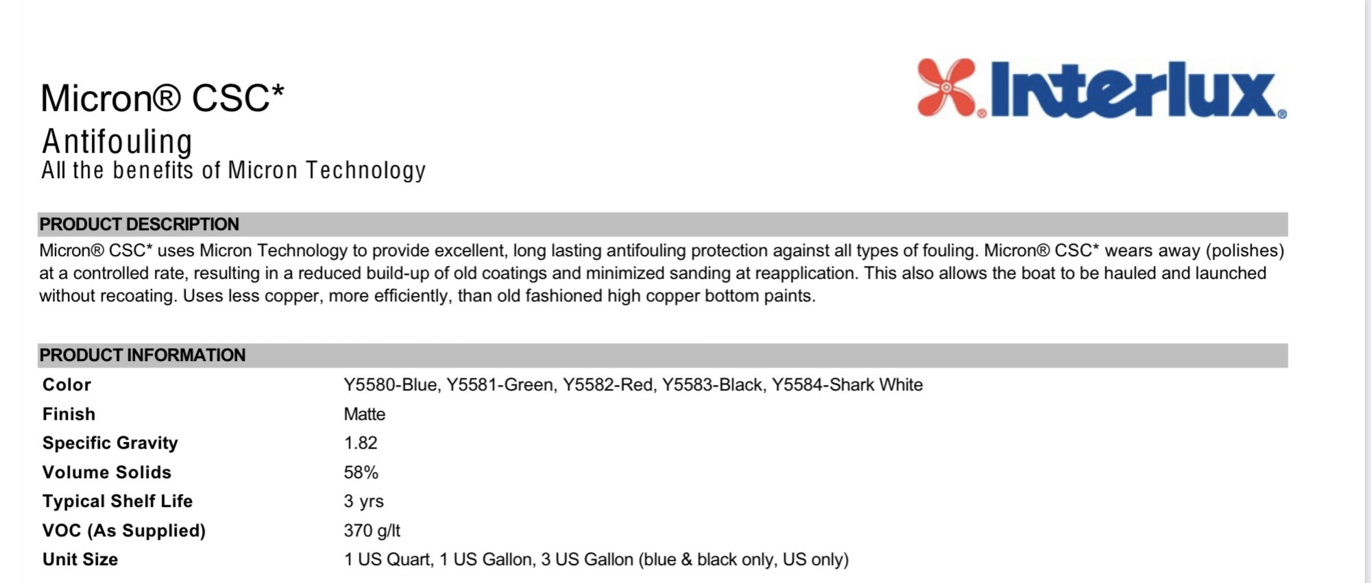

The product has a certain lifespan and as the literature says it “wears away at a controlled rate“ however they conveniently leave out how fast that is :)
