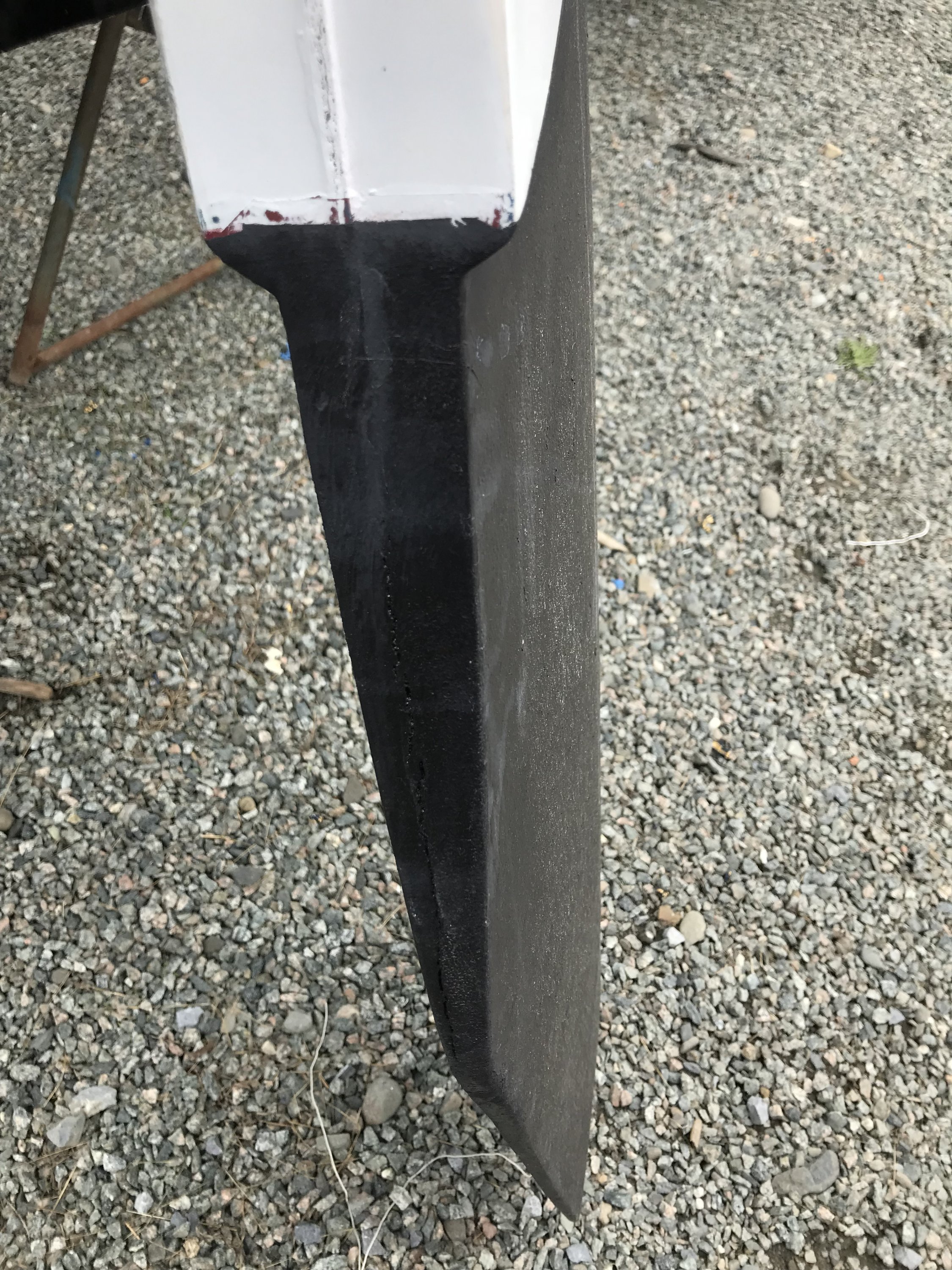

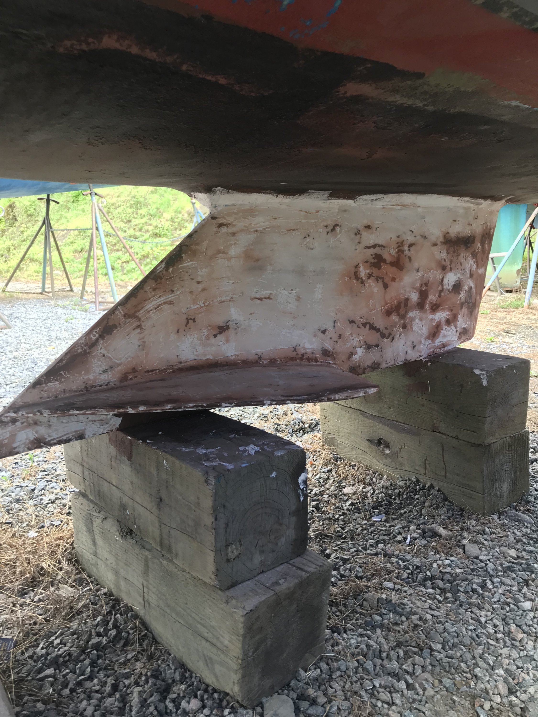

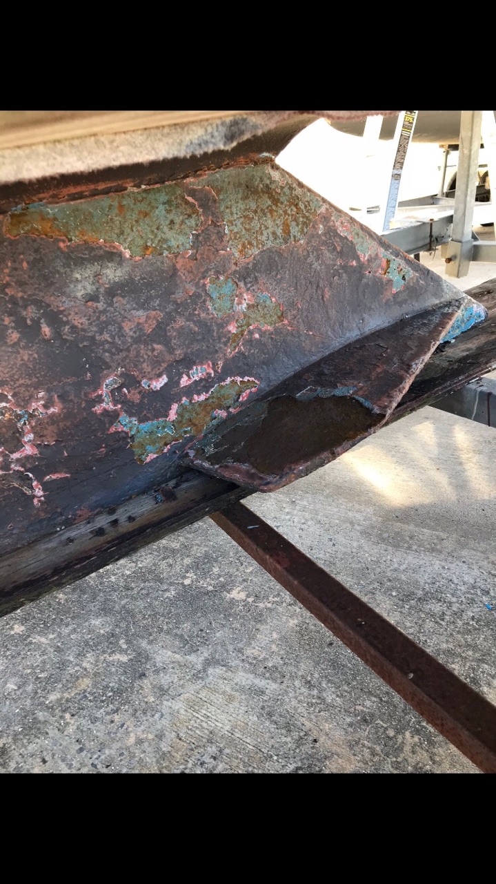

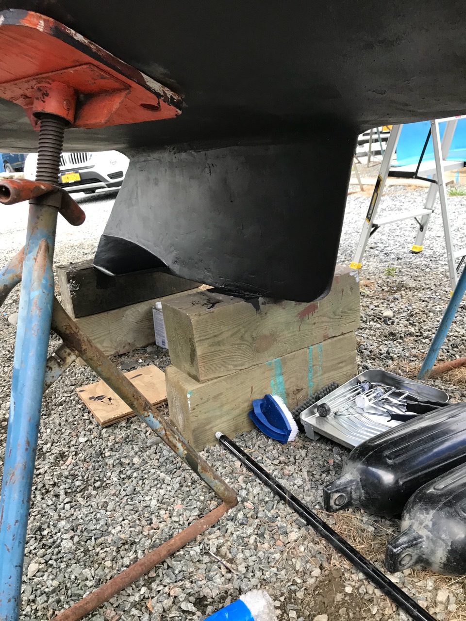

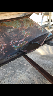

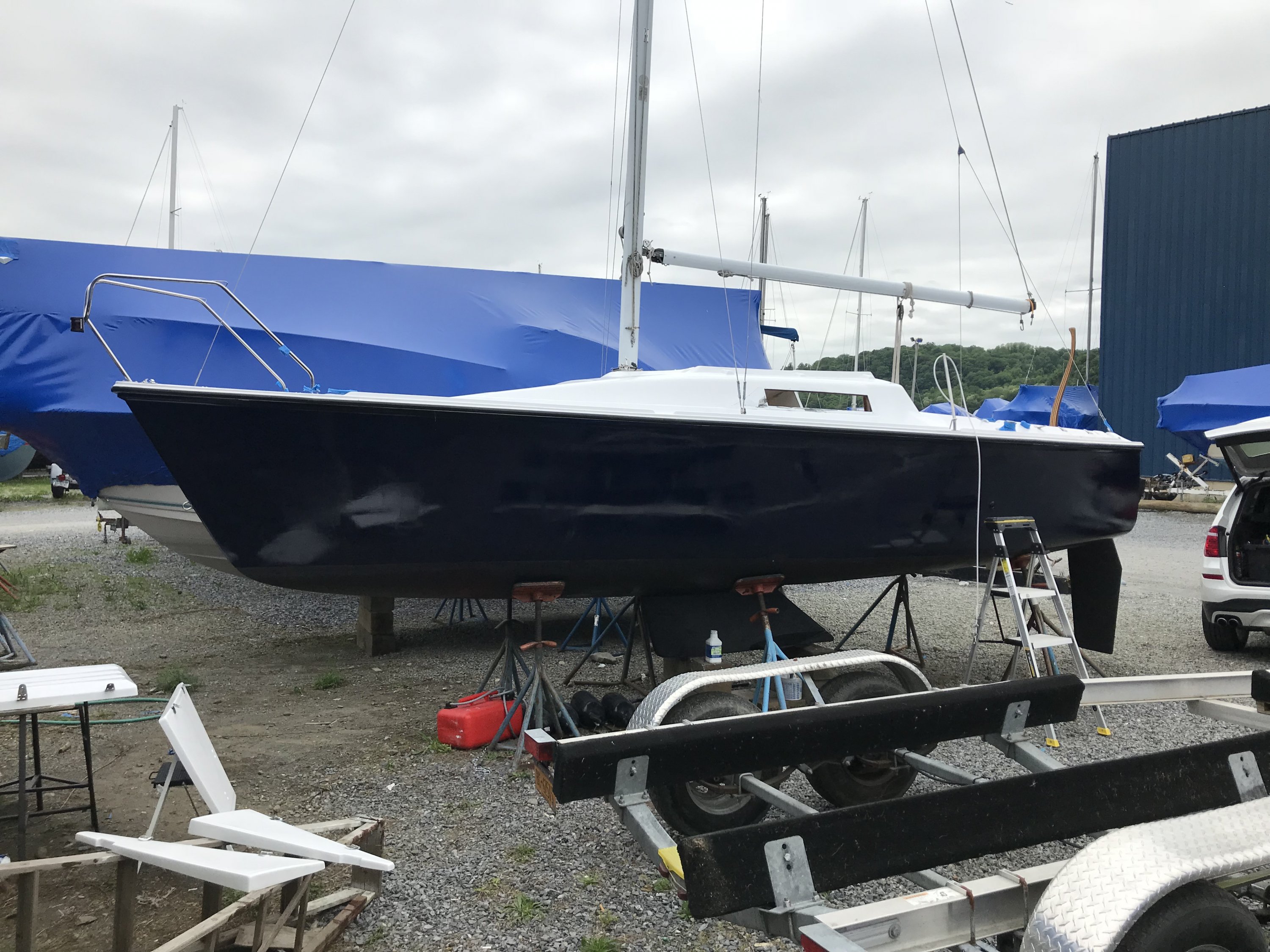

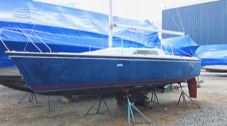

Ive stripped down most of the 30yrs of paint off the keel. I plan to seal it this wkend using a metal paint primer then fair it with a interlux filler.
Questions please :
KEEL PREP/ PAINT
- What product should I use at the seam of the keel to the fiberglass? An epoxy - or a easy to use premix would be ideal. Im figuring to just then paint with bottom paint antifouling.
TOPSIDES

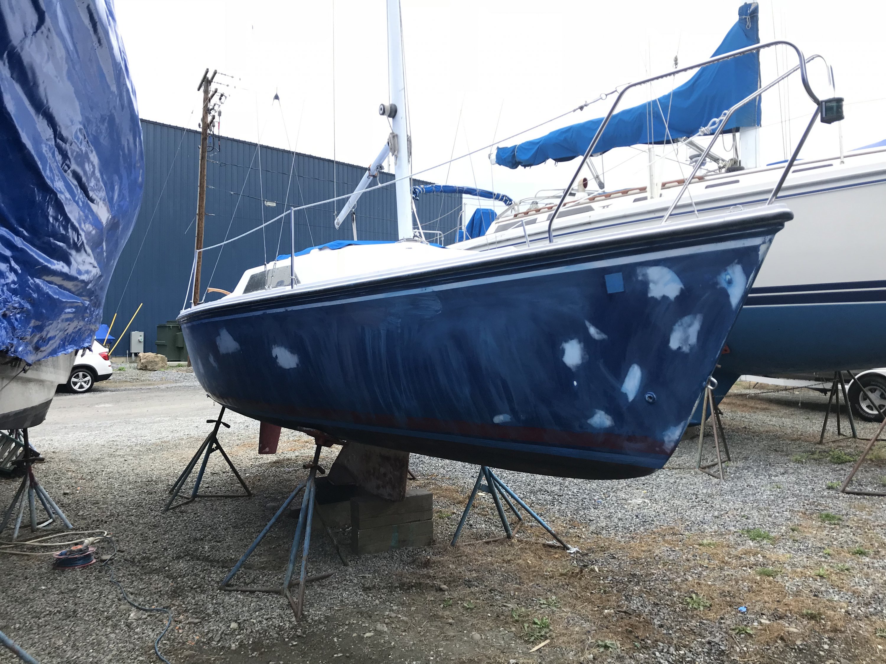

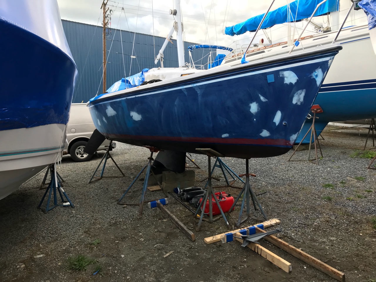

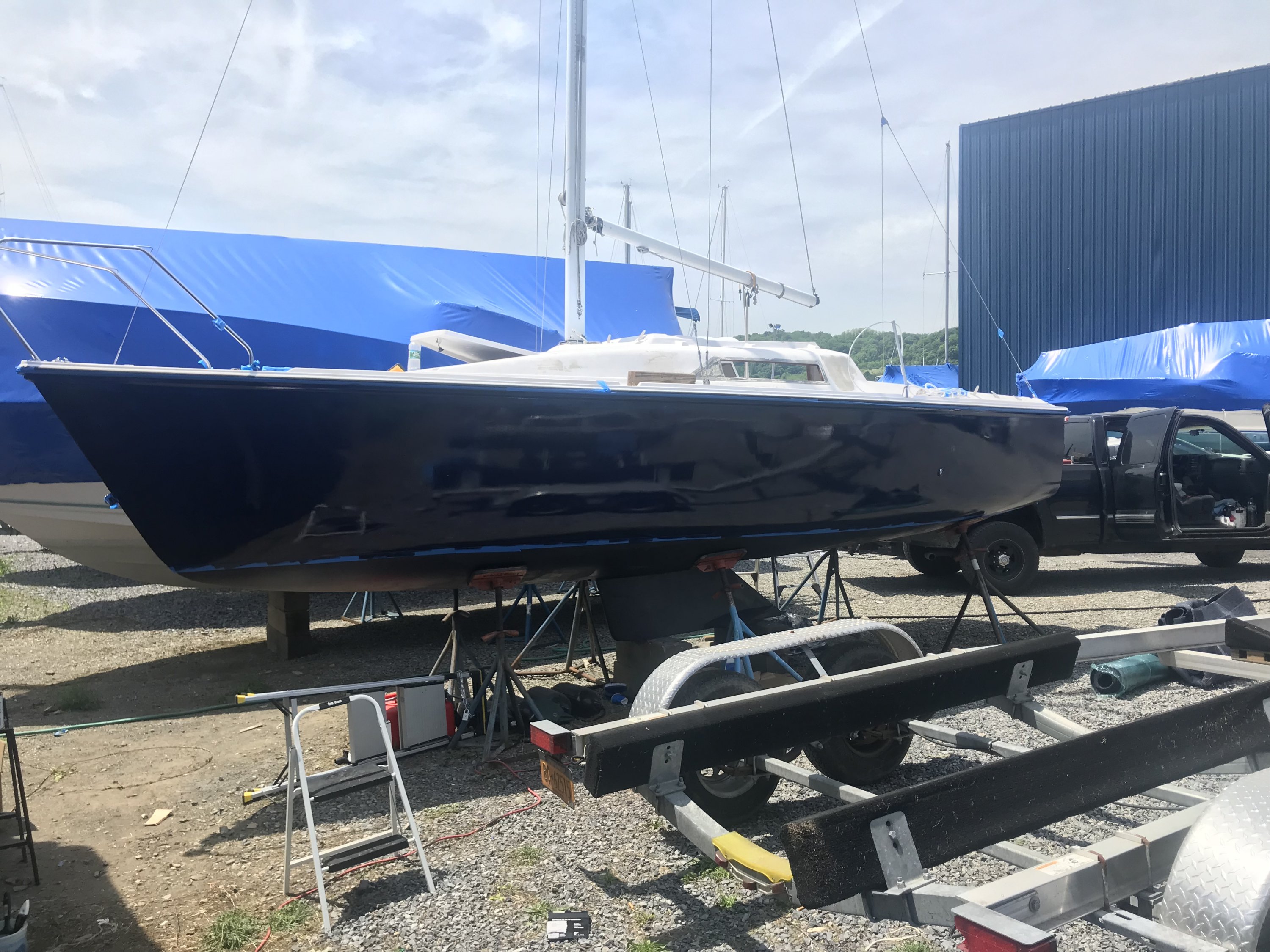

We’ve sanded down with 80 most of the current paint - cleaned with 333 - And will sand with 120.
What primer (or do I need a primer?) should I use on the topsides?
I have interlux blue that I plan on doing 2 coats with - rolling and tipping - sanding the first coat with 220 post curing.
In pro photos attached and Ive removed mucg more of the ancient keel paint since these photos once we got it onto the jacks.
