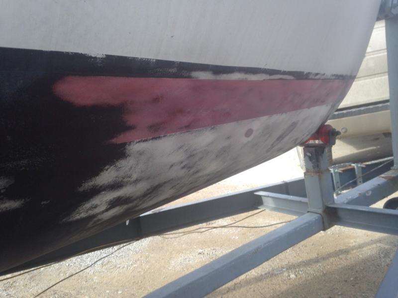

I am planning on painting the entire boat starting with everything below the rub rail. I took a pressure washer to the bottom paint and believe I was too close with too much pressure as the paint came off pretty good but also chips of gel coat came off in a feel places as well. You could see the fiberglass mat. Do I need to sand all the way down to the gel coat?
Oct 17, 2011
2,809
Ericson 29 Southport..
Yes. You'll really need to get bottom paint out of the way in order to effect a repair on the bad spots. Barrier coat on top of that wouldn't hurt.....then..your bottom paint.

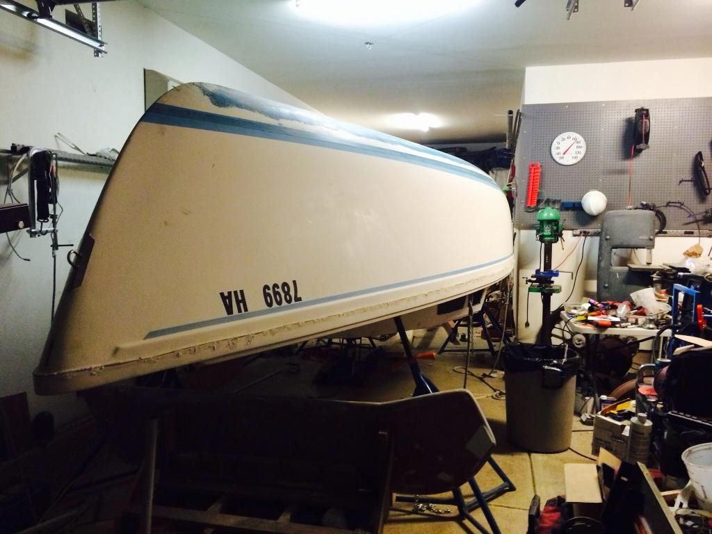

I just ordered the bulk of the paint I will be using on my C22 hull (all from SBO). Interlux Interprotect for the bottom, Interkote to prime topsides, 3 quarts of Brightsides in Steel Grey for sides, one gallon Brightsides in white for deck, cockpit. I will order the non-skid and bigekote later.
I am using 2 engine hoists (cherry pickers) to flip my hull. I'm actually planning to flip it tonight after work with some friends coming over to lend a hand. I have a dust control system attached to my shop vac which plugs into my orbital sander and 3 inch belt sander. This tool is amazing for keeping airborne dust under control while not clogging up the shop vac's filter. All this is in my resto thread on the C22 page.
I know the hull had been painted before as it is not the original color as far as I can tell. I don't expect to find too many blisters on the bottom, but I do expect to possibly find evidence of previous blister repair. Anyway, I went over this entire paint plan with my local Interlux rep prior to purchasing and hashed out the correct products to use for each application. I won't be racing (yet), so I will chose a bottom paint at a later date, for now it will sit on the stands with the Interprotect after it cures and flip the hull back upright to paint the topsides.
