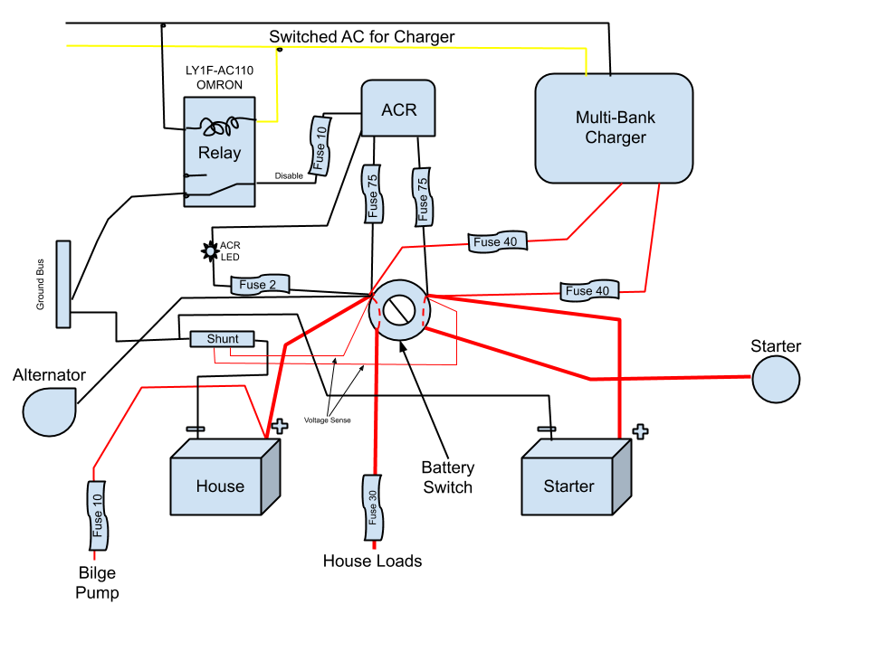

How is it physically wired in regards to the shunt? Where is start batt neg? How close to house bank neg is the shunt? Can you post a photo of the house bank wiring? Again you’re looking at more cycles before it “learns” your bank and hones in better.

See wiring diagram below:
  • Distance from shunt to house negative is about 1'-2' (the shunt is as close to the bank as possible)
  • Distance from shunt to negative bus is about 4"
I do have an Bluesea ACR, that will combine when charging (with the Bluesea "parallel on" master switch) if that would have any impact? I can post a picture later today, but it will be a little hard to see because of the batter bank and shunt location on my Hunter (requires some yoga to get at most things).

Voltage sense, for house, needs to directly sense the battery positive terminal not the battery switch..... Also with 75A fuses on the ACR, and what appears to be a DCP battery switch, you will want to be using the SI (start isolation feature) feature or you may eventually trip one of those fuses.... I will assume there are no other neg/ground wires on the battery side of the shunt other than batteries the house bank is in parallel with? No bilge pump negative or any other neg wire on the battery side of the shunt. Don't know why you are switching off the ACR with a multibank charger as the ACR will do that job just fine with the charger feeding house directly.

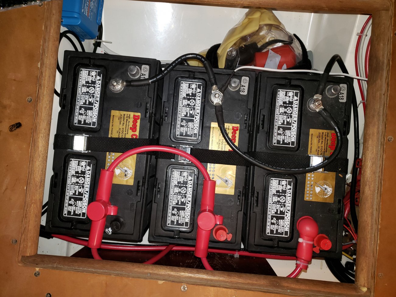

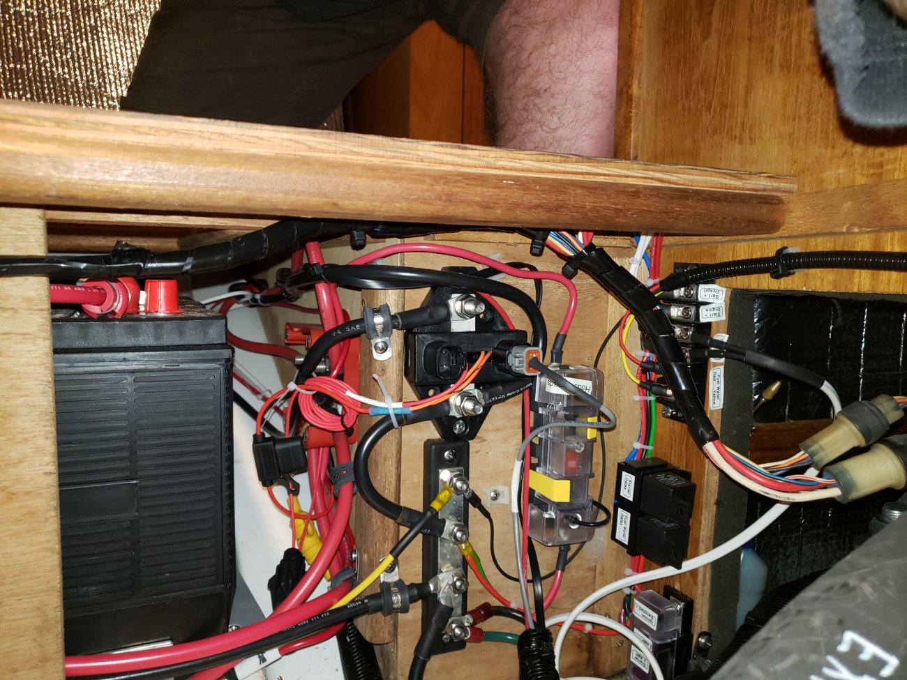

Here are some pics. The low angle picture shows how close the shunt is to the bank. Battery wire are all short and direct to the batteries.
  • Start Isolation is installed, but not on diagram
  • There is nothing on the "battery" side of the shunt except the battery
  • Switching off the ACR when the 1240P is on seem'd like "an (good) idea" at the time, but I agree with your comment that is doesn't have much value.
I will move the house "Sense" wire directly to the battery. Are you suggesting this to avoid any voltage drop? or just to keep it "always connected" to the battery?
Again today, with a discharge down to 65%, once all load was removed, and waiting enough time (> hour) , the SoC went from 65% to 45%. The SoH still remains at 90%.
