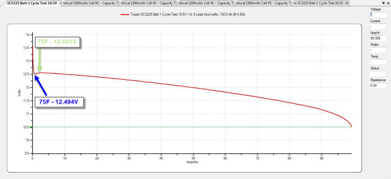

^^^^ 41F to 46F is not going to yield a good indication of battery health.. Also flooded batteries will initially sag and then rebound a bit once the chemical reactions stabilize under load.. See discharge graph below...
Here is a 130Ah rated Trojan SCS-225 under a 6.5A constant-current 20 hour discharge test. This battery was being tested at approx 75F. Note the initial voltage sag to 12.494V and the rebound to 12.601V once stabilized. The batter tested here, 99.4 Ah out of a 130Ah rating, passed the 50% of "actual capacity" threshold at 11.994V.

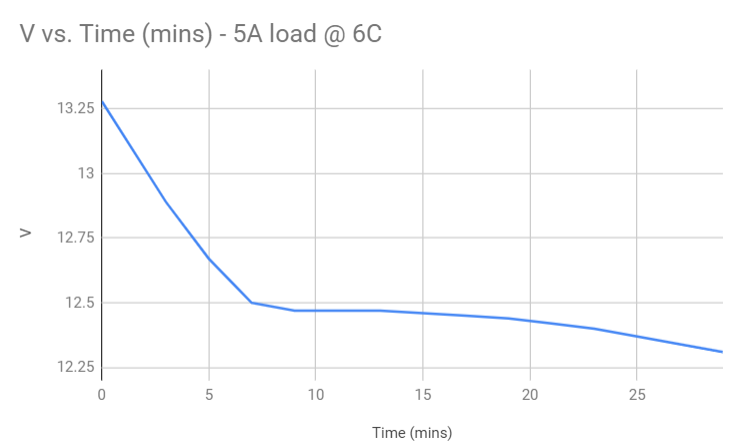

The battery interconnects are new (and clean) and everything else in ~2 years old, and I'd say everything has be tightened. No corrosion or dirty connections. Direct reading of the battery produce the same readings. I did a quick test this morning before going to work, and got the following (similar) results:
The charger was on last night, hence the 13.26 starting voltage. The load was 5A and the temp is 7C. The cool temperature is perhaps drawing the voltage reading down by maybe 0.09v? As my best guess, it seems like I'm down to about 75% after only 30 minutes?
Data:
Time (mins), V
0, 13.28
3, 12.89
5, 12.67
7, 12.5
9, 12.47
11, 12.47
13, 12.47
15, 12.46
17, 12.45
19, 12.44
21, 12.42
23, 12.4
25, 12.37
27, 12.34
29, 12.31
Chris
