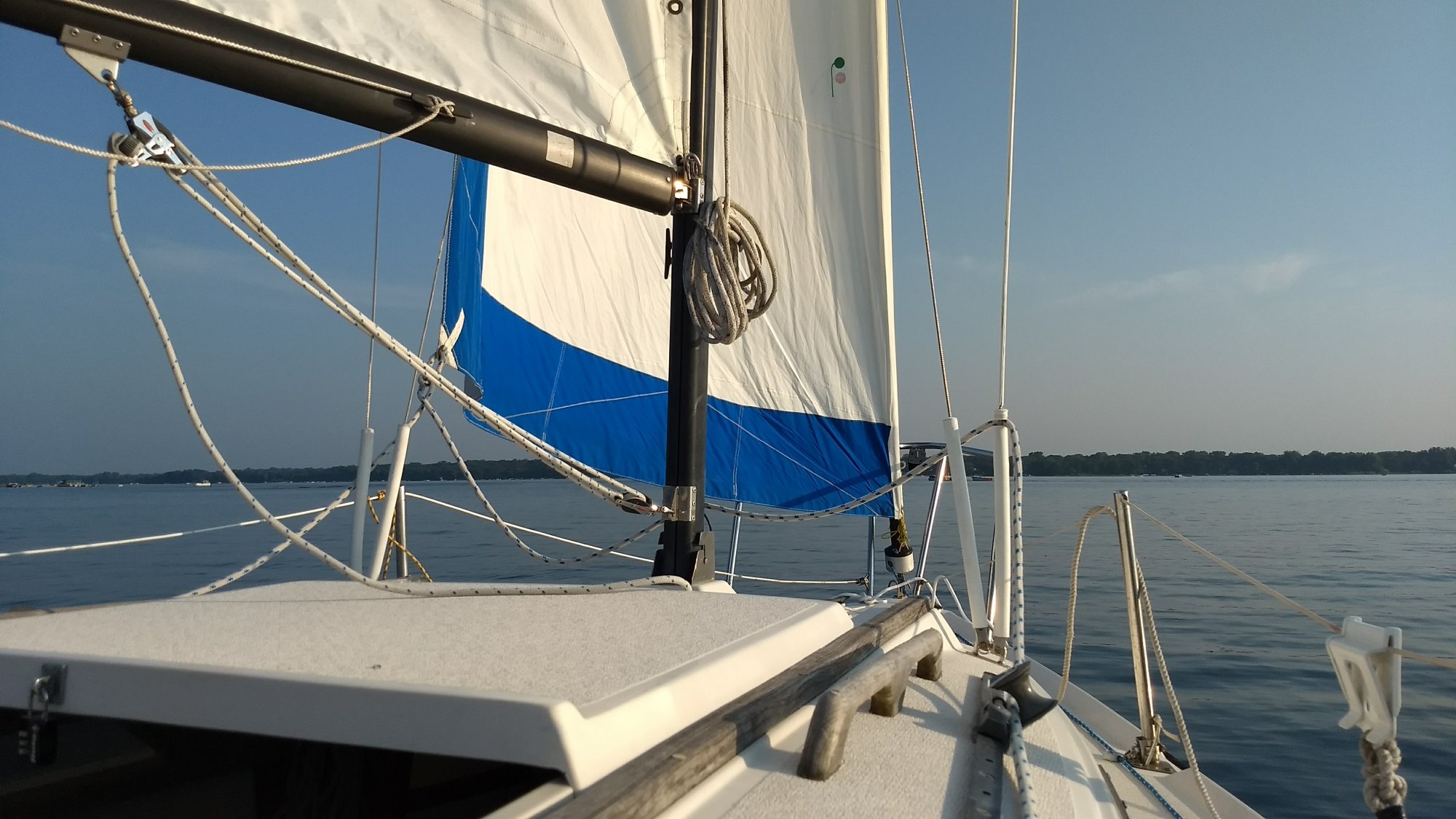

Hello folks. We have a newly aquired P21 sailing on inland lakes in Saskatchewan, Canada. She sails well in winds 6 knots plus, and when the winds drop off, the main and 100% RF jib can't supply enough power to make decent headway. I'd like to know what P21 owners have had good experience with larger foresails. Genoa or Spinnaker? Thanks! Al

The boat has a CDI 'FF2' headsail furler at the moment. It appears the original owner may have modified the original jib to use with the furler. I've got a partial photo of it if that helps.
In such light winds as shown I. Your picture, a larger Genoa that’s strong enough to furl down to a 100% will be too heavy to fly without constantly collapsing, especially with the extra weight of a UV cover on it.
For winds less than 4-5 mph, you’d need to use 1-2 oz cloth nylon or polyester or laminate sailcloth, which isn’t strong enough to use in the same speed winded that you’d use for a jib.
