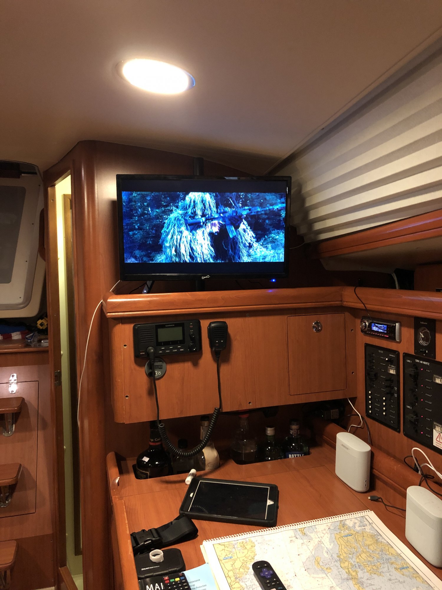

I installed a 12v 24” LCD tv into my 2009 Hunter 36. It was really a project for my wife, but I’ve found it nice to have aboard. I don’t use it frequently, but it’s great to watch movies at anchor when it’s pouring outside. I think it cost me $250 off Amazon. I plug it in only when I use it, so no parasitic draw, and I use its 12v plug to connect to a 12v receptacle nearby. I stream video on my iPad or iPhone and plug it directly into the TV, and plug the TV’s audio out into my boat’s stereo receiver to use the onboard speakers in the salon. Saved a bunch of wiring! Ignore the temp white cord on the left side of the TV. All the wiring is under the tv hidden by the shelf fiddle and only pulled out when I watch TV. It’s firmly bolted down to the top of the shelf and tilts and pans. The power draw of the LCD tv is so low as to be negligible when being used. It’s less than my overhead lighting.
